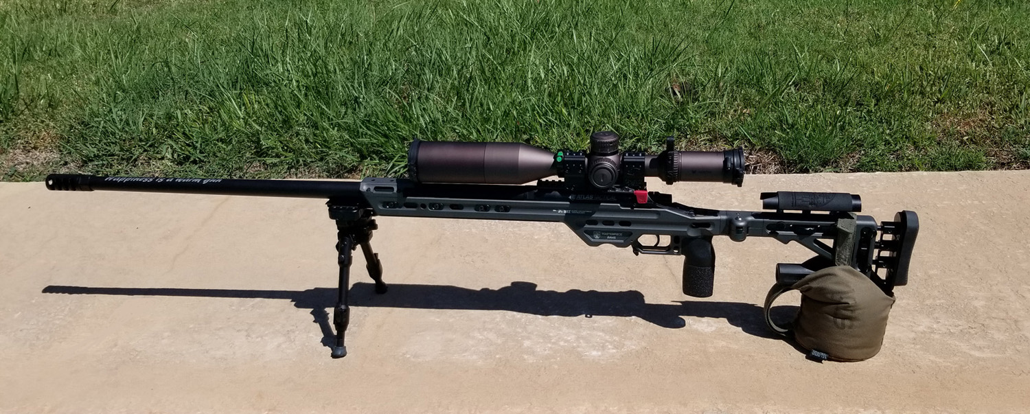

Throwing in a couple of pennies. Been running Kelbly's Atlas 338 in 300 NM since early 2021. I also have three other atlas tacticals in various flavors. All of them great, smooth performers. Customer service is excellent. Highly recommended.
The one thing wonky about the Atlas 338 action is the bolt stop. It needs a T10 (Torx) to unscrew the bolt stop in order to take out the bolt. I made a little sling out of heat shrink tubing to attach a Torx key. Works ok, but looks goofy. It's the red tab in the attached picture. This is purely a range gun to shoot out to 2000k (well used to be able to anyway).

Tried to edit my post #13 to include the following, but will just add this post as an edit to the second paragraph. In that post I stated, "The one thing wonky about the Atlas 338 action is the bolt stop. It needs a T10 (Torx) to unscrew the bolt stop in order to take out the bolt." Well to my surprise, Ian Kelbly PM'd me and said they had come out with a pivoting bolt stop to replace the fixed one, and offered to send it - at no cost. To me, this is what constitutes great customer service. And definitely did not need Kelbly's to reach out with the offer to convince me of their commitment to quality.
