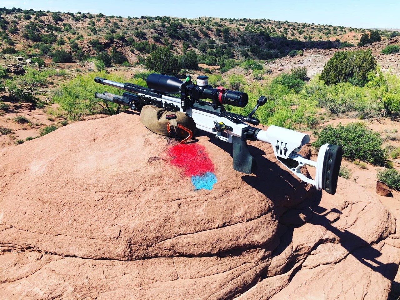

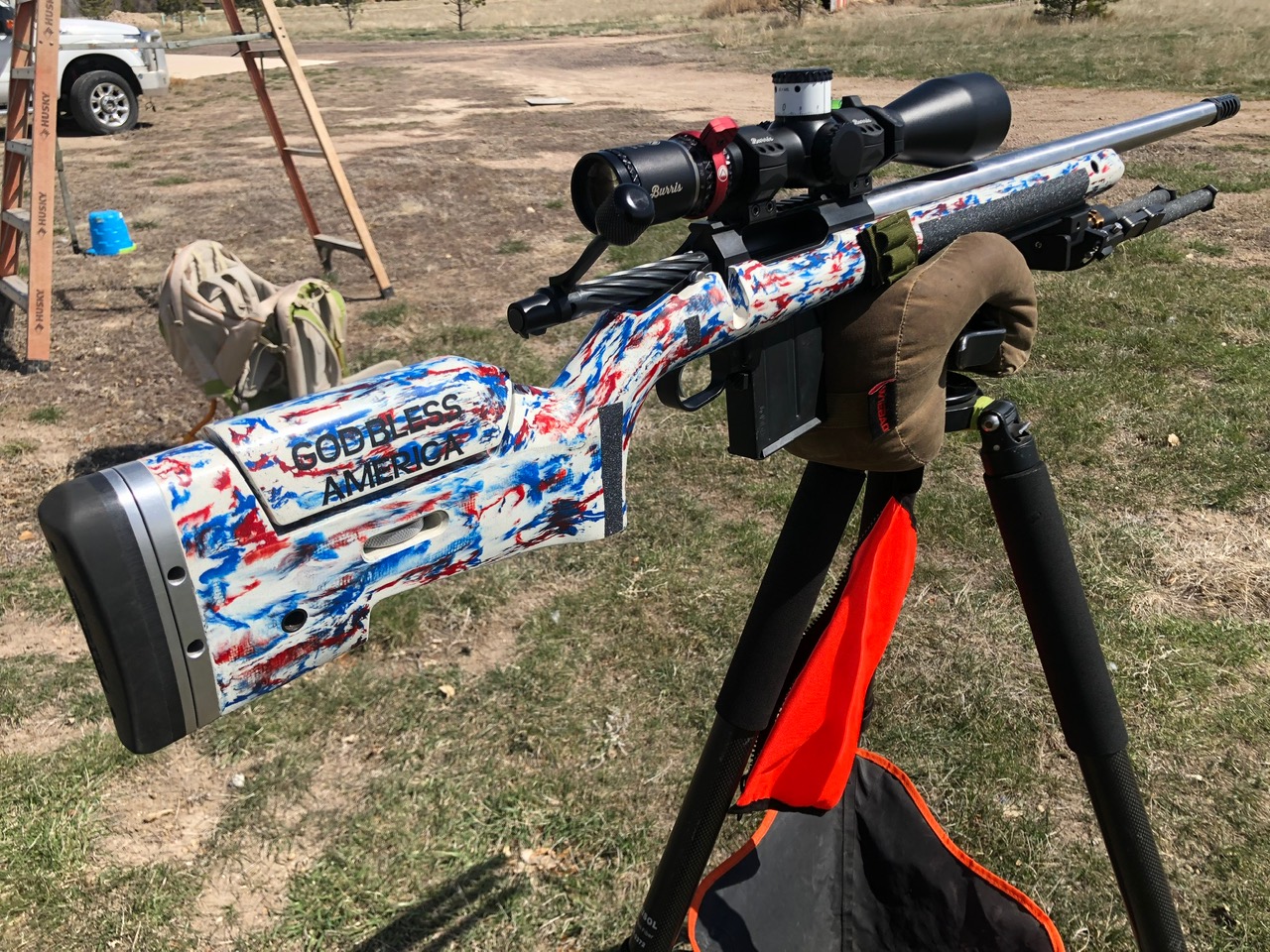

Recently put this together. Bartlien barrel chambered in 6BRA by Jonathon Elrod. Action is butter smooth, XLR chassis fits perfect.
Been messing around with this LR stuff for several years. Dealt with many manufacturers. Kelbly's customer is service is at the top of the list!
Great match this weekend. Was lucky to pull off a 2nd place. Was first rolling into the last stage up by 2 shots over dude that won. Went up and missed first 3 shots on a skylined targets. Darn it darn it lol. He cleaned the stage. Still happy. Elevation was flat right on and during sight in I thought I missed the target a couple times as my shot went inside my previous shot. This bad boy is flat shooting.
MAN this action is crazy smooth. Literally had to check a couple times to make sure a round fed into chamber. I have or have owned all actions except for an Impact, and this guy is noticeably by far the smoothest Ive ran.
The only down side is the flat base of the action I cant swap into other stocks BUT XLR makes a chassi that is inletted for it. I hope other companies start to do the same. Will be a big selling pt but I guess I cant complain my Kelblys bedded KTS stock had no problems with accuracy dept.
SPECS
- Blackbear Action
- Krieger barrel 26"
- VV N140 30.0 grains
- 105 bergers going 2800
- Kelbly KTS stock
- Burris XTR3 with race dial (very very useful)
- SCR2 retc

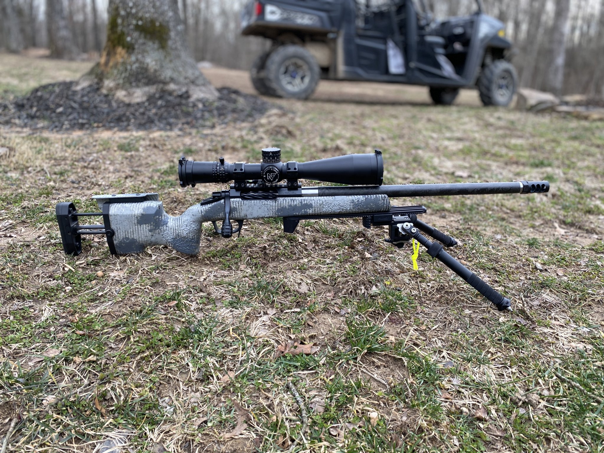

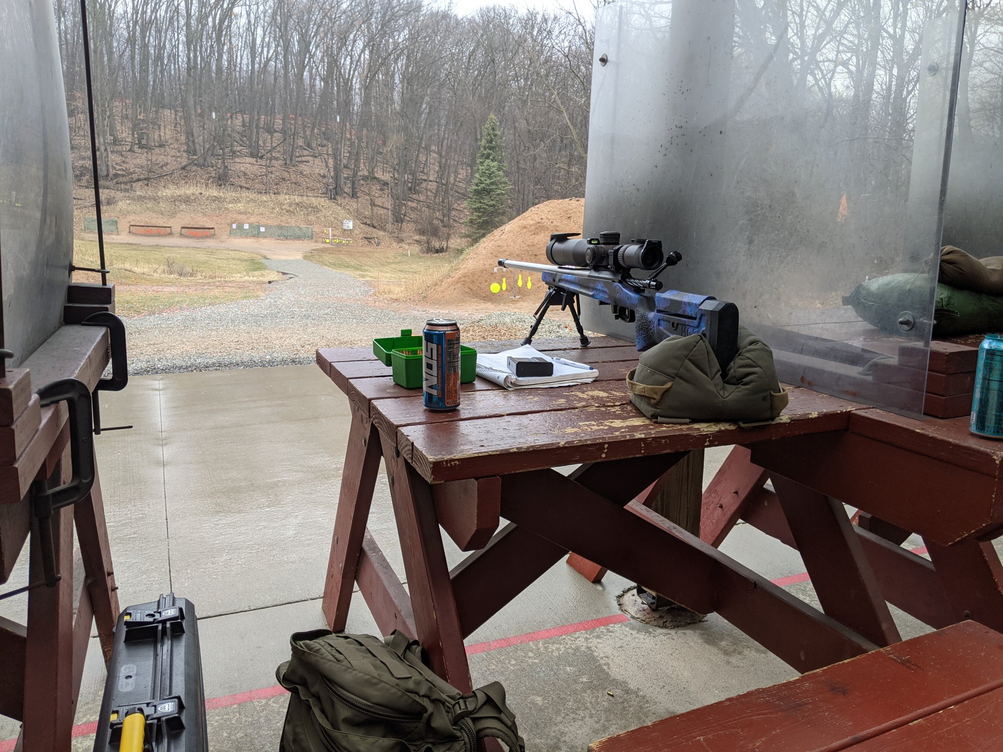

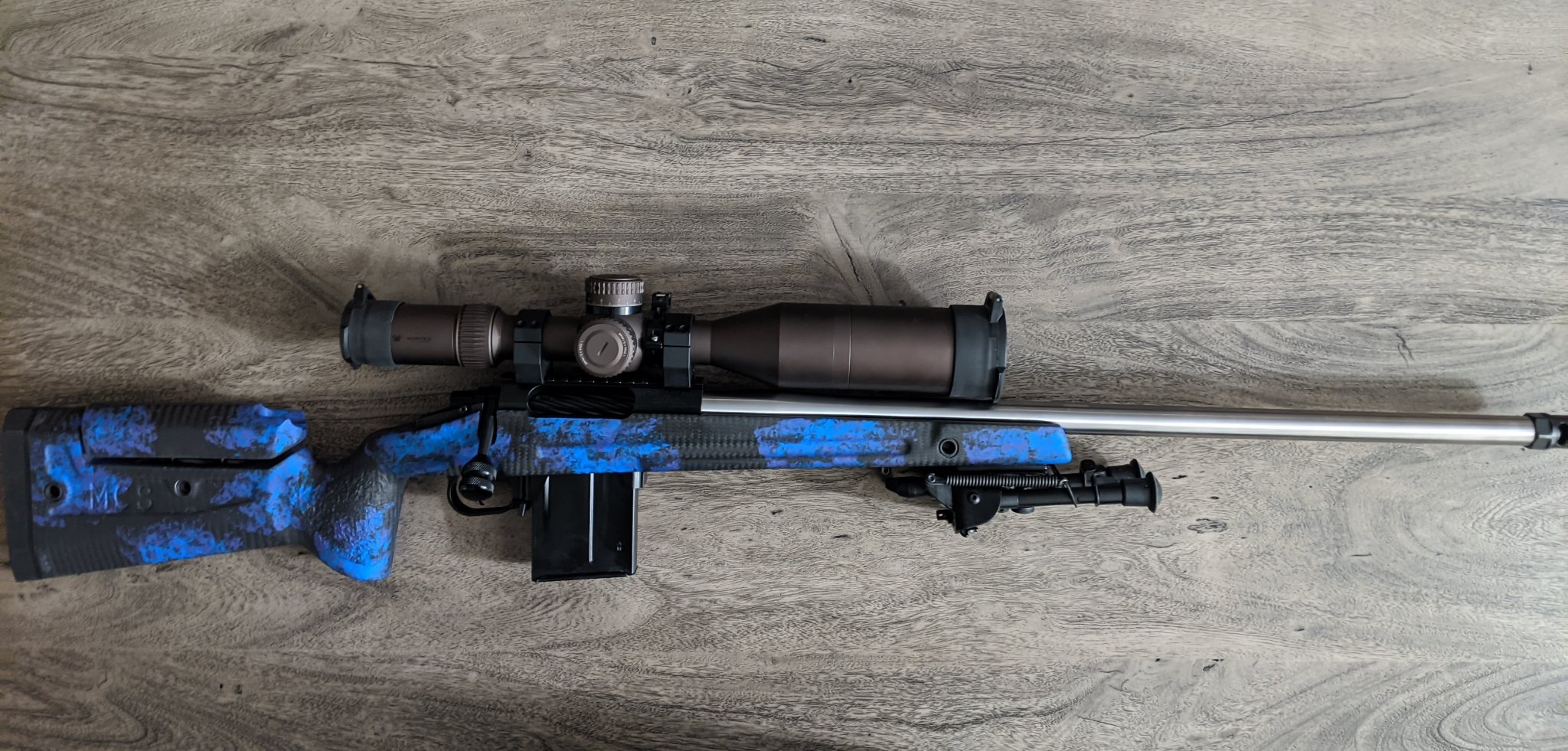

It's done. It's finally done. 2 years in the making.
Manners PRS2 Elite Black & Blue
Bartlein 26" Marksman Contour
6.5x47
Hawkins bottom metal
Lil bastard gen 2 brake
Huber trigger
Razor gen 2 scope
Vortex precision rings
Harris bipod
Can't wait to get to the range!
Sick build man, best of luck with it. How do you like that Marksman contour and balance with that setup? About to order one myself for a 223.
Reactions: Fishbaum
Thank you! As it sits in the picture, it balances about 1" in front of the recoil lug. It feels really good. I think that will work favorably for stabilizing while shooting off barricades while also not being uncomfortable while shooting off hand.
Reactions: Brazo

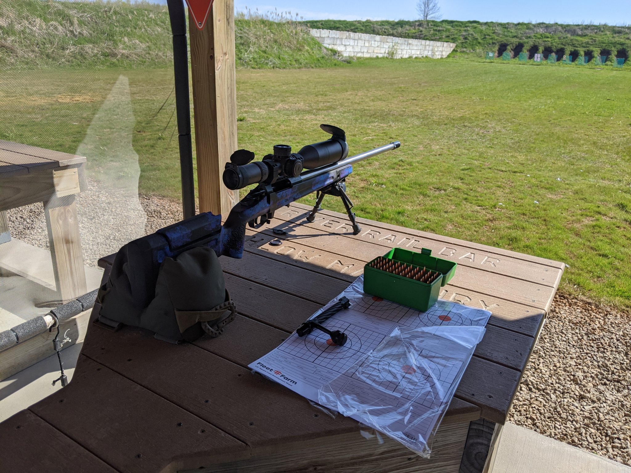

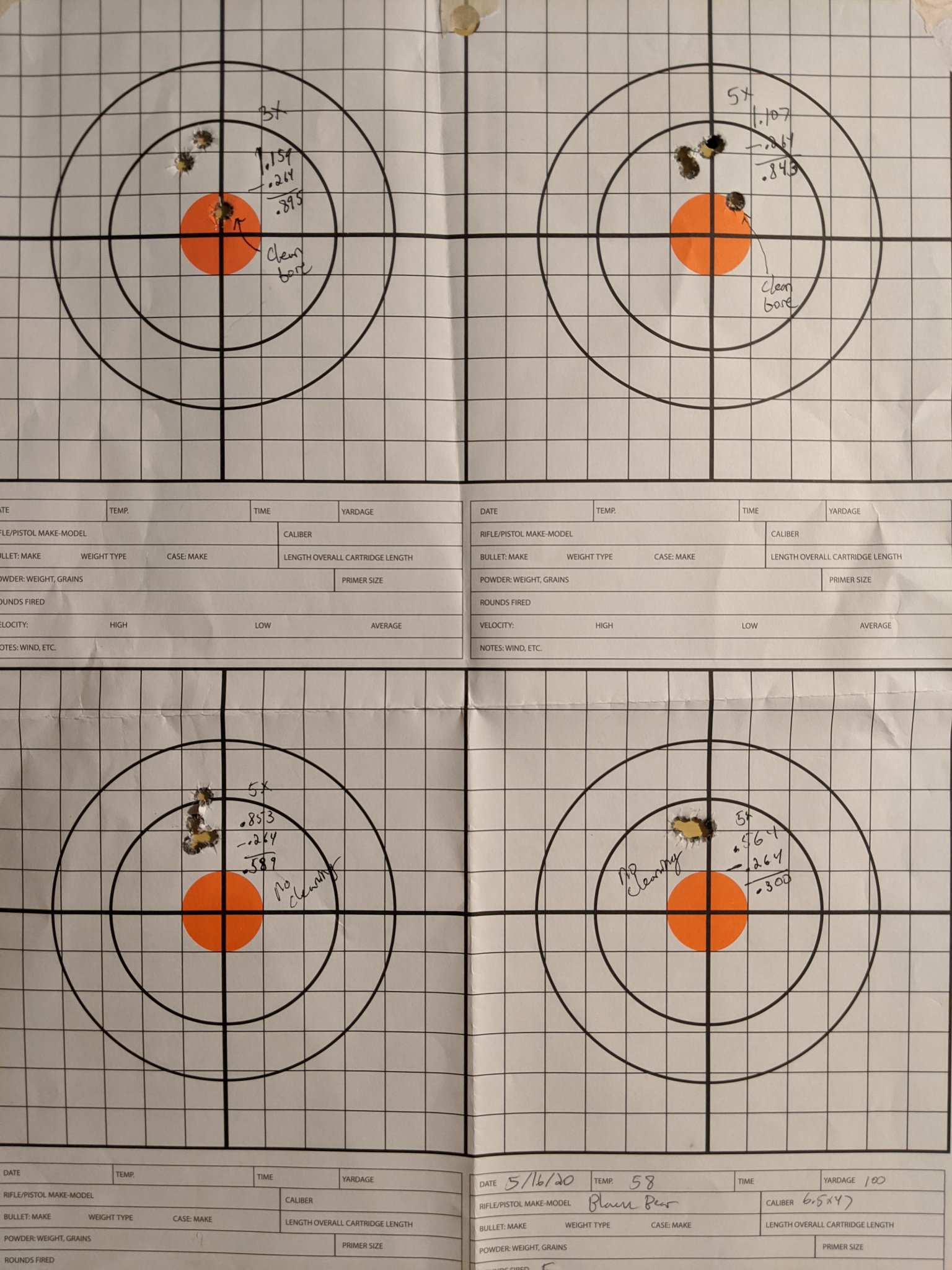

First range outing was yesterday and I am impressed. The pic attached shows rounds 3 - 20 out of the rifle. Top left group is the first 3 after adjusting the scope to be on paper. Keep in mind, the top groups had a freshly cleaned bore before starting. Also, was dealing with a 10mph headwind that was blowing the target around because the target was attached to netting. I moved the target to an area closer to the frame after the top left group was fired to prevent as much movement.
You can see a trend where the first shot after cleaning was separate from a much tighter cluster after. After the top 2 groups, I decided to stop cleaning as I did not see any excess copper or anything alarming on my cleaning patches. The bottom groups are what happened after I decided to stop cleaning. You can see how the groups really began to settle in. The bottom right group is among the best groups I have ever shot coming in at right around .3''. Had I not been so giddy watching this group happen in my scope, it probably would have been tighter. I consider this barrel broken in.
After this, I stopped shooting groups at 100 and started shooting steel at 568 yards repeatedly nailing a 3'' target. Had a blast. All shooting was done with Lapua factory 123gr 6.5x47 ammo which was superb and it should be for being $3 a round shipped.
Overall, I am in love and the build was definitely worth the wait. Thank you everyone at Kelbly's for delivering an amazing build.

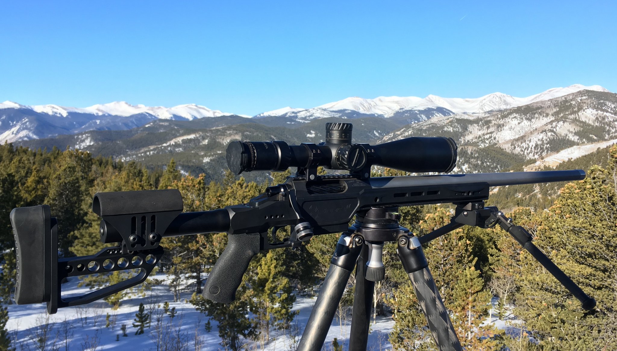

Finally got this thing built and even longer to get it broken in.
Did a 6 day, PR1 & PR2 class, at Blue steel Ranch. I have never gotten so confident so quickly with a weapon system before and it has reawakened my drive to have fun train hard and shoot shit!!!
Kelbly Black Bear
Kelbly “The Klaw” muzzle break
Kreiger 24” 1-10twt, .308, Heavy Palma
Manners T4
Steiner T5xi w/ SCR in Suphr 4601 mount
TBAC Bipod
MDT mags
Federal Premium Gold Medal 175 smk
Pushing 2670fps
Gotta say I’m super happy I went with a custom build and super proud I made a good choice with going the Black Bear route.
mall work was done at Kelbly’s and would not hesitate to have them spin something up again for me.
Watch out comp matches, this beast is hungry!!

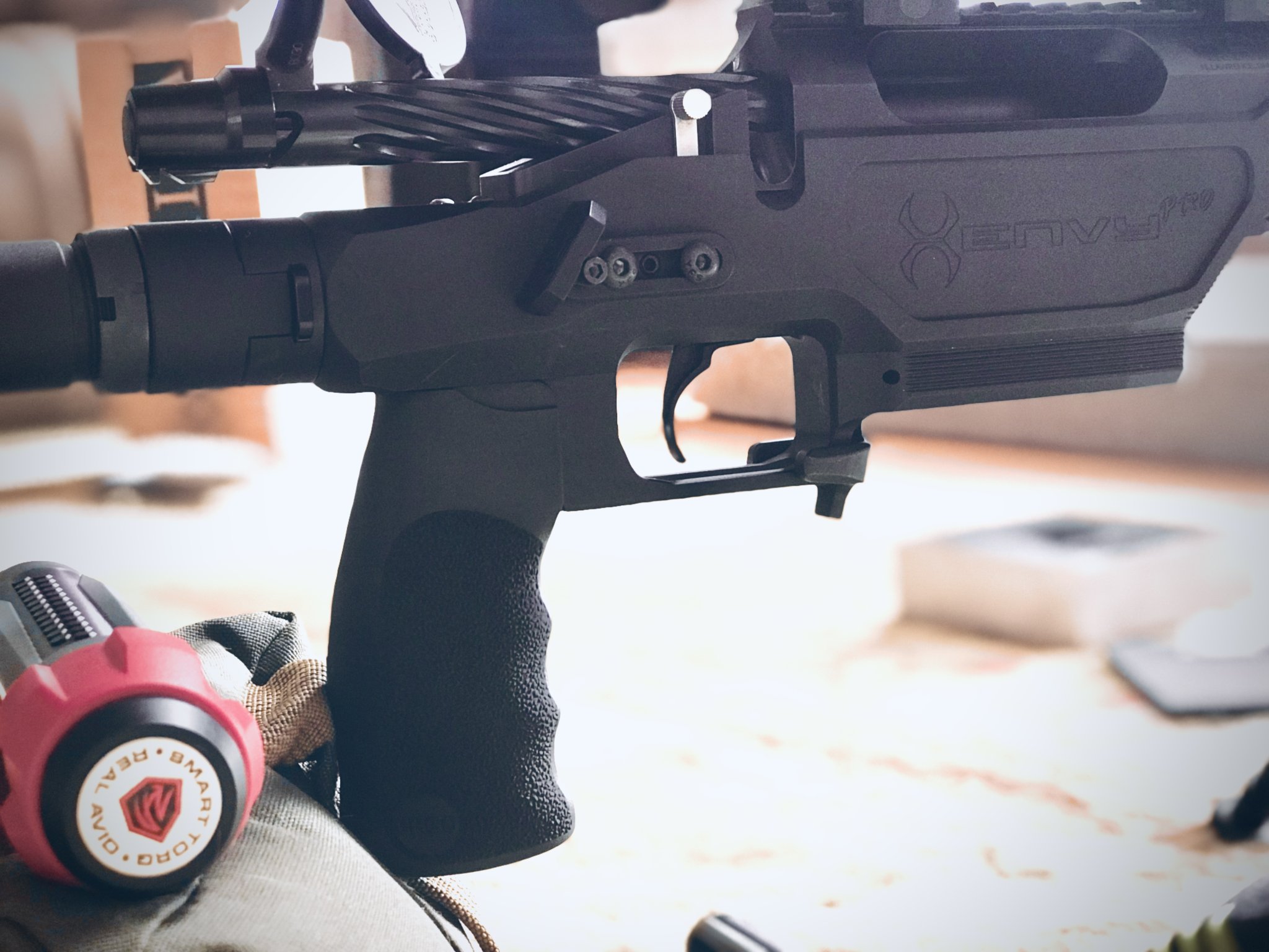

Whats going on?!?!?!
Hitting this thread back to life with good news for my BB. Even though I just got things situated in April I decided to upgrade and be more aggressive in making my local PRS series matches. Going to stick with my Tac Class (.308) and get more confiedent and comfortable with matches. Who knows I may even hit up a major match or two as well...
Thanks to @Ian A. Kelbly for hooking me up with a un-allocated XLR chassis package.
And kudos to the BUY-SELL Thread for helping me gather the other ingredients for my build.
It may be a a Frankenstein semi-custom build but I'm already enjoying it.

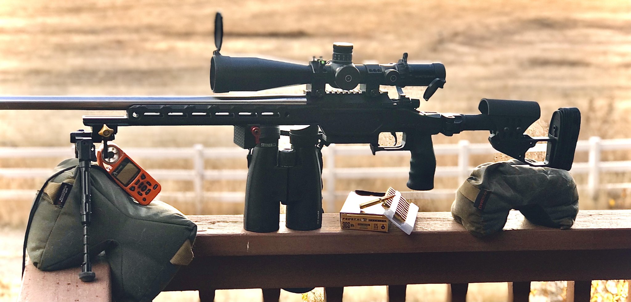

so update on the beauty, I went back and forth about doing a video for the build, but I didn’t feel I had an adequate area to film, this was my first disassemble of a rifle and got stuck between nervous and excited, and finally too F’N giddy when everything showed up at the same time and before a club intro train up day.
Never the less here’s a pic I could resist sharing. Thanks to everyone for the knowledge in this thread!!
