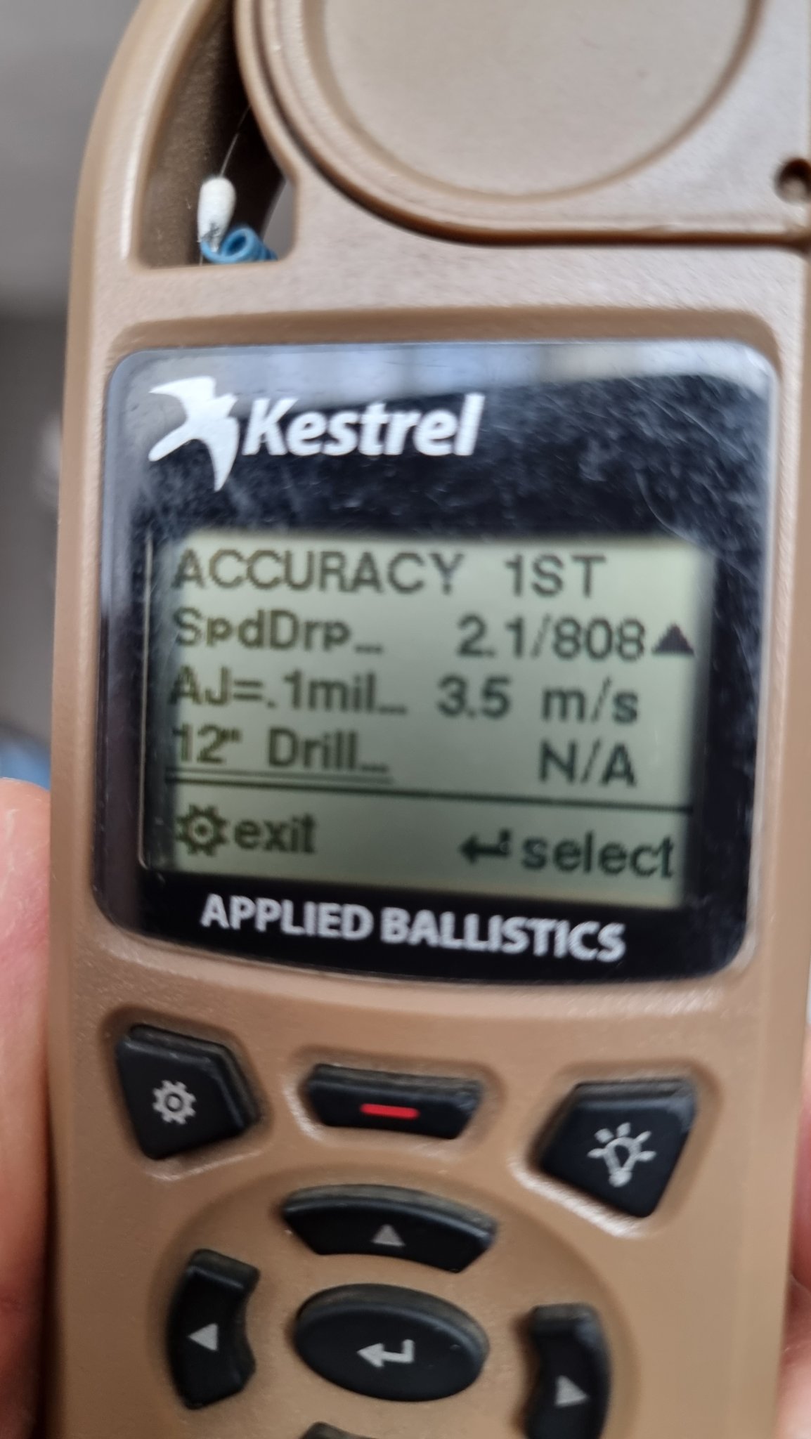

I just updated to 1.48.
My 12" number is N/A in accuracy first page.
Environment is locked and elevatio is in mils.
Does anyone have this problem? How can I solve this?
The parameters of the 12" drill were refined with FW 1.48. The 0.7 was added to imply that there requires a rule change to the standard 12” drill to maintain accuracy inside of 0.3 mils. This way the Kestrel cannot give you a value to use that exceeds an error of 0.3. If you know the rules of 12” drill then you can still click View Table and use this tool. For further questions we recommend reaching out to Accuracy 1st directly
