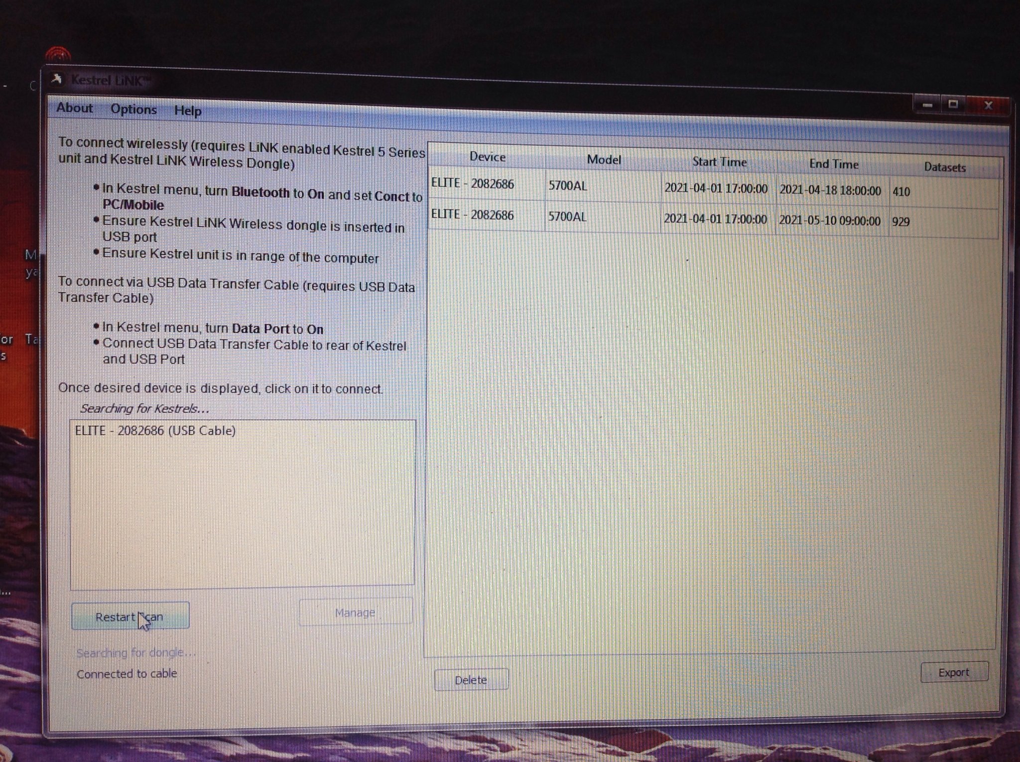

I downloaded my Kestrel to the log prior to updating the firmware figuring Id lose all my gun profiles.
and I lost all my gun profiles.
How do I download my data back into the Kestrel now.
I probably screwed up.
I saved everything here....
Guessing that is not where I wanted to do it?
I am using cable not the Donger.
Make sure your kestrel is ON and close to the computer Select your Kestrel unit from above. Then click on "Manage"... and mine automatically started the update with a bar showing the progress and when it was complete it even re-booted my Kestrel 5700
Mine updated fine but i lost all my data as expected.
Before downloading the update I downloaded everything to my Log.
I assumed that after doing the update I could just export all my previous data from the log back into the Ketsrel.
Doesnt seem to work that way.
Unfortunately the log is for storing weather data, and not rifle profiles.
Live and learn. Already put rifles back in Kestrel - easy.

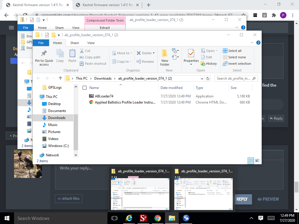

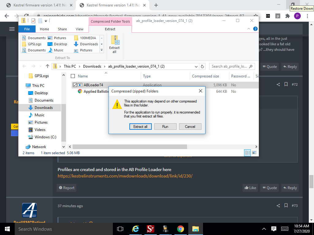

Concerning App when I try to open I get this screen...
Have tried extract, have tried run....even read PDF on directions and not getting the app to run.
Any help for the non tech guy?
When I hit extract a copy of the first screen shows up and down below when I click on open folders it shows me two screens...
Weird.
What do you expect from this guy?
and I only shoot .22, 5.56, .308 and 30-06.
You need a version that runs on coal.
Disregard.
Hit it again, than again and it gave me a choice of three devices (in pictures for us simple folk) than when I clicked on the K5700
BANG!
It opened.
