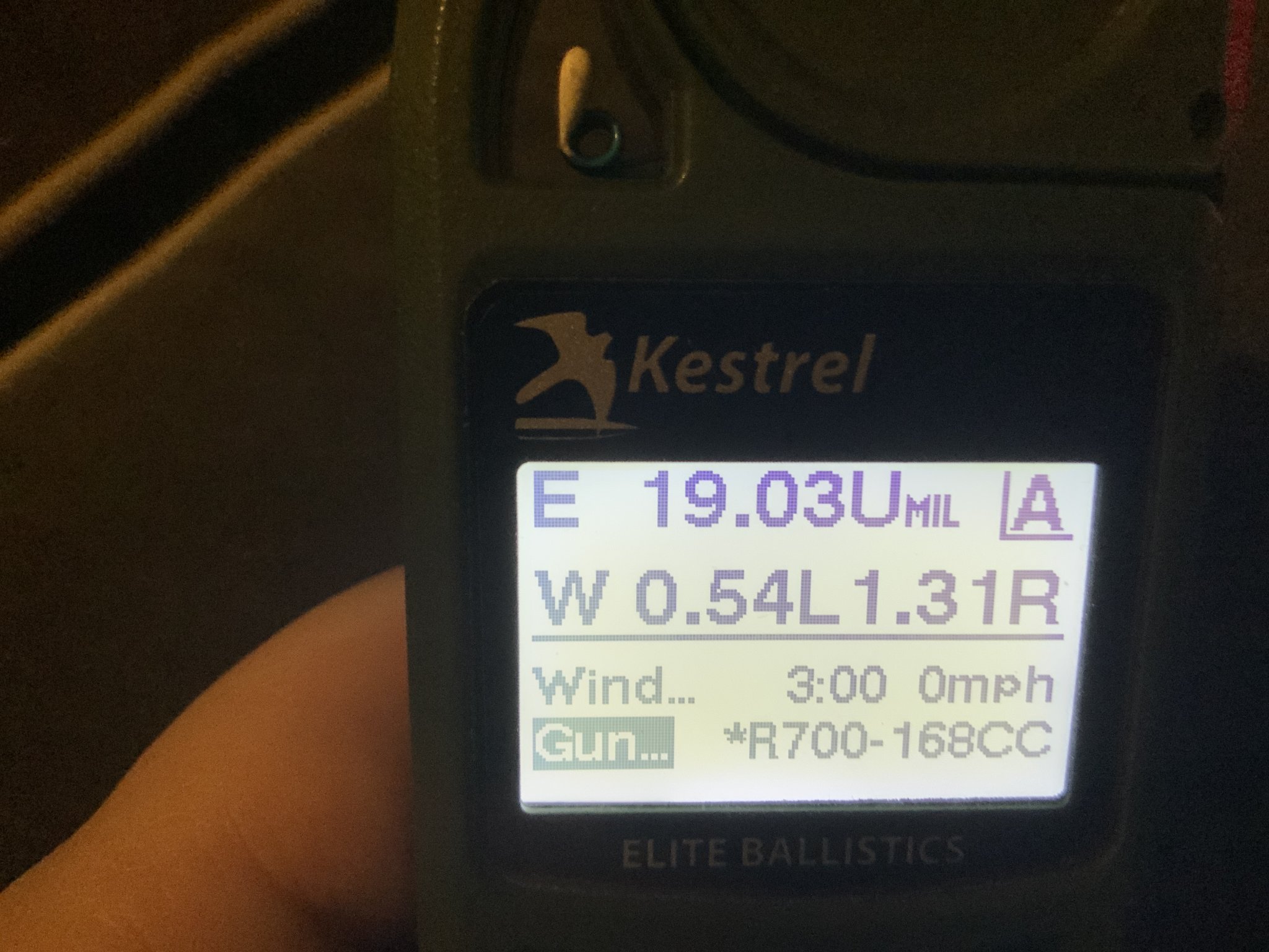

Just got set up with the AB Loader and Analytics on a windows computer. When transferring profiles to AB Loader and then back to the Kestrel they now have a ‘*’ in front of the name.
I’ve got all my profiles on the AB Loader now, moving away from the Link App... so far it’s been a little weird as it switched one profile to inches from Mils. I Deleted it from the device, checked it was correct on AB Loader’s profile and it still happened a handful of times. Transferred some other profiles and left them on the device, deleted the problem profile and it reloaded fine...
So what’s the deal with ‘*’ showing up in the profile now?

On page 6 post #297 its referring to the target line the * appears. This is appearing before my profile name:

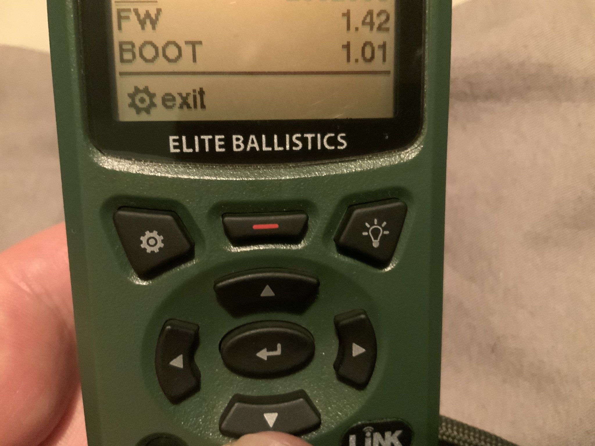

Supposedly this was removed in the 1.41 firmware:
If you are on 1.42 perhaps some old code made it back in to this release.
I thought that * was indicitive that specific profile was using the custom curve instead of the G1/G7 bullet profile.
now you got me wondering lol
Definitely not the custom curve indication. BC turns to 1.000 as you know. I’ve got other profiles not using custom curves and they are all showing the * now. I can’t “Reinstall“ the firmware as its the current version. Tried a reset to factory settings and a soft reset as recommended above... nothing worked.
Here is the 1.41 firmware. You shouldn't be using executables from random people, but can't find a direct link on Kestrel's site so here we are if you can't wait for their rep to respond.
  • kestrelfirmwareinstaller_141.zip
