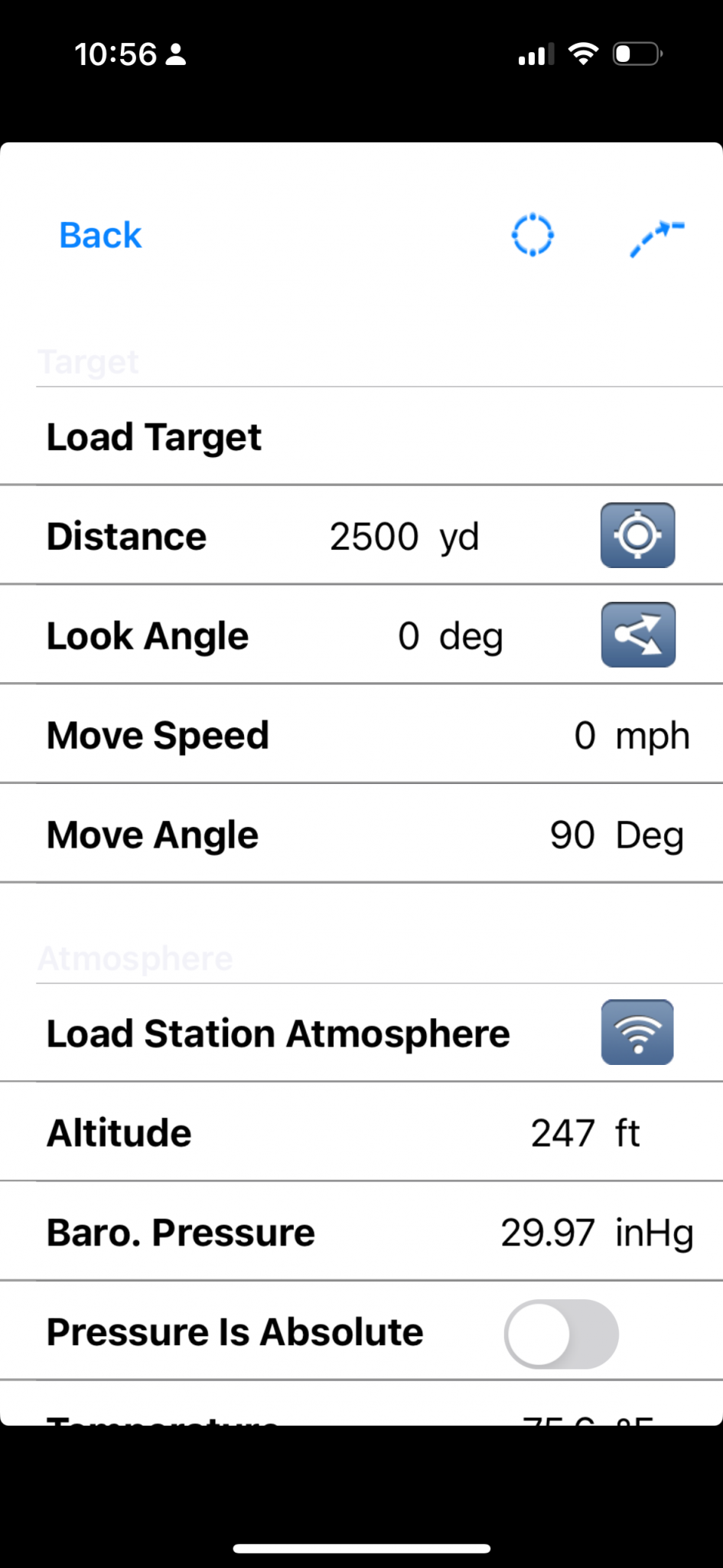

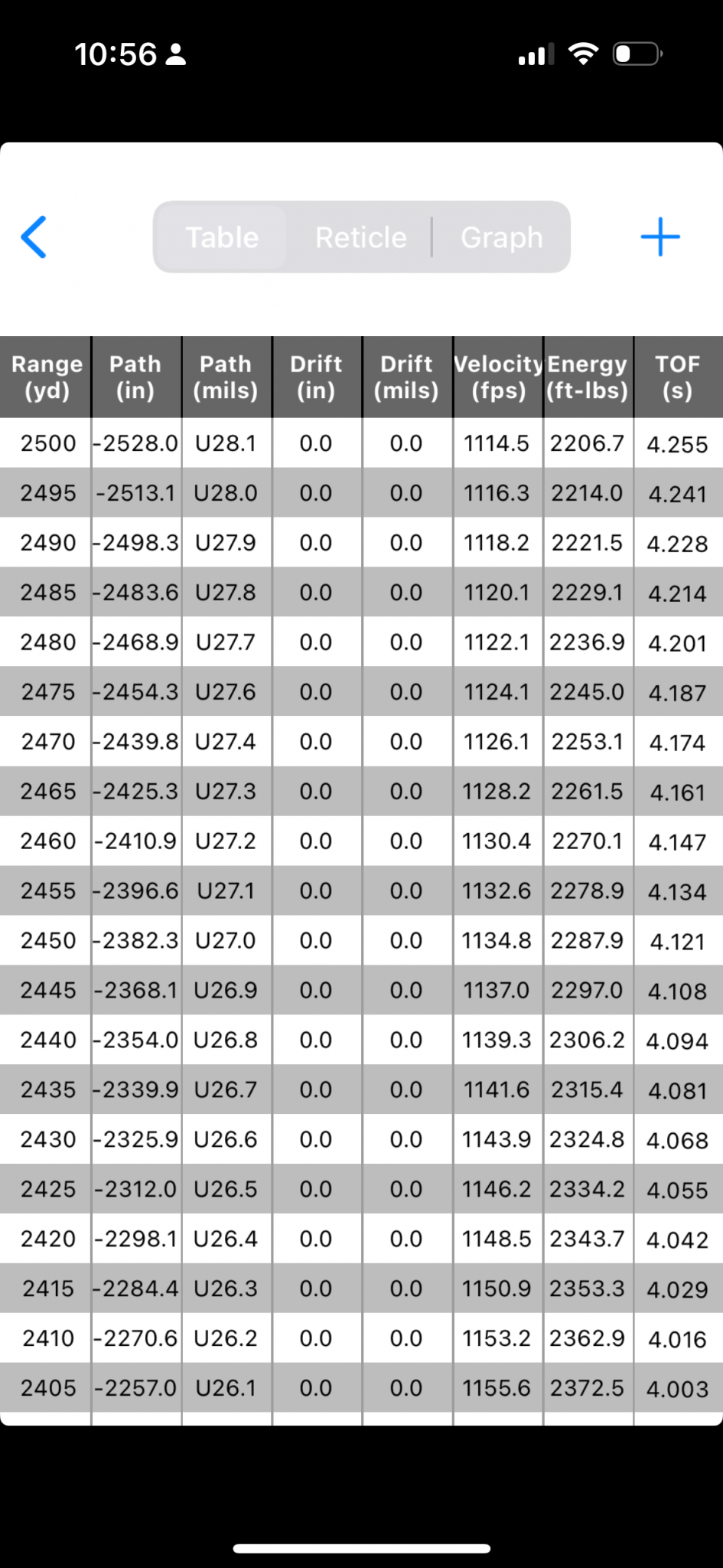

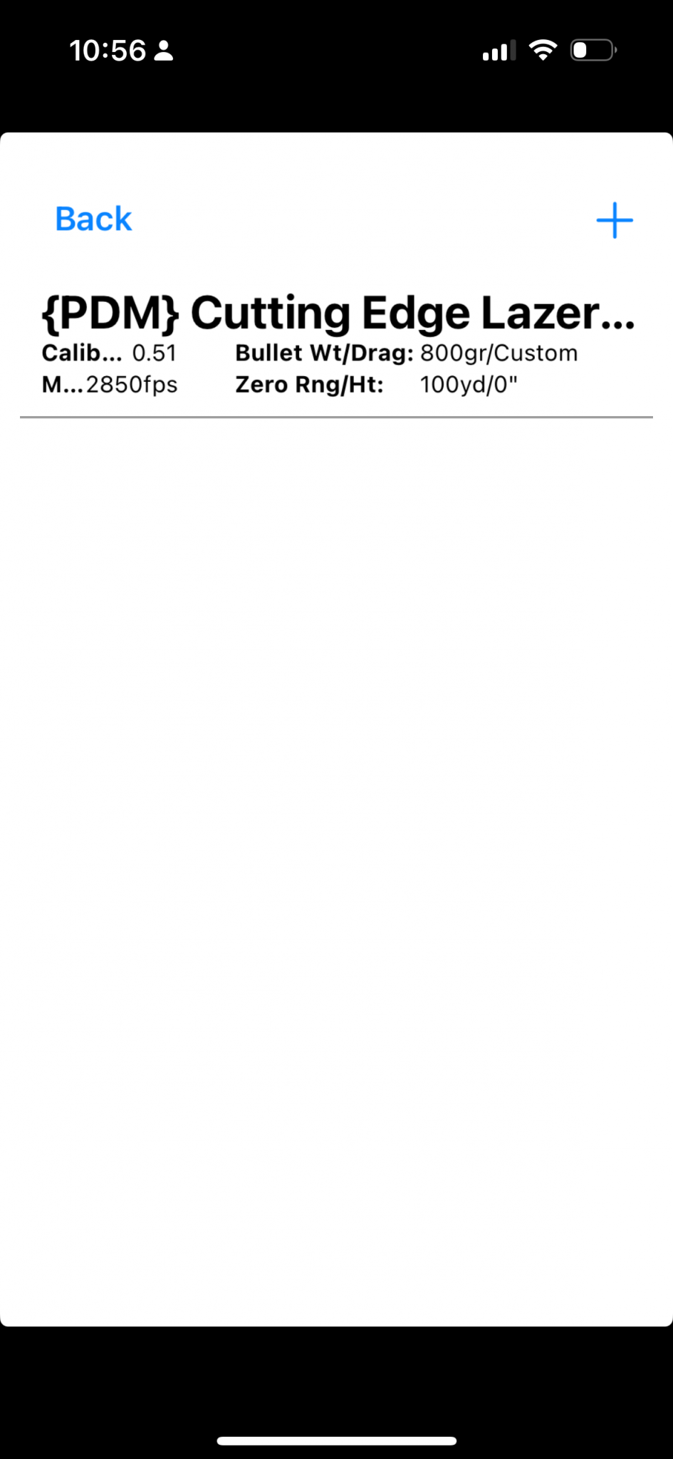

800 Grain Gen 2 Lazer:
1000 Yards = 6.5 Mils
2000 Yards = 18.7 Mils
2500 Yards = 28.1 Mils
That calculation is here at essentially sea level with pretty modest velocities achievable in a 32" barrel. 50 is a caliber that there is an existing supply chain and active weapons systems for.

Hornady Amax is also an approved projectile.
My calculation was done at 2850 which is entirely doable in a 32 inch barrel.
