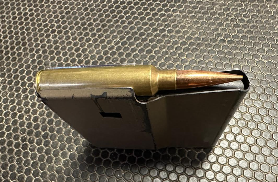

All this and the fact that you can't magazine feed with the XC from the Lapua Magnum sized magazines puts you into a Cheytac sized action anyways. I've been thinking the LMAI with a 30" barrel would make it hard to justify the 33XC.
I had a few 338 LM AI before switching to 33xc. 33xc is the easy button but comes at the cost of barrel life.
338 LM AI w modified mags if you want to mag feed…
33XC if you don’t mind running a SS!
