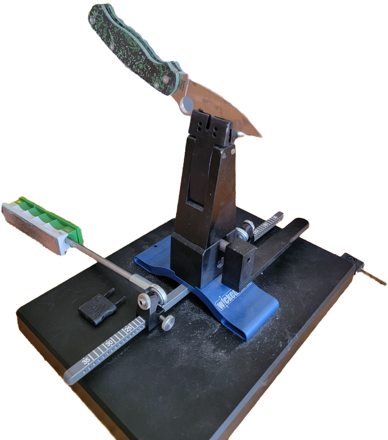

For completeness sake I have a Wicked Edge (the expensive model), a Edge Pro with Diamond Stones and Shapton Glass stones in 500, 2k, and 6k grits, stacks of Japanese water stones--some soaking and others non, a full set of DMT diamond stones, multiple sets of triangle sharpeners (Spyderco and others), the regular Worksharp Sharpener, and a box full of other stuff dating back nearly 60 years.
Wicked Edge is cool and leaves an unbelievable edge, but it does take some time to setup. I can easily take a small kitchen knife and completely sharpen it by hand on a 10" red/blue DMT before I could get the knife set up correctly in the Wicked Edge. It takes a fair amount of finessing to get it set correctly, including using an angle cube to set each side perfectly down to the 0.5º.
The Wicked Edge is also the most limited knife sharpener I own. The knives that fit, work great, but many don't fit including something as simple as a Spyderco PM2. Kitchen knives seem to fit pretty well though. However, it takes dozens of sharpenings to get the diamond stones broken in. The first knives you do will not be sharp--the owner also makes this very clear in his YT vids, and also in the owner's manual, I can also confirm this to be true. It took me a long time to get a sharp knife from this system. I've also spent upwards of $2000 on it over the years. I originally spent $350, thinking that was absurd for a sharpener, and it really took hundreds more to get it acceptable.
That said, I do really like it now.

I use the wicked edge on the PM2 with acceptable results.
Yes 15 deg. Yes point to heel. The plastic Handle can bump the thumb rest at the end of the blade, but that is at the end of the stroke and doesn't seem to hurt anything. I don't have a Spyderco sharpener so no idea.

The edge of the stone's plastic handle bumps up against the heel of the blade, the part that sticks out and creates the cutout for your first finger if gripping-up on the knife's handle, and prevents the diamond from reaching the last portion of the blade. This is something the owner fully admits and so does everyone on the WE forum. It's not really a debatable thing...
The only way I know around this problem is to sand off the plastic guard so the diamond plate creates the edge of the handle, not the plastic. If you are able to sharpen heel to tip with the handles unmodified, you are literally defying the laws of physics and moving hard plastic through steel over and over again. :)
As for reaching 15º. I wasn't able to. When set there, the diamond stones hit the clamp holding the blade. I believe 17º is as close as I could come. And if I wanted to use strops at 1º below my sharpening angle, 18º is the lowest I can go. Whereas with something like the Ken Onion or Edge Pro, I can easily go down below 15º.
Are you measuring your angle with a zeroed-out digital able cube or are you relying on the WE's indicating marks? If the latter, they are rarely accurate and not the actual angle you are sharpening.

Thank you all for contributing to the thread. I know I started it then I didn't follow up like I would have liked to. I got called away for work and it was crazy busy.
Anyway I did make a decision for what I think is best for my situation... Keep in mind I own a ton of 'stones' even various Japanese stones... but for this specific situation doing any kind of 'hand sharpening' won't accomplish my goal-- add to that I am working with generally cheap knives. It's also not a matter of 'knowing how' to sharpen, but rather to find a much faster and acceptable mechanical method.
In general no one else takes care of things like I would like them to. A few years ago I bought a $800 cookware set and within just a short time people were saying 'these are junk pans'. They were NOT junk, but literally everyone would use every type of metal spatula or whatever until the non stick was gouged into oblivion. Nothing is wrong with using cast iron, but if you ask for 'non stick' for Christmas you cannot treat it the same way as cast iron.
I tell that story because it's the exact same thing with knives. When it's time to cook I can't stop and whip out a set of Japanese stones to put an edge on something.
At the end of the day it was down to either a 30 inch mini belt sander or the Razor Sharp Edge System. For speed, accuracy, good results, and to overall have a durable machine I went with the Razor Sharp system and a bench buffer. Grand total I am in it around just shy of $150 total for a system that I can hopefully use for a long time.
I don't know if it's the absolute best out there, but for the cost/benefit/results matrix it seems like it will work for me...for now.
Have a Ken onion. Do not like it for a pocket knife. The grind shape feels off to me when I use it. Also doesn't handle the tips and some backs well. Does work pretty well with a diamond belt for the kyocera ceramic knives we use the most. Grew up using a lansky. Bought one. Really need to sharpen my knife.
