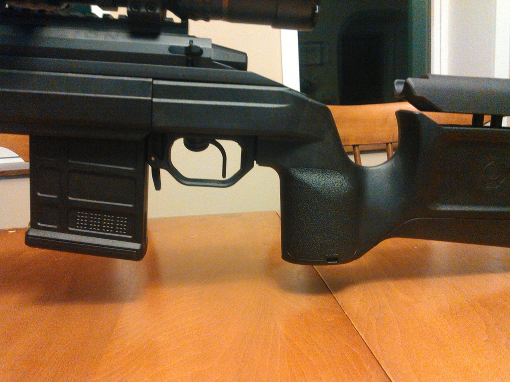

Yep it looks terrible doesn’t it. ? View attachment 6975742
The fit here is a far cry from that of the Bravo pictured in my original post. Thanks for the photo though, as your setup would be exactly as I had envisioned. I wondered about a polished barrel on the Bravo, as well as the fit of the barrel nut. I cannot tell from the photo, but is your action a Howa, or...? Thanks. Phil

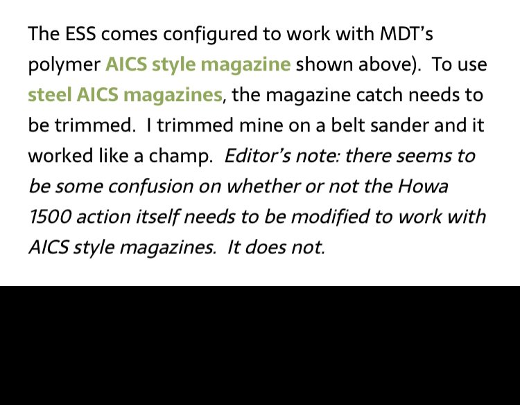

Yes it’s a Howa. To use the Bighorn nut it has to be relieved, not sure about the other nut NSS offers. The channel dimensions are listed on the KRG website.
Do you mean you had to cut away some of the chassis to fit around the nut? How did the Howa action fit? May I ask what barrel and caliber you are using? I am planning on a 6.5 x 47 Lapua.
Yes a small part of the backbone had to be milled. KRG lists a dimension of 1.25” for 4 inches in front of the action. The Bighorn nut measures 1.3 something so it had to be relieved. James from Northland has a different barrel nut which can also be used but I do not know what the OD on that is. KRG lists all the dimensions of the barrel channel on the Bravo web page. The Howa action with factory barrel is a drop in. My barrel is a Criterion 6mm Creedmoor match medium Palma 26” long. I think I might try a heavy Palma on the next barrel. I ran a 6.5x47 Criterion a couple years ago it was a laser I still use it for local matches.
Oh and yes my KRG works with AI, Accurate, MDT steel, and Magpul mags. It won’t work with the ARC mags. I really like the MDT metal 10 and 12 rd mags.
Not only that, Howa actions do not need to have any machining done to the rear of the mag well opening to use any AICS mag in any KRG chassis.

Mdt mags are aics patern mags. You are not stuck with mdt mags any other should work
Please do a little research before posting misinformation. From the MDT website:
“Howa 1500 / Weatherby Vanguard actions
Only our polymer magazines will work in the short action rifles due to the flat bottom. The long action rifles will work with the metal 3.715" magazines without fitting.
For .223 models the bolt stop prevents the bolt from moving back far enough to pick up the rounds. This can easily be modified by removing the bolt stop and trimming the contact face.”

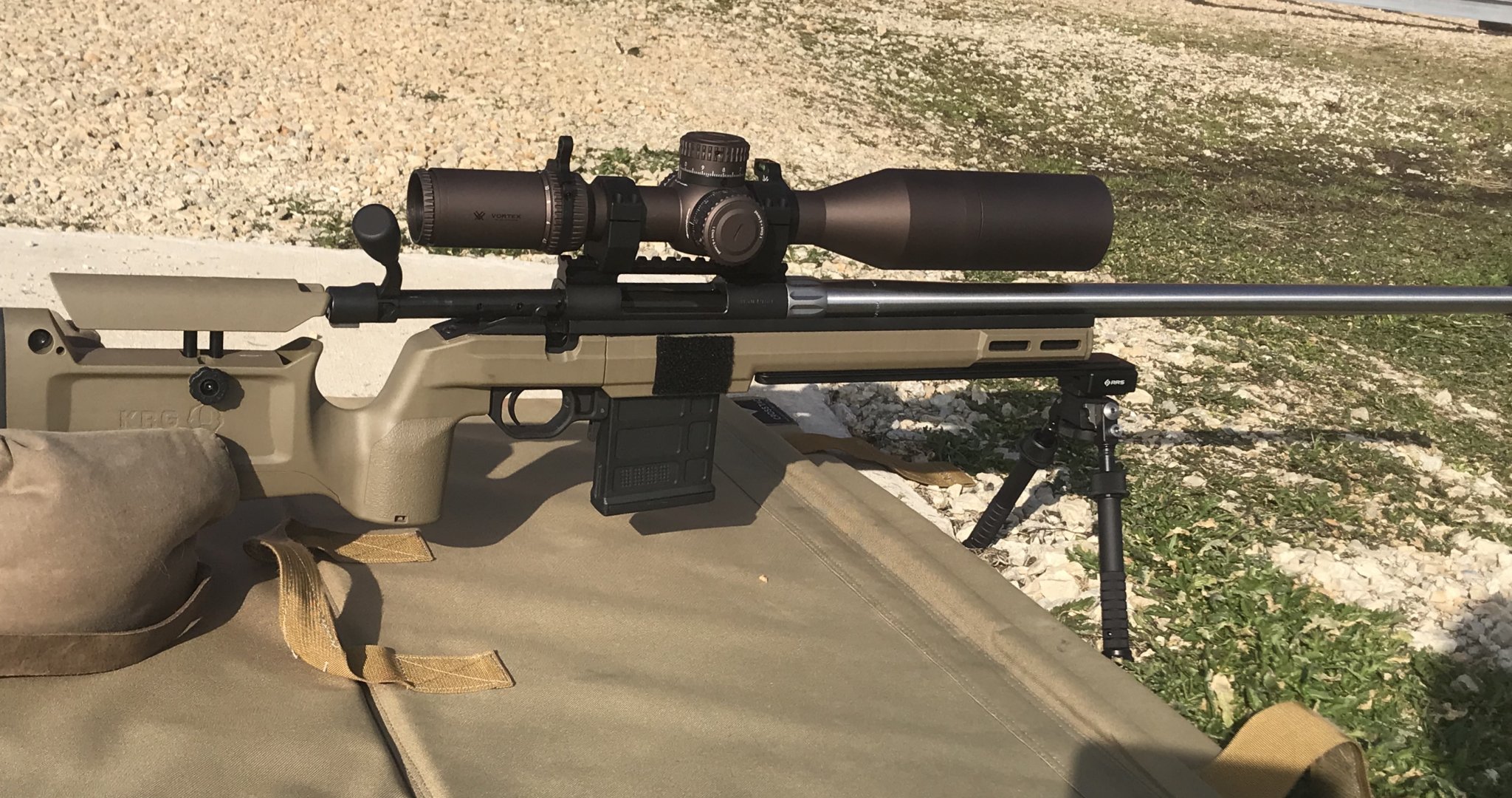

I am the OP. Just thought I would say I have ordered the KRG Bravo in FDE for a Howa action. I quite like the blend of chassis and conventional stock design. I did ask KRG about the fit of the panels. They e-mailed me back and said,
There is some misalignment do to the tolerance allowances in the molded parts. Some of the extreme cases are due to improper installation. Either way, these do not effect the function of the chassis.
Not exactly what I was hoping to hear, but it looks like the panels are screwed to the aluminum backbone. If mine is misaligned and it bugs me enough, I may see what I can do about it.
