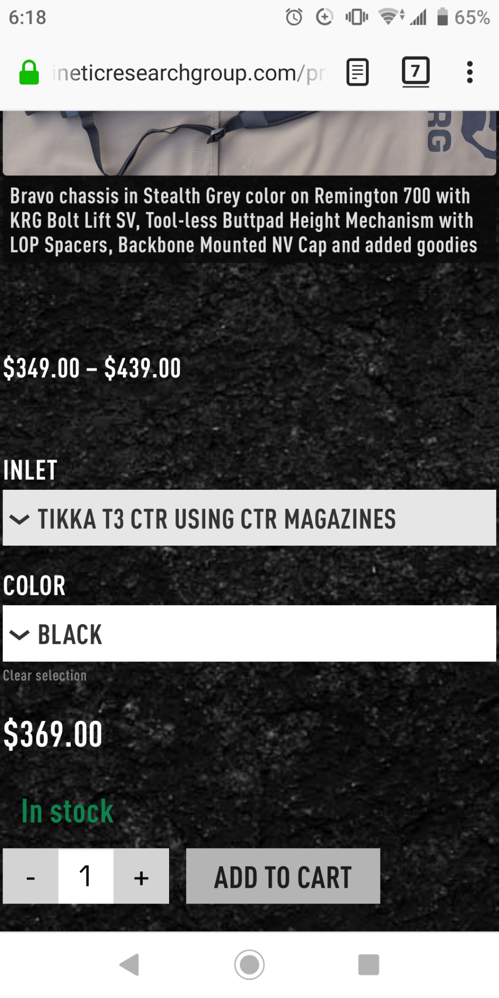

Are they going to be available in all colors?
