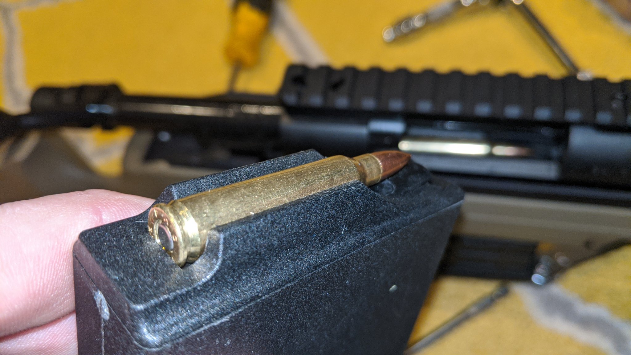

So the barreled action for my son's build came in tonight (the last piece of the puzzle). I wasted no time in putting her together and was dismayed to find out that the MDT 10-round .223 mags I purchased aren't remotely close to working. They are so far out (and identical to one another), that I wonder if there's something else amiss here.

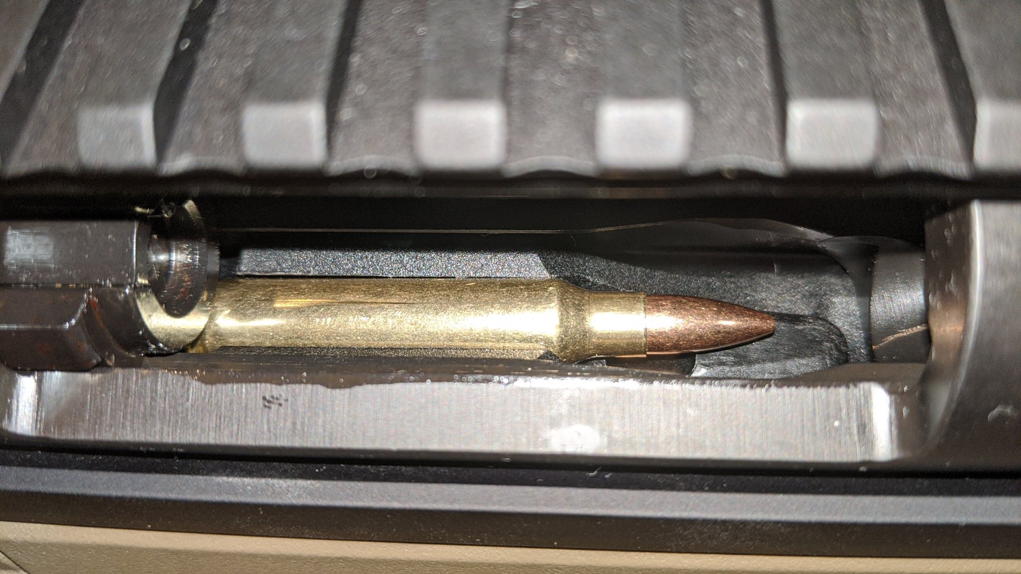

The problem is that when the bolt is fully open, it doesn't come back far enough to come completely over the next round. It's sitting on top of the round (see picture). I've looked for obstructions inside the action, I've taken the chassis apart multiple times to see if I'm missing something. I've tried "adjusting" the chassis as per step 7 in the KRG instructions (there is little to no real adjustment possible though, surely not enough for this).
Any ideas?

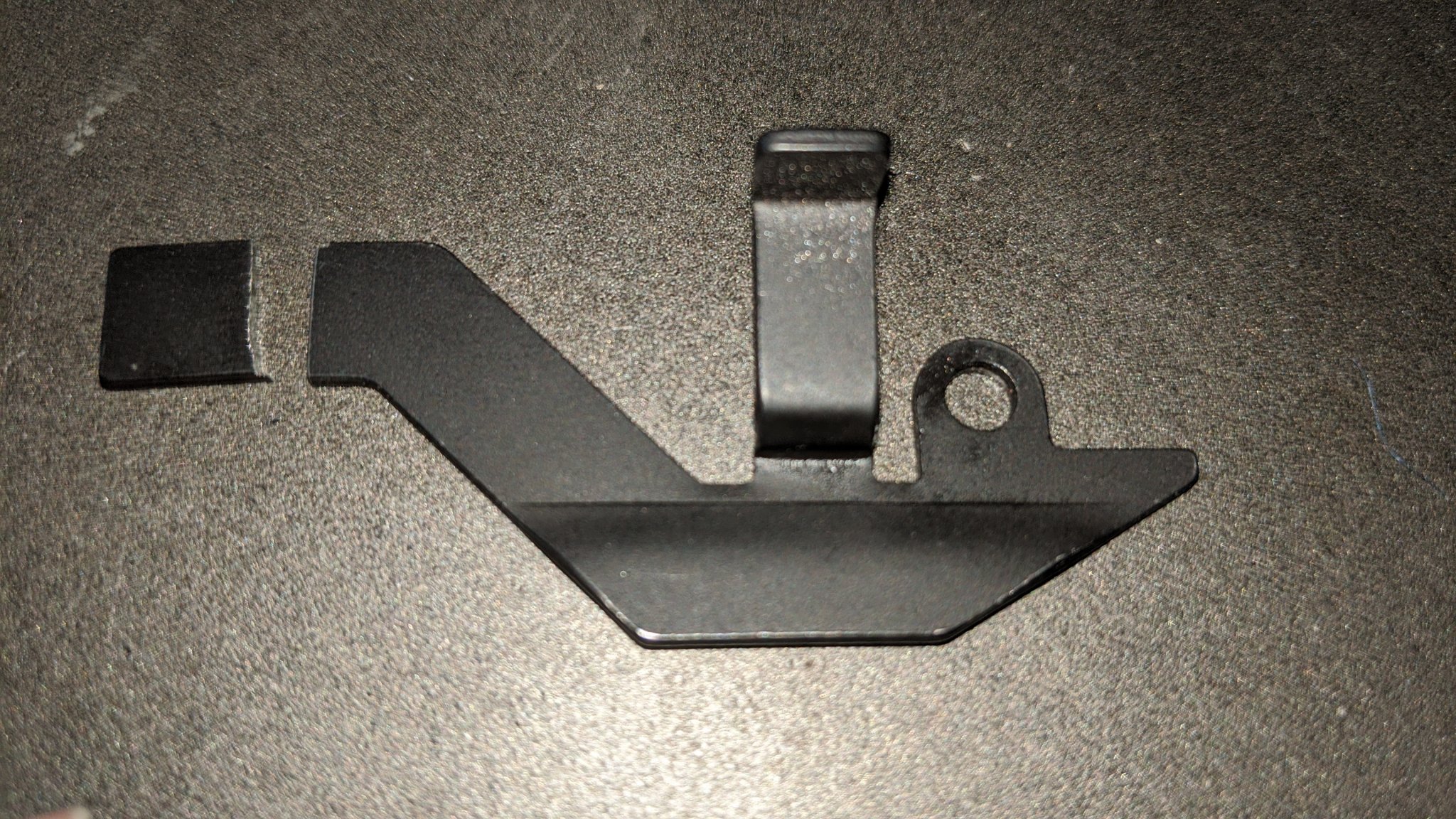

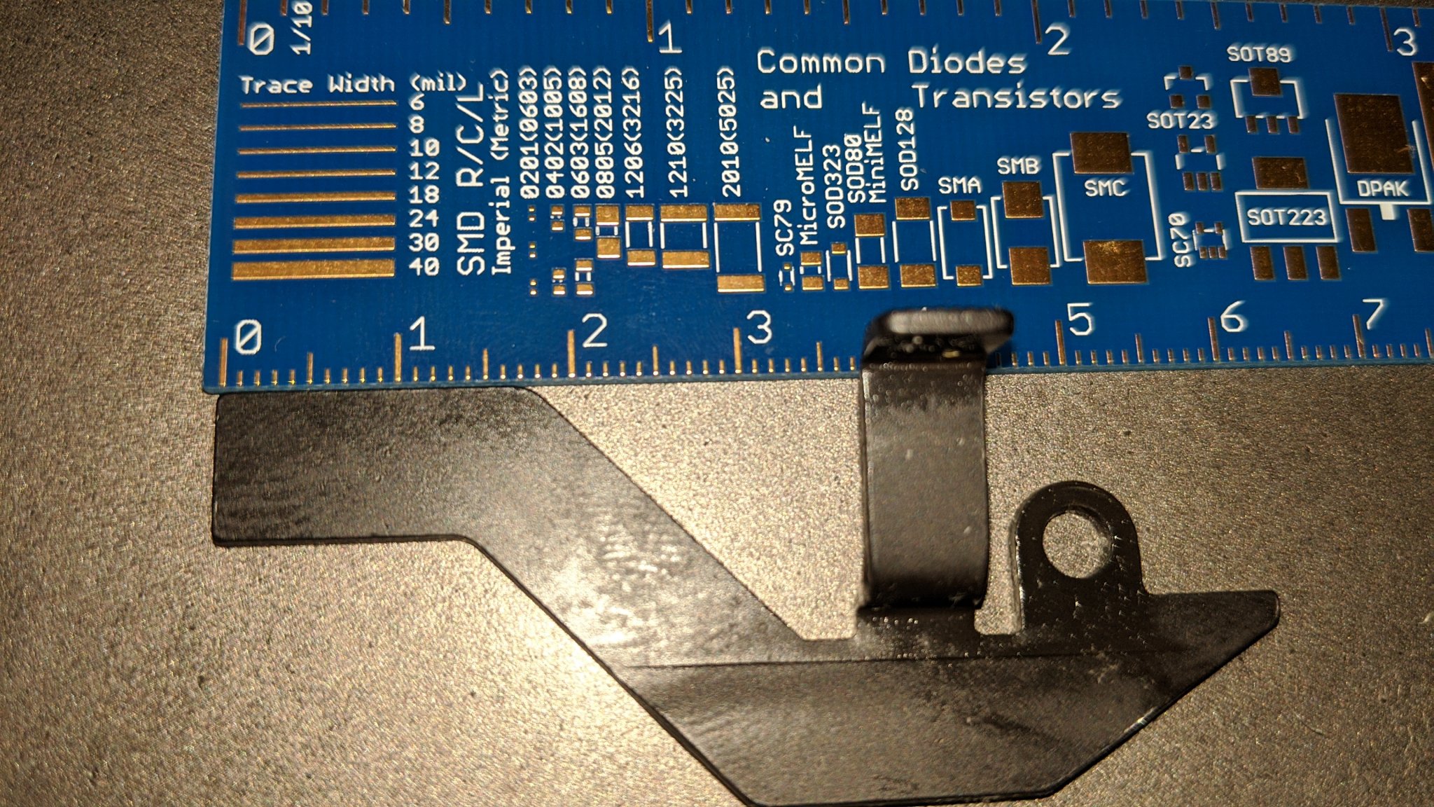

The bolt catch on this thing is an incredibly long flat piece of steel (17mm). If I take out a 3 to 4mm notch, that would allow the bolt to come rearward enough to come past the rim, solving my problems.
When you're done shaking your head in bewilderment
- pls remember to tell me what I'm missing.

Also, people have altered the bolt stop before. I haven't looked into it far enough to know exactly what it entails. You might want to look at that too.

You can either shorten your existing bolt stop or get one for a 308/243/6.5 etc and install that.
The bolt throw is shorter on the 223/204 because of the longer bolt stop and shorter cartridge. That's why there would have been a spacer in the hinged floor plate originally too.
