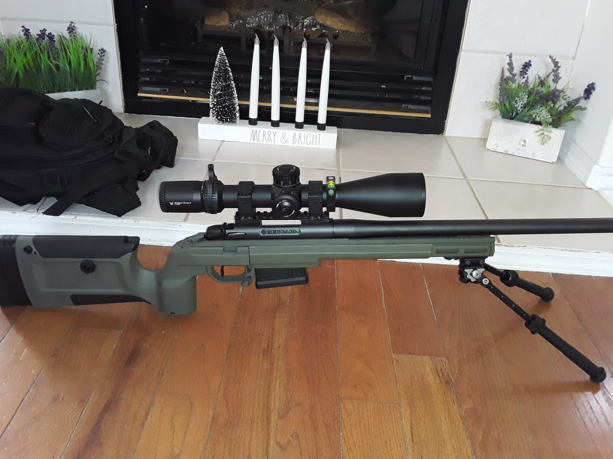

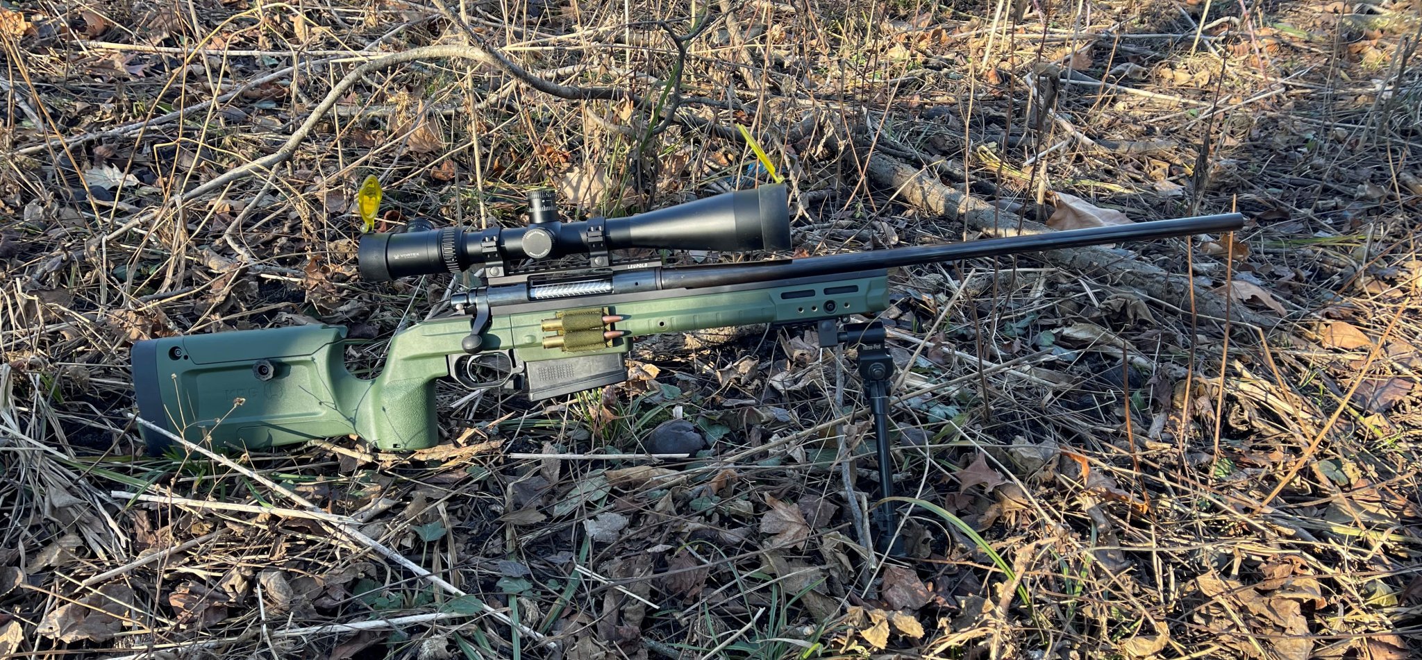

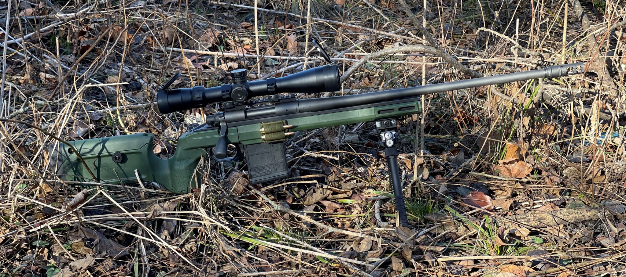

The other Bravo I have posted in this thread was sold. I own 2 actions yet I was up to five chassis, 2 Bravos, MPA, Manners EH1 and an Outdoorsmans. Attempting to thin the herd except one of the Bravo's had to stay. The Bravo is a great tool
This Bravo is holding my 7SAUM turned by PVA and a Curtis Axiom that came from MPA.

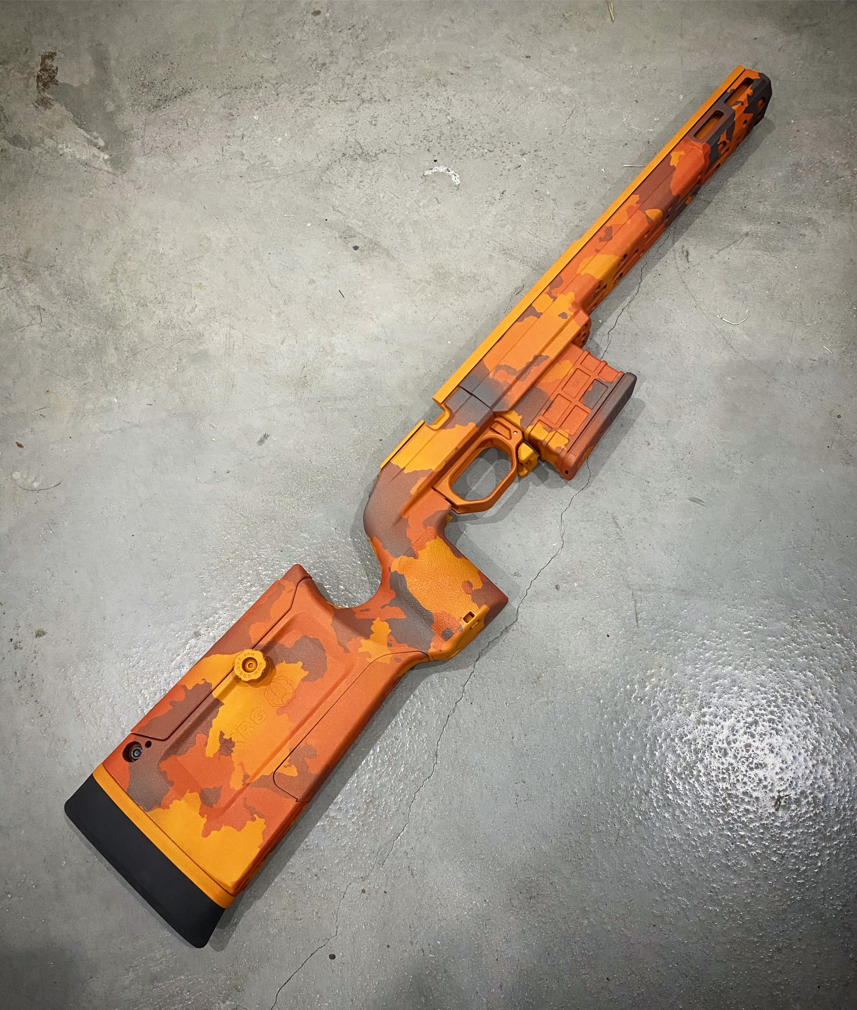

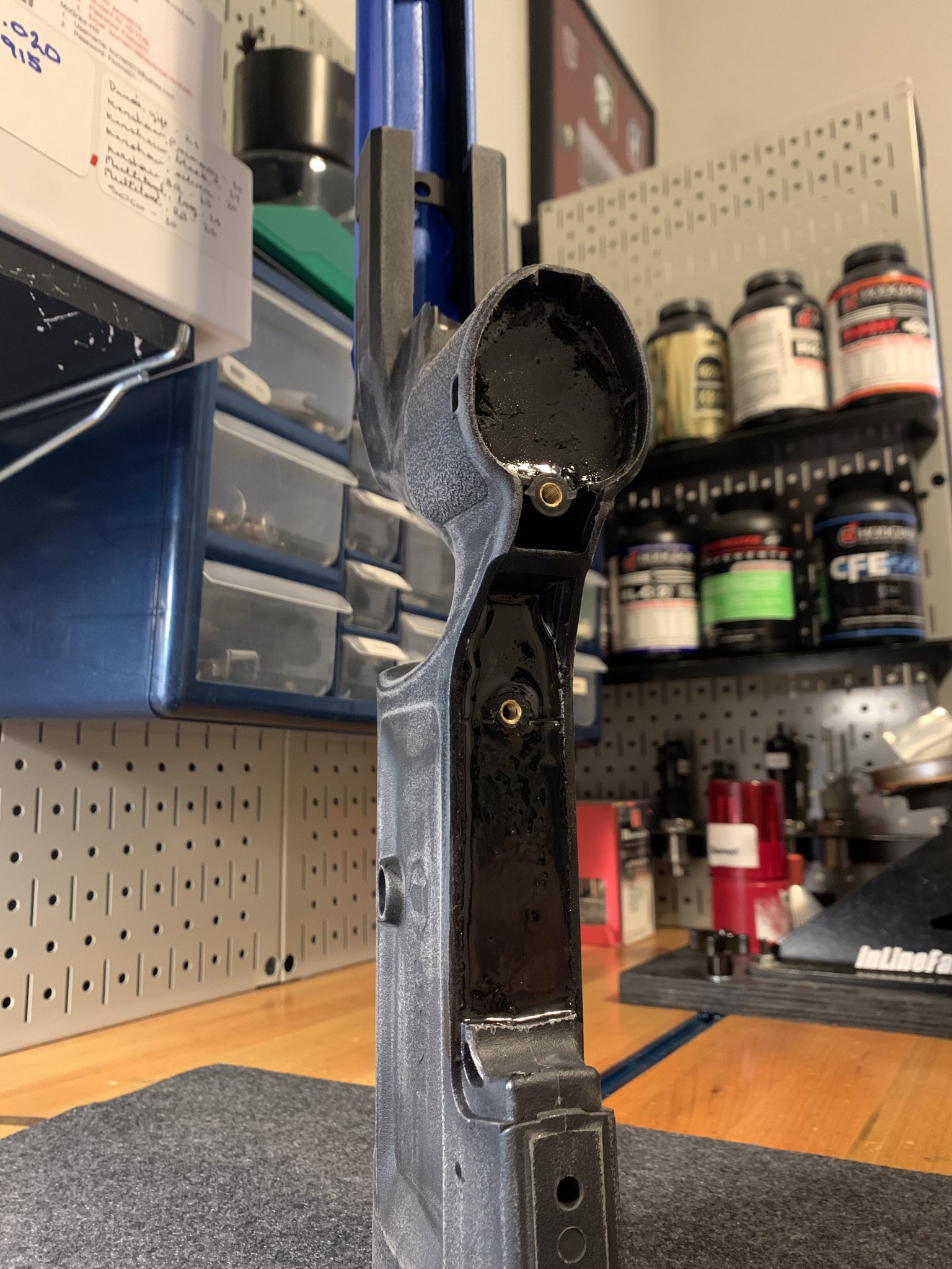

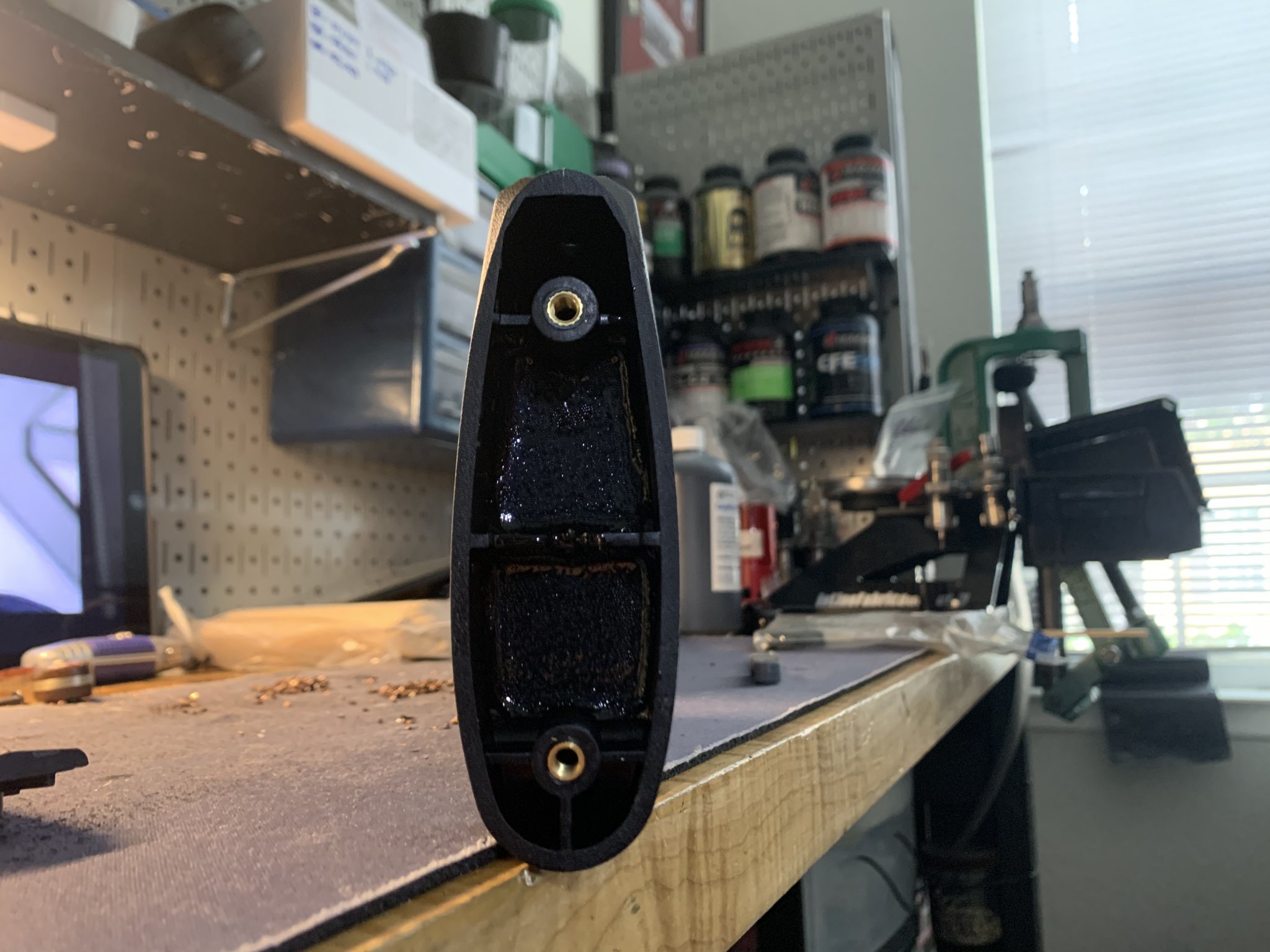

I've been working on a Bravo-related project some of you might be interested in, others may be repulsed. The one and only complaint I have about the Bravo is that the stock is front heavy, made much worse by the 26" M24 profile 6CM barrel used on my project that, by itself, is 5lb. The fulcrum of the rifle is forward of the mag well. So, to remedy this, I decided to add weight to the rear of the stock. The goal is not just to add weight, but weight insofar as it balances the rifle and moves the fulcrum aft.

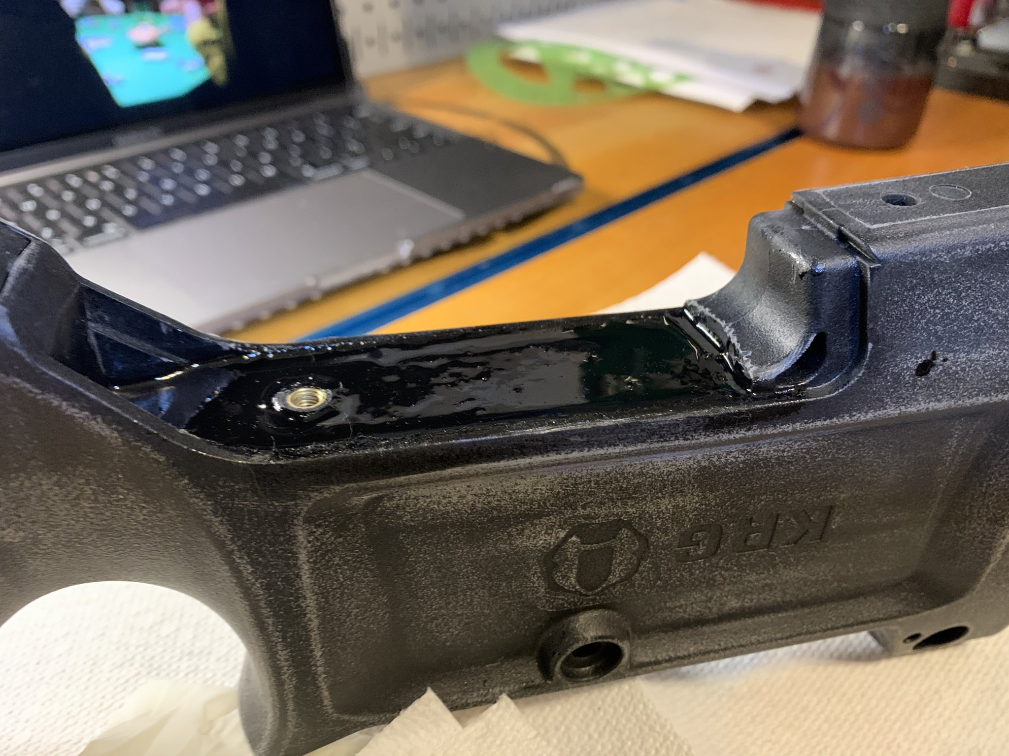

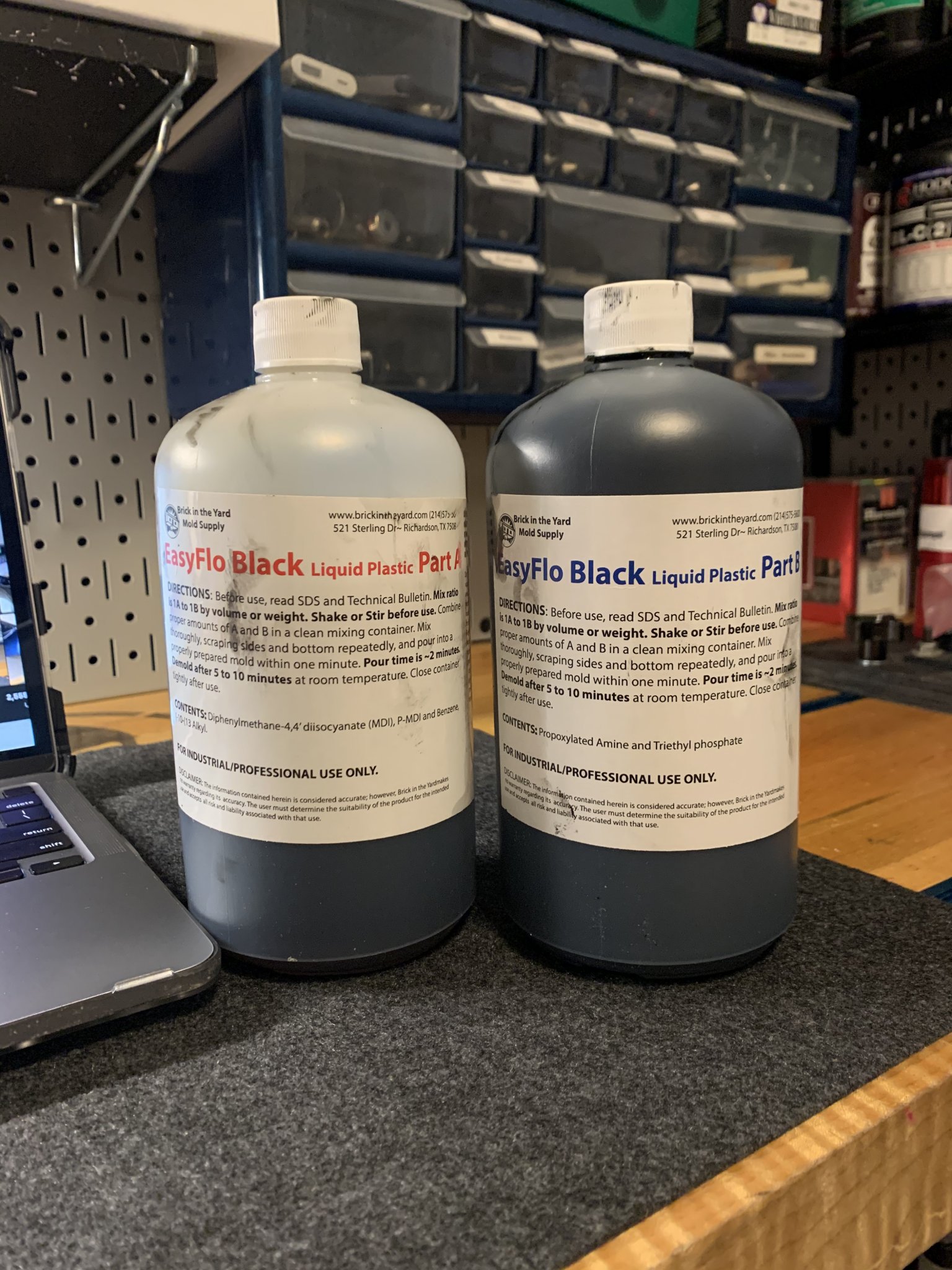

On my last Bravo, I used JB Weld and steel BBs. This time, however, I wanted more weight and a cleaner look. Initially, I intended to make removable weights. This proved cumbersome and unnecessarily complicated so I went for the permanent option. This time around I chose to use copper instead of steel since it is around 12% denser than steel, giving me more weight per cubic inch. I used a mold-making material called EasyFlo Black sourced from Brick In the Yard, or BITY.
Again, originally I planned to make removable weights. I would've started with a positive using a gel material, then a negative with more gel, then the final positive out of the EasyFlo but it was just not working the way I wanted so I abandoned it in favor of permanently adding the material to the stock. The EasyFlo is just the binding substrate, the real weight comes from the copper shavings I acquired via Etsy.

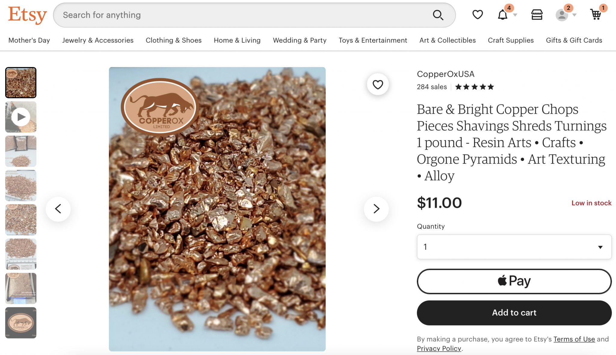

When it was all said and done, I mixed 1-1/2lb of copper chips in with the EasyFlo. Actually, pre-measured the two parts which is a 1:1 ratio, mixed the copper in with part B, then added part A to the B/copper mixture and stirred it all together quickly. The EasyFlo only has a pour time of about two minutes (and they mean two) so I had to work quickly. Just before introducing the mixture into the stock, I poured the excess liquid into a waiting container, poured the saturated copper mixture into the stock, then capped it off with the liquid to make it all look pretty.
The majority went into the rear of the stock
The rest filled the under side and grip cavities
In total, I added 1-1/2lbs and all in the rear-most portion of the stock pushing the center of gravity to the buttock area. Once the enclosed forend comes in, the whole stock should balance out nicely. NOTE I'm prepped for pain it looks like crap at the moment.

It's still a little tipsy toward the front but I don't regret this mod one bit. It definitely added heft in all the right places. Plus, when you pick it up it feels solid, not like, well, hollow plastic. I saw they came out with a grip weight, but I wish they had a tight fitting weight for each of the cavities. It's no different than external weights planted in key areas, just prettier. I think I remember balancing the rifle pre-mod and it was way out toward the front of the stock (basic forend, beforeI added the enclosed), now it's right at the action.
I'm running a Proof competition contour. I used #8 lead shot in baggies in the various holes in the stock. I got it balanced and still have room to add more weight.
I almost went the shot route, but I got more density out of the copper. For what I spent on that little project, I might just do the shot next time lol

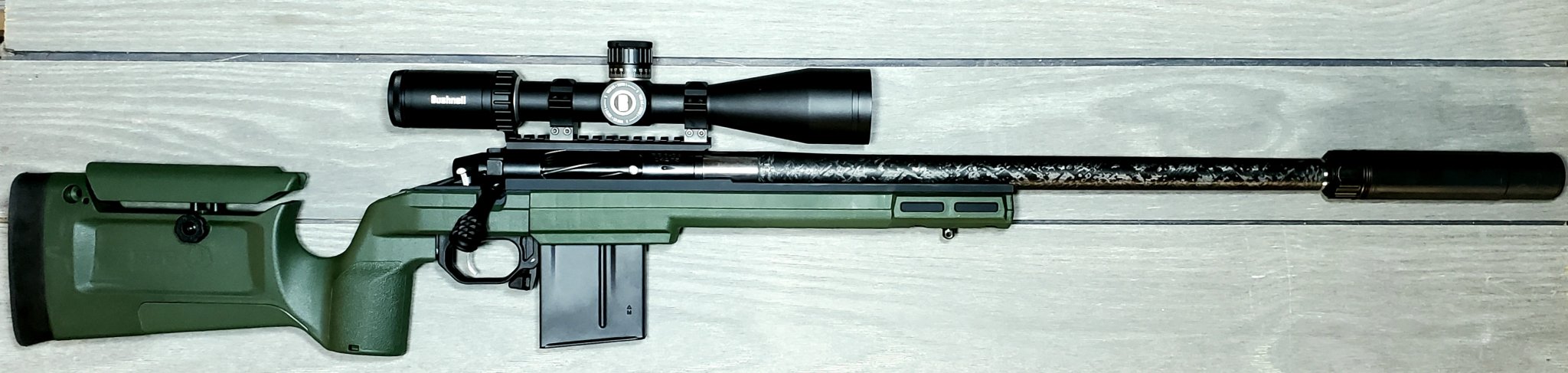

Still waiting on my trigger to show up, but all the other parts have so I just had to put it together.
LH Nucleus Gen 2
PVA / Rock Creek barrel in 223
LH KRG Bravo
S&B PM II 5-25 in ARC M10 rings
LH Trigger Tech Special trigger - When it shows up!

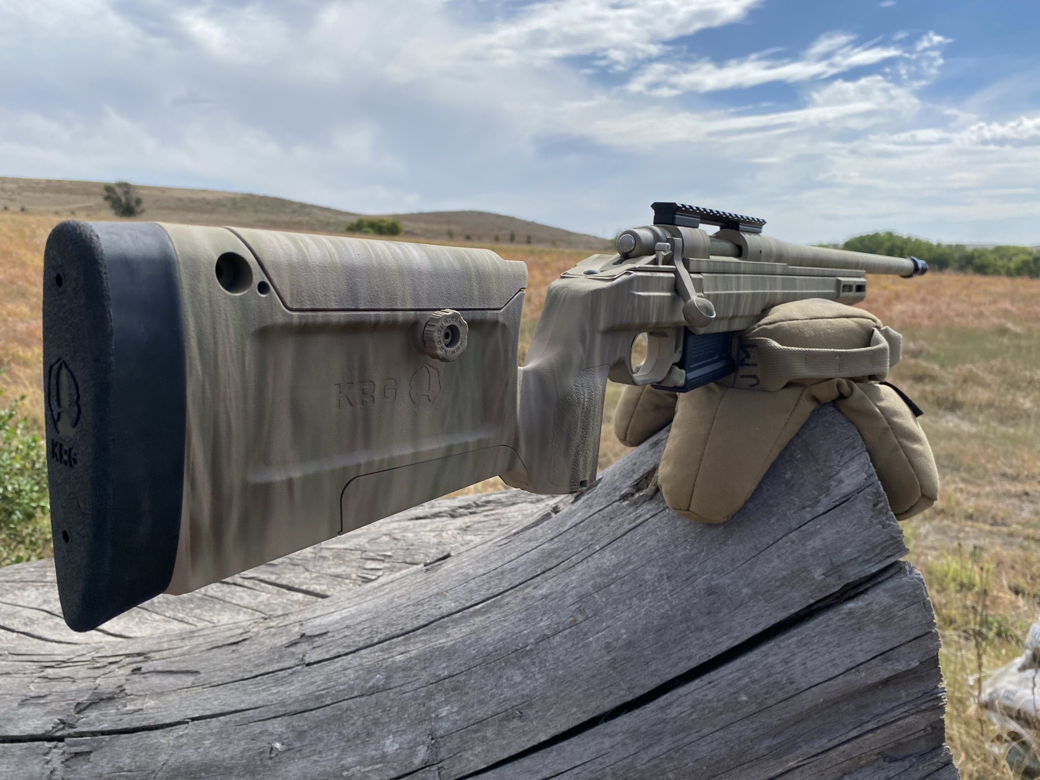

I may have missed this in a prior post as I have not gone through all of them, but if you get bored and wouldn't mind detailing the paints etc for that I'd be grateful. That looks outstanding.

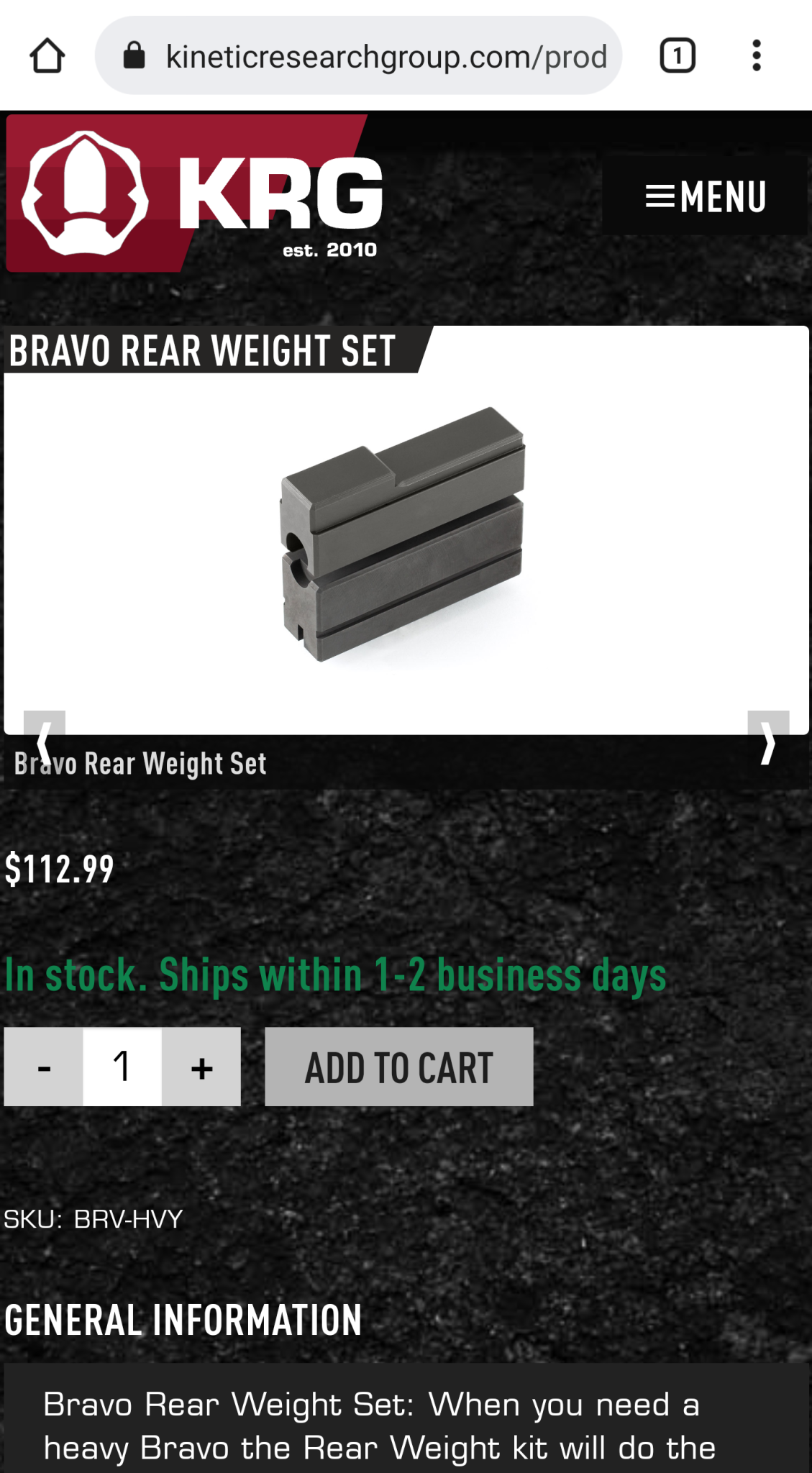

So between the heavy XL Arca rail (56oz), spacer (20oz), the T-slot weight for the closed rail (16oz), the grip weight(14oz), the rear weights (26oz), and a LOP spacer (11oz), a guy COULD add almost 9 pounds to his gun. Of course, it would cost him $500 to do it but you don't get something for nothing in this game. If I add 9lb to my gun as it is right now it would be right around 29lb!
The Heavy XL Arca is 29oz.You can add the heavy barrier stop for 6oz or steel stop for 14oz.

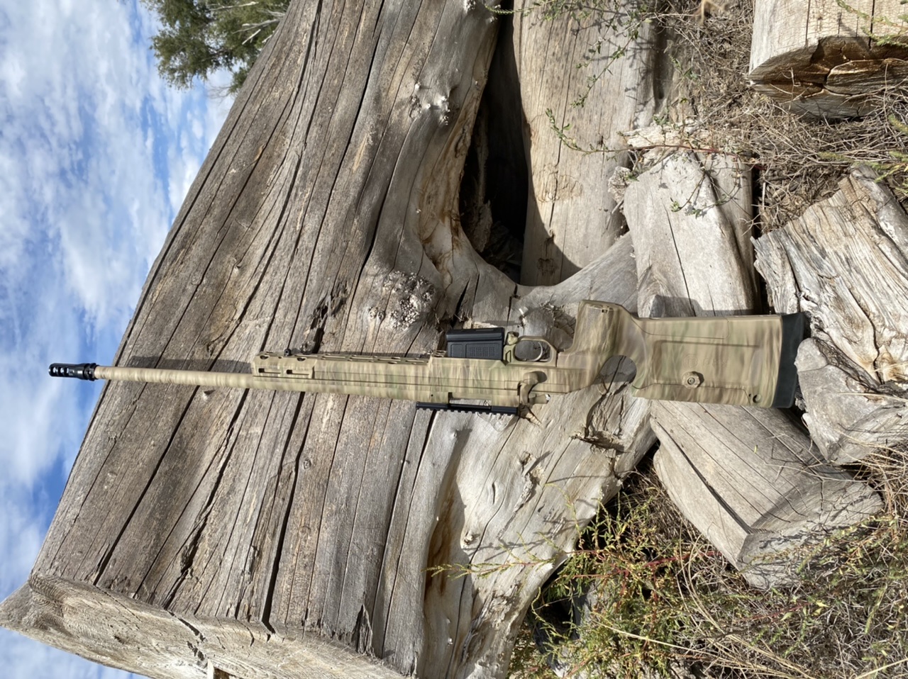

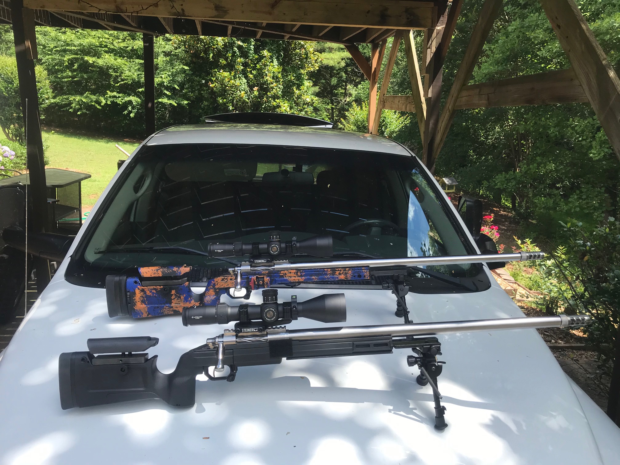

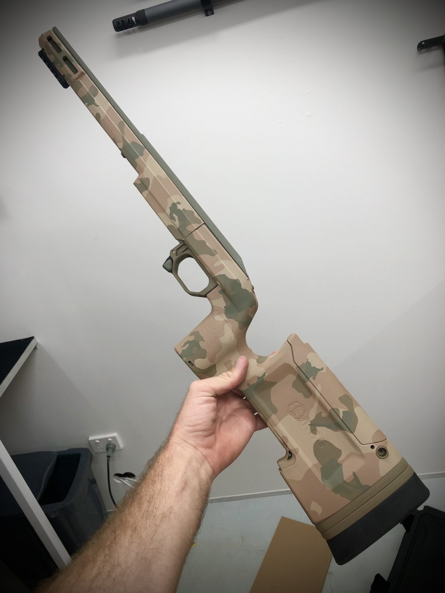

I used Alcohol Ink's that you can buy online or at a local Hobby store. Just prep the stock and paint it with a matte white or beige colored paint, and then apply the alcohol ink's. I had the best results getting a wood grain look using a cheap makeup brush set that I bought off Amazon.
You have to work fast with the ink's - they dry really fast, but if you screw up or don't like something, you can just use rubbing alcohol on a paper towel and wipe it off.
I practiced on a couple old factory takeoff stocks to begin with, and to see what color combinations worked best. Once you get the look you want, spray 2-3 coats of clear paint to protect the ink finish. I used a matte clear on mine.
Reactions: atepointer

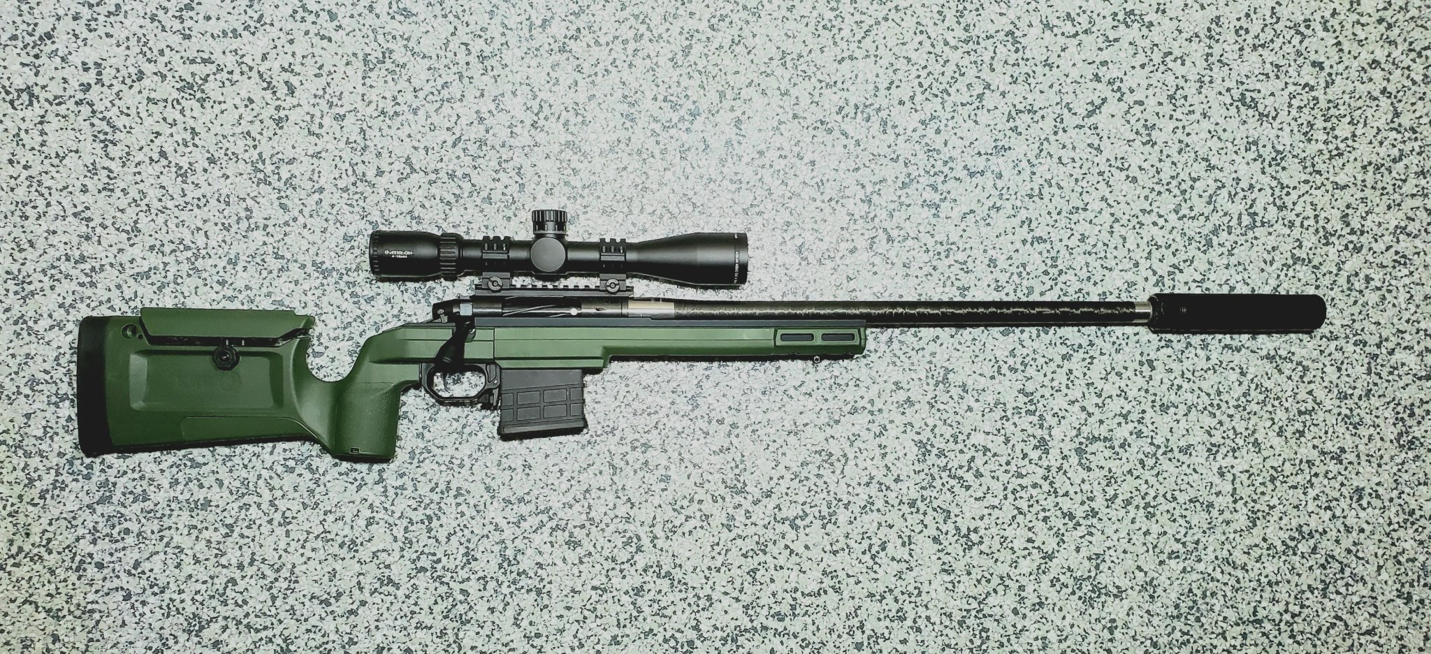

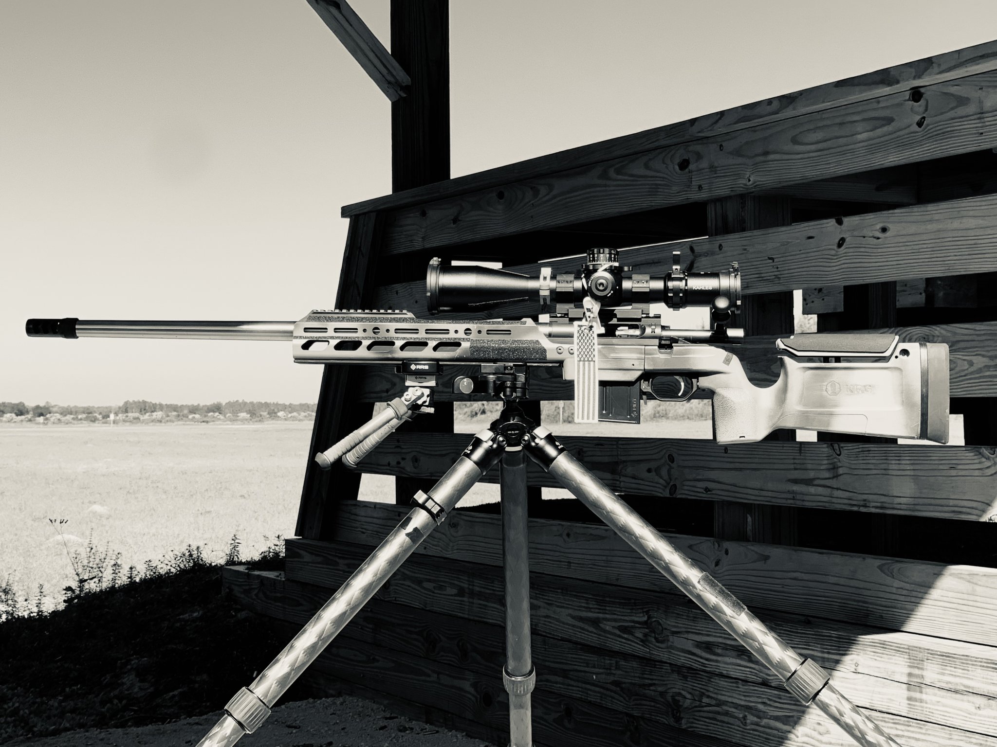

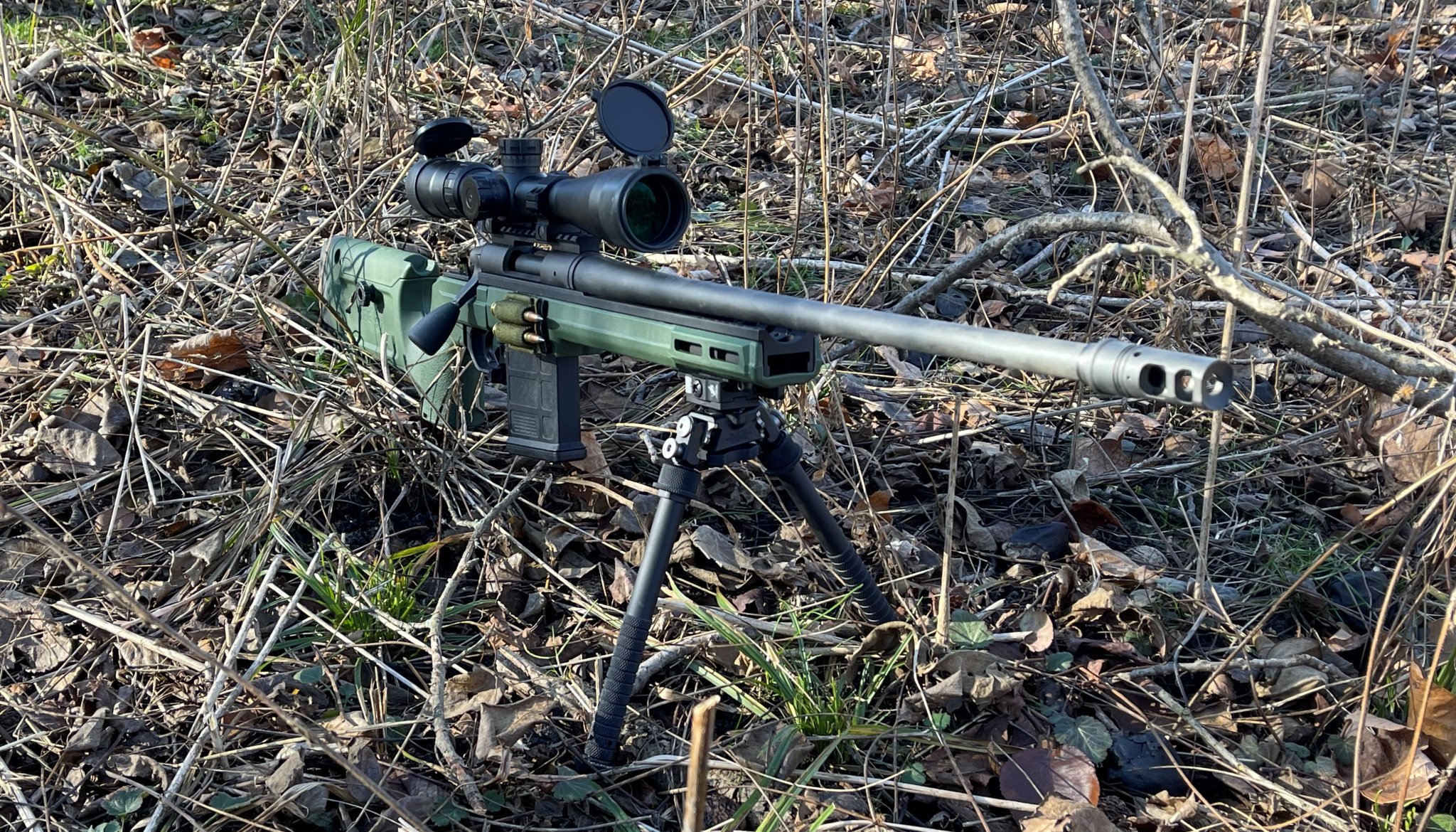

New build spun up my Chase at Fisher T&C-
  • Zermat Origin receiver set.
  • Proof Research 20" 300wsm 1/10 twist, Sendero profile
  • Barrel threaded for DeadAir suppressor
  • Trigger tech Remington 700 Primary trigger
  • Accurate mag 300wsm AICS mag
Previous build spun up by Keystone Accuracy
  • Zermat Origin receive set
  • Bartlien 20" 233 Wylde
  • Barrel threaded for DeadAir Suppressor
  • Trigger Tech Diamond
Outstanding thank you
Out of curiosity what does the 300wsm weigh?
I am going to try this as I just received my Bravo. Would you mind please sharing what color combo you used there? Honestly I don't want or need anything different looking than that it's awesome. I've also got an older Bergara B14 stock I'm going to do....thanks man great looking Bravo.
I bought a couple different sets of the inks off Amazon.
Tim Holtz Adirondack - Cabin Cupboard set, and the Pixiss - Brown ink set.
I also bought a cheap 10pc makeup brush set that I used to apply it. They worked a lot better than the paint brushes that I tried.

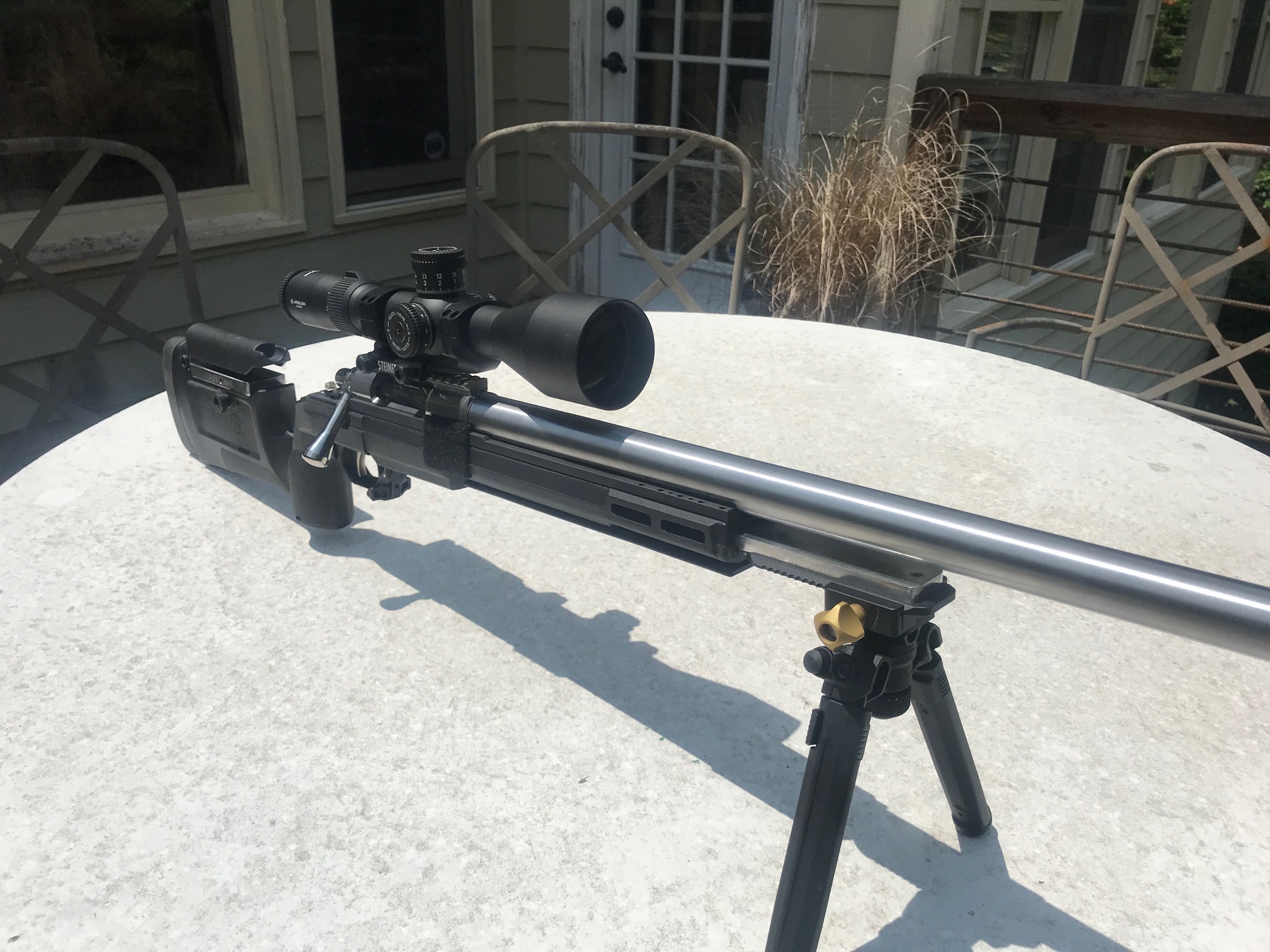

If I could figure out how to post a pic of my KRB Bravo project, which was completed yesterday when the mount showed up, I would. Its an old rig, from my Palma days: totally trued up M700, pinned Tubb lug, Jewel trigger, 30" fluted Krieger, in 223/1-8", Spuhr 4026 mount and a new XRS III. I've added an Atlas bipod and am planning on shooting it at a Tehama steel match in February. And yes, way back 20+ years ago, I shot it at 1000 and I shot the smallest group EVERY at 300 yds with it...slinged up prone/irons. Looking forward to shooting it WITH a scope!
