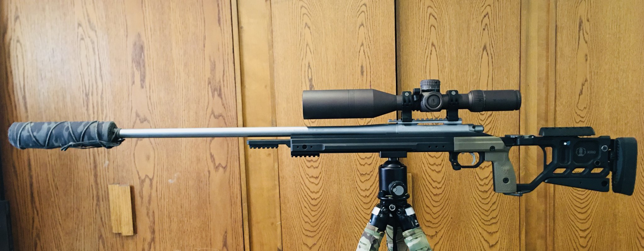

you own a W3 and Bravo, then you should know the ARCA and the forend are threaded into the backbone.
Yes, of course. Here’s is my Bravo with the Arca rail screwed to the bottom.
I assume you understand that being threaded into the backbone does not obviate the need to take separate measurements if you’re interested in fine measurements?
If want to learn individually how backbone and forend are contributing to the combined diff, I agree with what you said.
Hold up, I guess it sounds like you do understand…
And for sure you're not owing the W3 Comp version, because the Comp version has aluminum forend with ARCA integrated.
Au contraire mon frère, I own the folder and upgraded the forend to the aluminum Arca one.

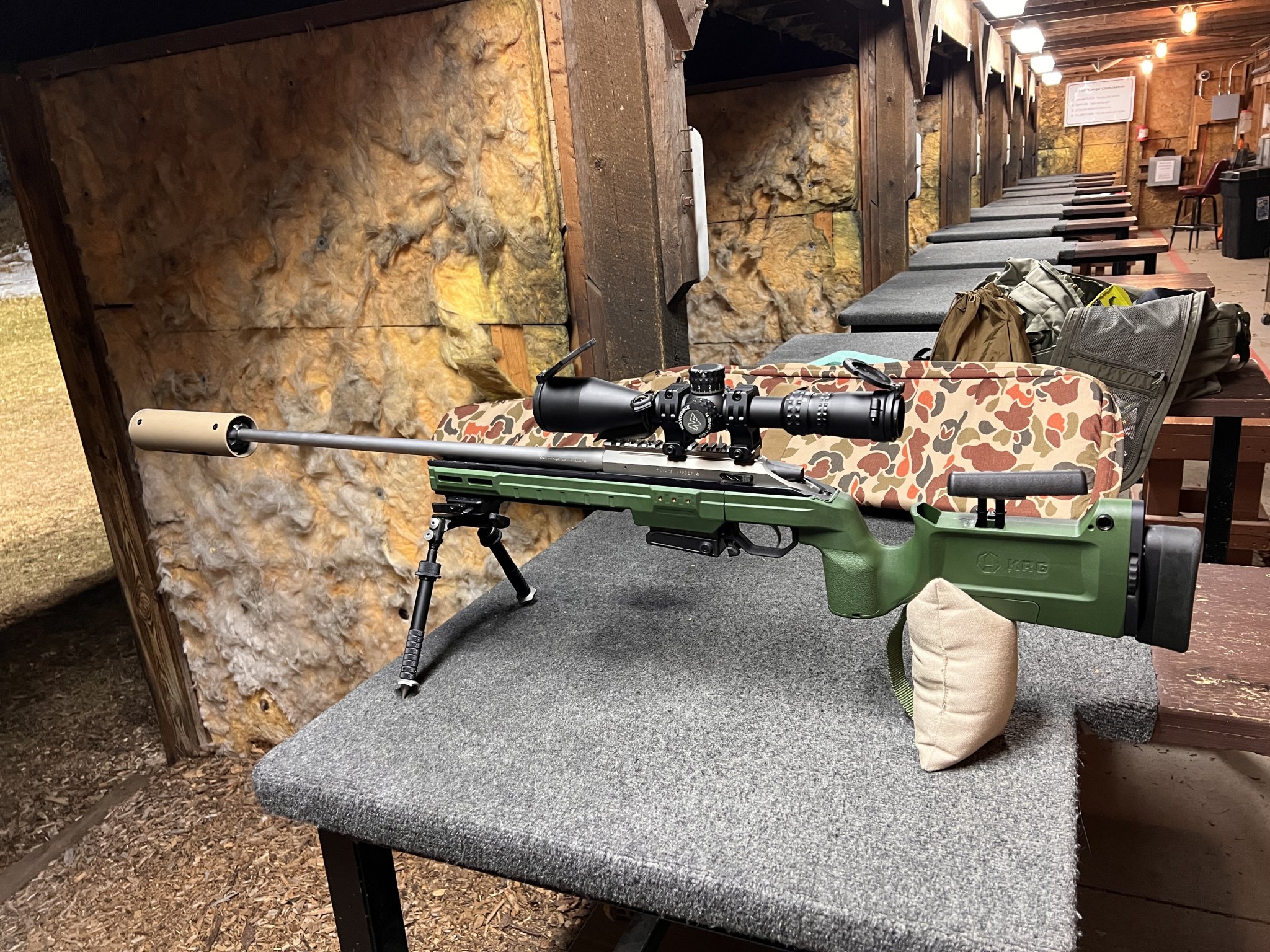

Recently bought a KRG Whiskey-3 Comp pack.

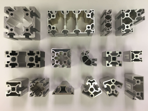

These parts are extrusions. They are a shaped tube. In raw form (4m long pieces) they are called billets.
So machined parts from billets... is correct. However the backbone is mostly shaped. All it gets is a few drill holes, tapped, and a magazine cutout. Oh, and recoil lug slot. It would be 2mins at most to make.
