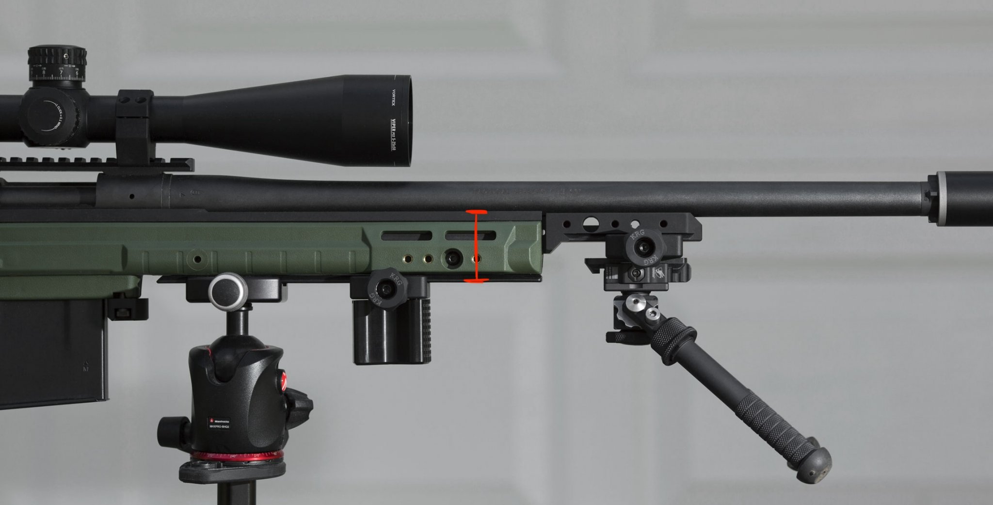

the action contact surface is a curve so not that easy to measure, but the action side (rear) wall is holding a tigher tolerance in comparison to the front side according to my measure.
this chassis is prepared for my next build, so i cannot tell the experience tightening the screw as of now. btw, is it common to bed the tactical style chassis like W-3? I did try bedding one cheap boyds stock once, it's a nightmare lol.

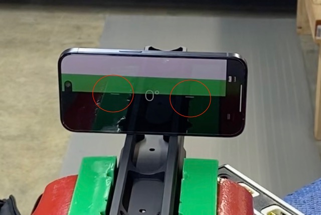

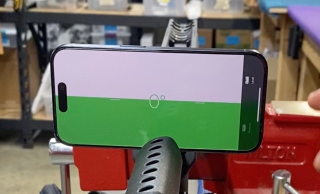

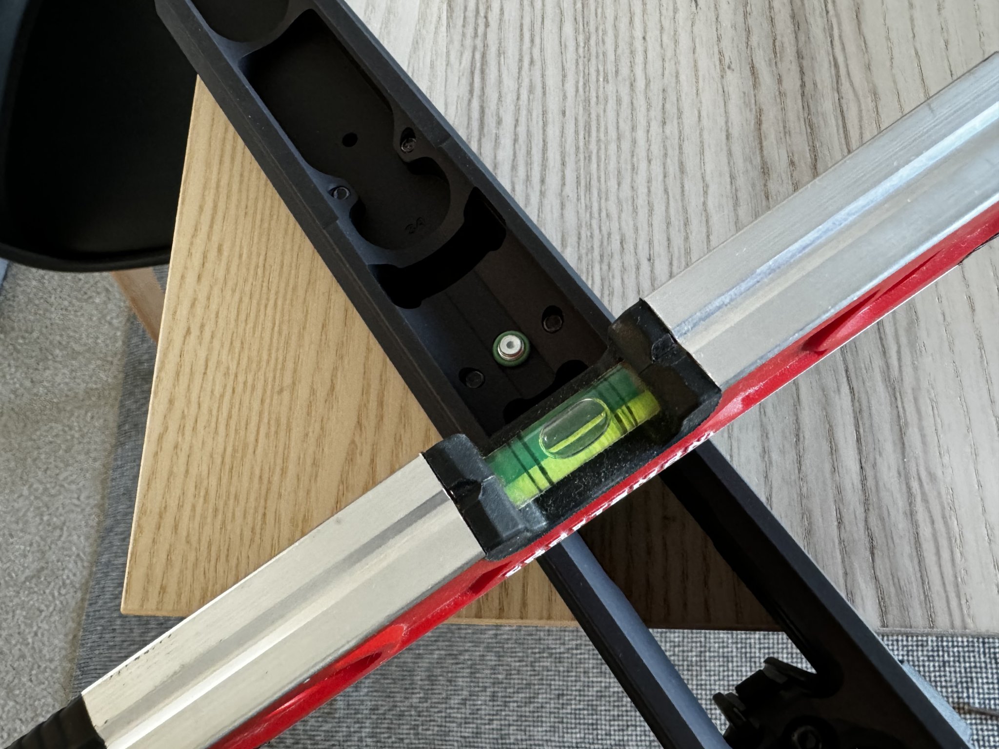

Initially i noticed is the misalignment on barrel tunnel between spigot and the backbone, this indicates the mating surface between the spigot and the backbone is not parallel to the top surface of the backbone, though from my eye, the concentricity is okay.
Then I guess it might be the backbone being:
  • tilted, in this case if i put the bakcbone on a leveled surface, the measures should be not leveled but haves the same reading on different measurement points
  • twsisted, this turn out to be the case, where one the same surface, the measure is different from rear to front

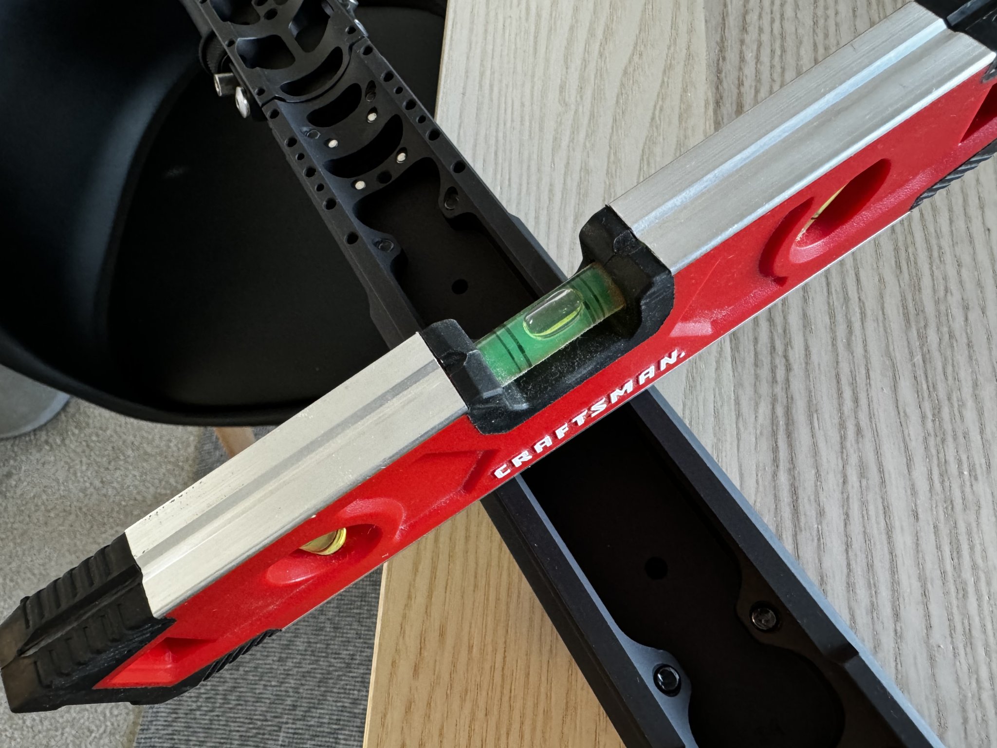

Ummm just need the chassis itself, so with the barreled action removed. ARCA rail attached is fine as the rail surface is supposed to be parallel to the bottom surface of the forend.
Yeah, the backbone, but also the forend and them combined seem twisted as in my original post. It would be helpful enough if you can measure them combined, no need to set them apart. The twist can be seen by naked eye from the difference on bubble position.
Tbh, this all start by misalignment on barrel tunnel between spigot and backbone, which is pretty observable by naked eye without any instrument (like this torpedo as you said lol). The issue on twist is just a side product when I try to findout where's exactly the issue.
example:

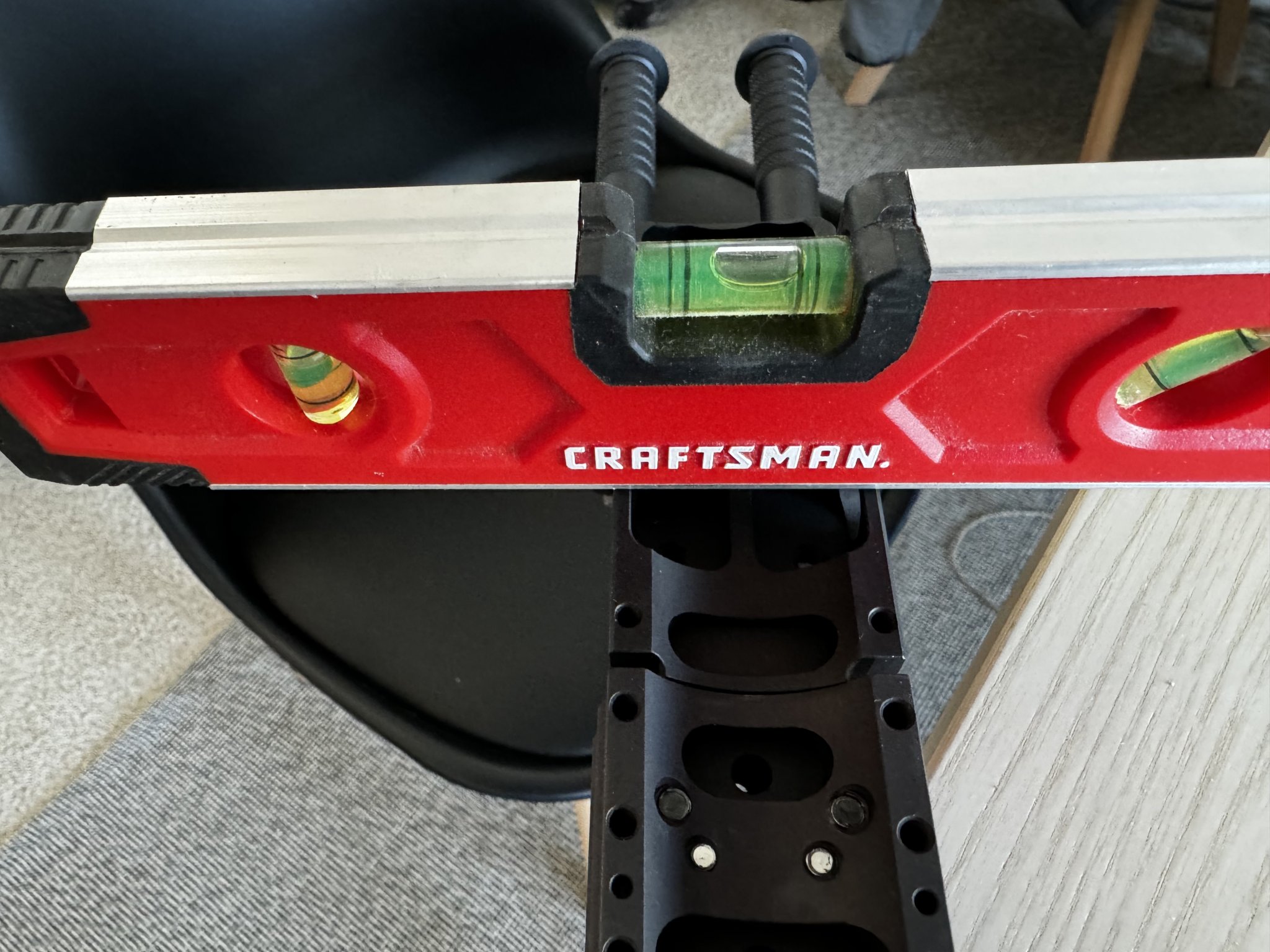

View attachment 8421373Rear (bubble within line)
View attachment 8421376Middle (bubble touch the line)
View attachment 8421374Front (bubble cross the line)
I do not have a chassis with nothing in it. All of mine have barreled actions in them, and other stuff, this is what I'm saying.

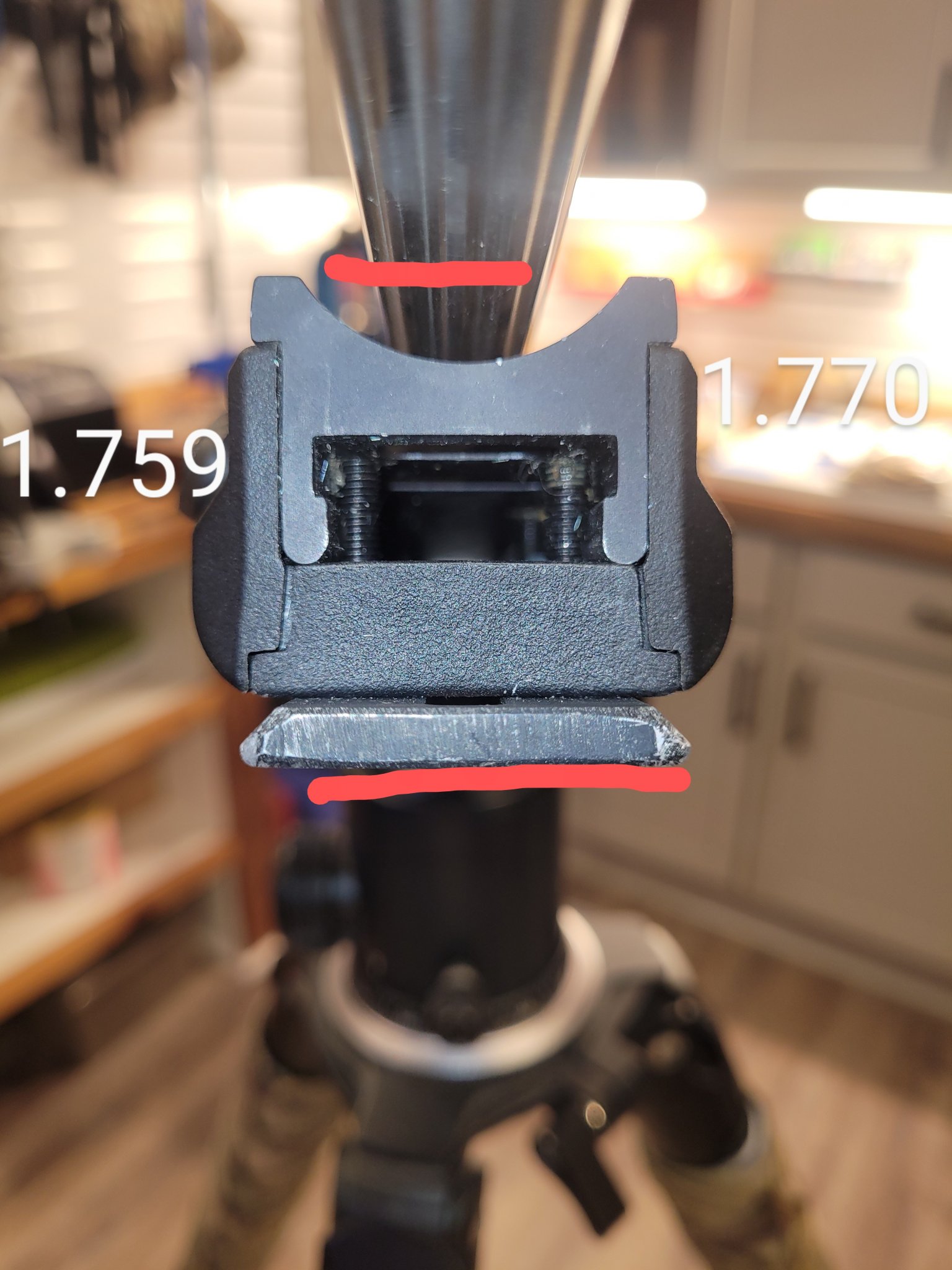

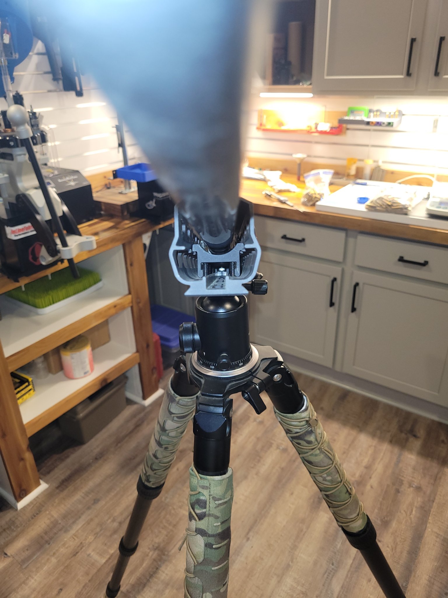

Everything in your photos looks fine, I am willing to bet KRG is out of answers for your questions and are hoping you will fade away. As others have said, put the thing back together finish your build and go shoot. If you want to call that "recalibrating your expectations" go for it!

Thank you so much! This is helpful. So I think 0.010 ~ 0.020 inch diff might be realistic for the front.
Would you want to measure somewhere closer to the action? I noticed the diff is tighter on the action side.
You're right. 1.634" from under the forend itself to the top rail right beside the action. Other side is 1.631" so that's dead nuts. My measuring accuracy is limited due to not being sure I'm square on both sides with calipers but yes it's a ton tighter from one side to the other there on both chassis 's

I like how they are measuring three different surfaces at the same time.
One item is injection moulded plastic.
Combine the errors, especially the plastic and then complain about the tolerances.

But I didn’t realize that in your measurements you are including an injected moulded plastic part.
C’mon man.
I’m not an engineer and even I know that you don’t expect inject moulded plastic to be anywhere near perfect. And that thin Arca rail? Pffft! (I own a W3 and Bravo btw)
If your actual aluminum backbone was twisted a lot, especially where your action/lug interfaces, then you’d have something to think about.
Your autism is getting the best of you.

you own a W3 and Bravo, then you should know the ARCA and the forend are threaded into the backbone. I agree the injected modeled in between could be an issue but I cannot ask the one who's willing to take measure for me to disassemble his established rifle and measure individual parts.
And for sure you're not owing the W3 Comp version, because the Comp version has aluminum forend with ARCA integrated. My measure doesn't involve any plastic part. (and now you see how arrogant some spoilers who judge on their own imagination are)
What a fucking joke.
Yeah his entire setup is one big shitshow and he expects anyone to take his "measurements" seriously.

Only two pieces in my combo. I observed the issue with two piece combined, them I measured with two piece combined, any issue here? given I'm not further interested in their root cause.
