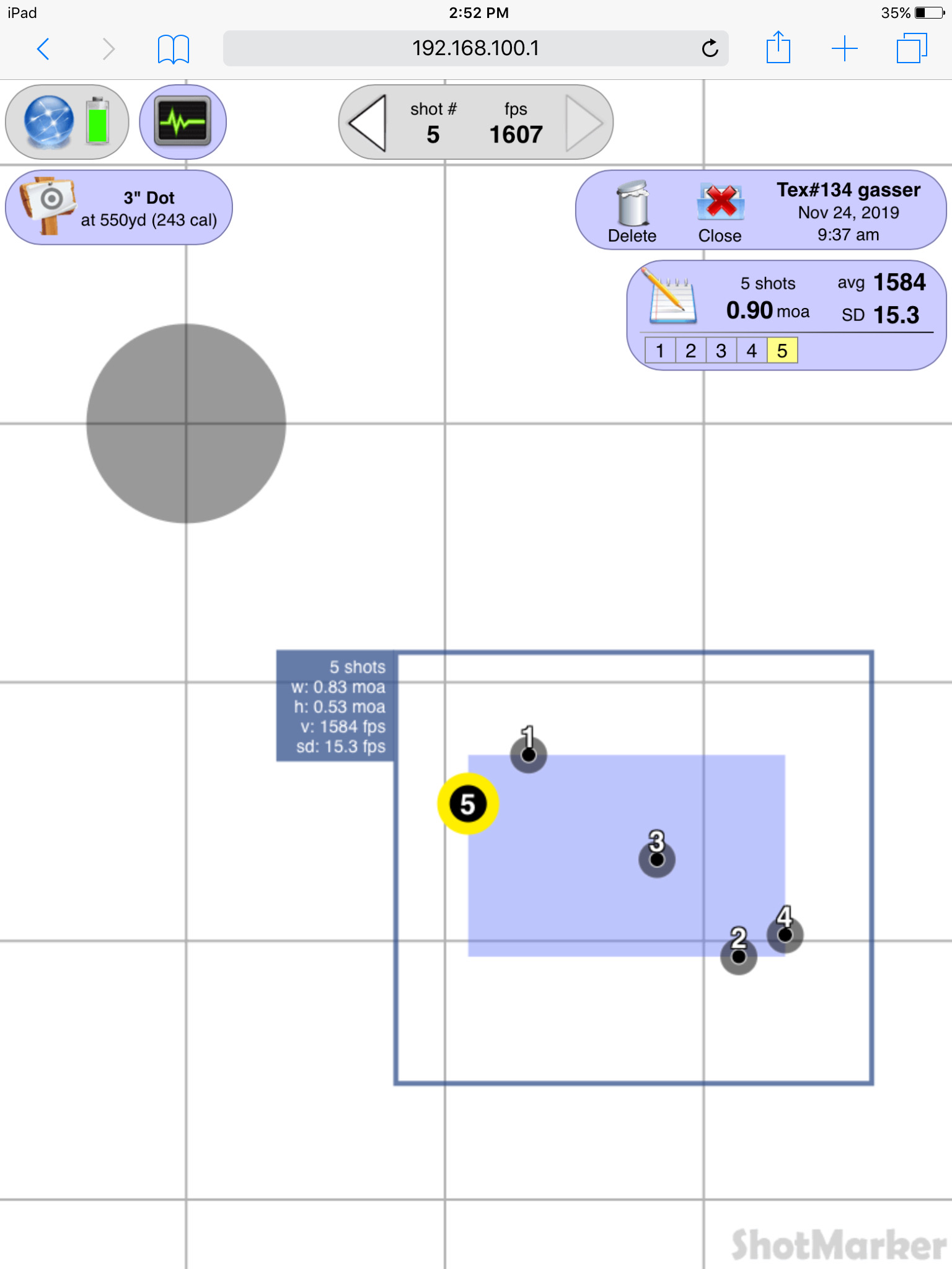

    I have a Krieger in my factory KAC LPR Mod 2. Compared to my old Mod 1, it’s a little picky but once I found a load it likes wow. I shot this at 550 over the weekend.
