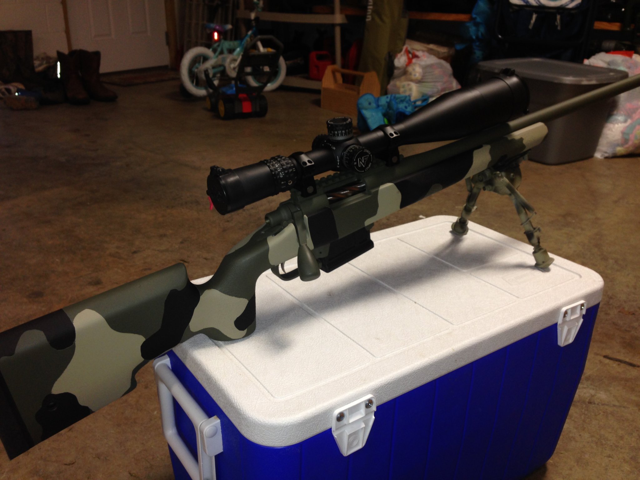

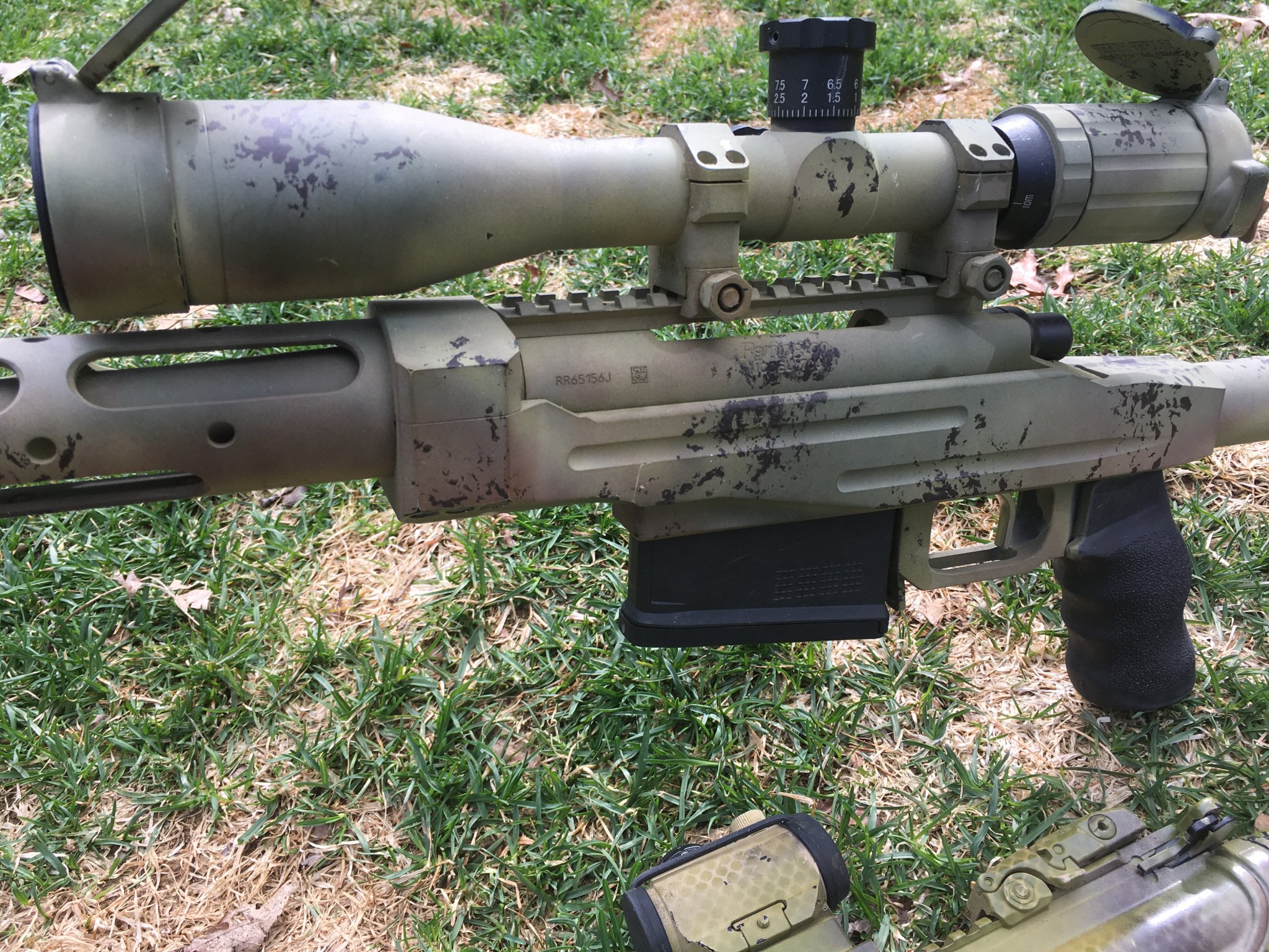

I done a grayboe. It stuck really well. Wiped it down with alcohol or something of that sort to clean. Then used the expensive blue painters tape to cut out patterns. Didn’t take long at all to dry. Waited maybe thirty minutes between colors. No paint peeled off. Lines are sharp. Then sprayed a light clear coat. It did leave sort of a raised edge feel from one color to next but I don’t mind it.
That looks sharp! As to the raised edges between colors, some 300 or 600 grit just before the clear coat will take care of that.
