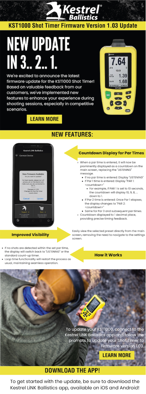

    Bumping an older thread here-
    I still think that the KST1000 is the best shot timer I've used over the past 8-10 years. It's built well, accurate, and I find it to be better than the PACT and CE offerings I was used to. That said-
    It still isn't 'wowing' me with suppressed 22lr shooters. It'll pick the shots up on that setting, but you still have to keep it awfully close to the muzzle to register the shots when time is a factor in the scoring. You can adjust the sensitivity a bit further admittedly but even after the latest update, if you were to go to that sensitivity, it was picking up rifles banging against a prop (really all of the props) as a shot.
    The latest update Kestrel released, worked pretty well for us at the last shoot and was certainly a step in the right direction making it even better. All in all- still a big fan of it (and one should be given that it costs 2-3x what its competition goes for). I'm still not wild about the yellow color and wish that it did better with suppressed 22lr but despite those criticisms I still think it's the best shot timer on the market in my personal experience.
