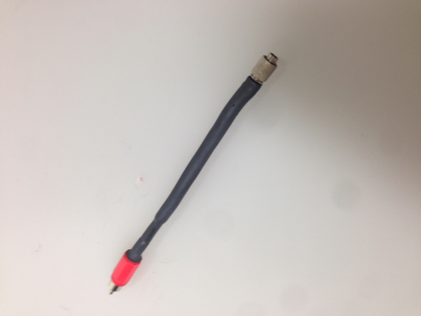

Also, has anyone made or found an economic video out cable solution for the LWTS? The only place I know that has one sells them for $490 and that is probably too much for the casual amount I would use it but I would like to have one.
Supply vs Demand, number of units purchased by a distributor, L-3's "dealer"/wholesale prices for the "precious" metal, multi-prong connectors, distributor/customer loyalty/multiple purchases of Thermal Weapon Sights/viewers & common accessories for a variety of other NVD related items will determine the final cost of the video cable assemblies to the end-users. Haggling... err, negotiating isn't always an effective way around the issue & while this business is somewhat competitive & at times a bit emotional, I have yet to see a bargain unit.
The connectors are EXPENSIVE, regardless, & your supplier will assemble the complete unit at whatever length you require. My understanding is that 6" is one of the more popular lengths. That said, I'm currently at a loss for suggesting an "economic" solution.
If a proprietary/non-standardized connector is involved for a particular device, you are forced to pay dearly in order to play. One thing leads to another; GOT DVR? Is it ever enough & what are you willing to pay while ultimately considering limited usage?
If I shell out that kind of money for a THERMAL device, I want a complete kit at some point & fairly soon; DVR & cable included. I'll skip politics & prioritization, but you just never know whether policies regarding certain ITAR related products will affect your ability to acquire support items in the future. "The times they are a changin'... !" ...on a State by State basis & .gov involved influence is instrumental in determining civilian policies.
In any event, I was kicking an idea around with an associate who is familiar the LWTS. Some distributors have admitted that they find communications with L-3 Engineering can be painfully time consuming. I'm trying to determine if a viable alternative to all the cable spaghetti could be achieved by using the LWTS video out socket & plugging in a tiny transmitter with matching connector as a modular unit similar in function to a baby monitor that could be fabricated for remote viewing.
I'll admit my priorities are a bit skewed & I tend to get long winded... but I thought I'd pass on whatever I come up with as I confirm options even if I've had too much Java this morning while catching up on current events.
