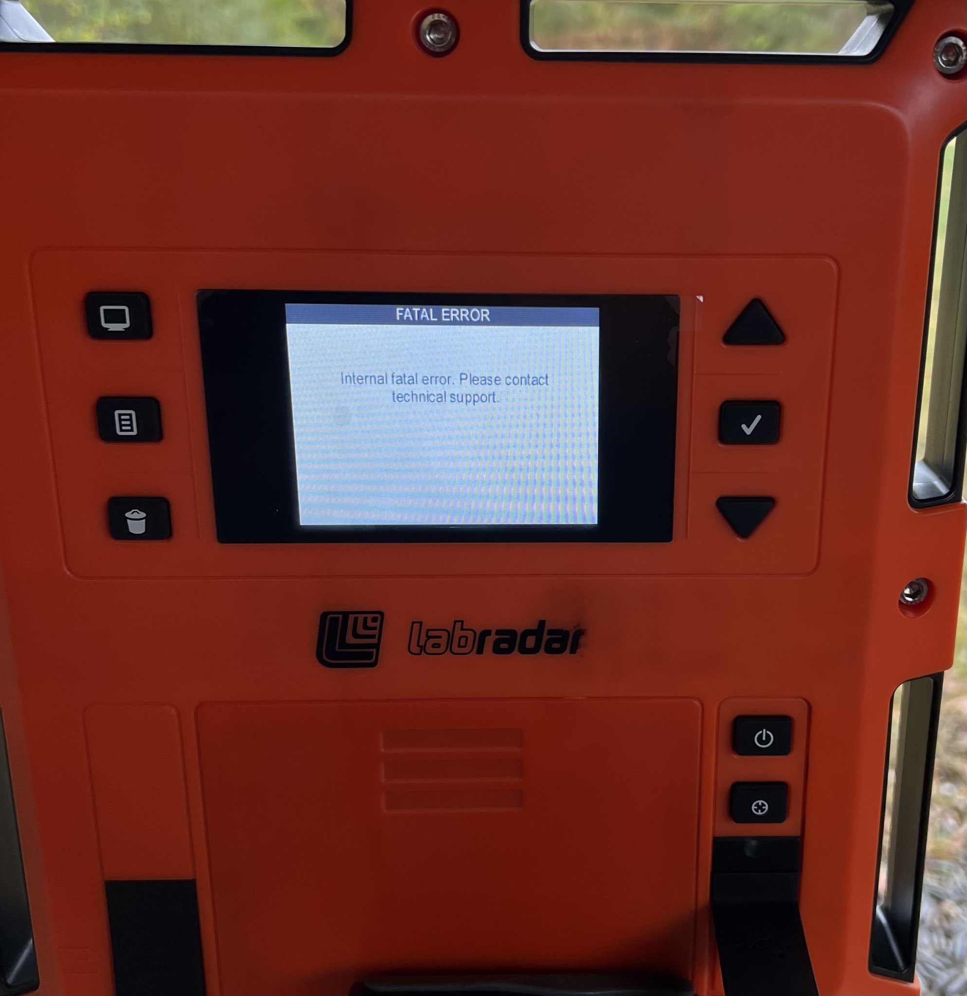

LABRADAR "FATAL ERROR" MESSAGE
gunfrog
Jan 10, 2010
14
7
65
Northern Virginia
Brought my MRAD 338 on her first range trip. Hoped to zero, chrono, and "break in" . 2 out of 3 aint bad. My Labradar stopped working and displayed this error message. " Fatal error, contact manufacture". Which I will do. But have any of you guys encountered this? Was there an easy fix?

I had this problem a few years back. I thought i broke it from too much muzzle blast. Tried what was suggested and started working again. 3 years on and still going. Also try another sd card if it doesn't work. I vaguely remember my unit didn't like a particular card. Hope this helps.
From: [email protected] <[email protected]>
Sent: Tuesday, 24 April 2018 11:29:42 PM
Subject:RE: Internal Fatal Error
Harvey,
Is there an SD Card in your device? If so please take your SD card out and see if that resolves the issue. If it does not display the error, please check to make sure that the sliding mechanism that locks/unlocks the SD Card is in the fully unlocked position. Then reinsert the card and see if the problem has been resolved.
Best regards,
TCK, LLC, Exclusive Distributor of Labradar
www.mylabradar.com
LabRadar - My Personal Radar
www.mylabradar.com
LabRadar is the world’s newest technology in obtaining projectile velocities of Rifles, Shotguns (slugs only), Handguns, Pellet Guns, BB Guns, Bow & Arrows, Crossbows, Paintball.
www.buymylabradar.com
316-866-2525
Sent: Monday, April 23, 2018 5:58 PM
To: [email protected]
Subject: Internal Fatal Error
Hi,
I am getting an 'Internal Fatal Error' on my Lab Radar purchased on 5/4/17 . Could you pkease advise if there's anything i can do to resolve the issue? Thanks
Regards,

Thank you Harveyn! Your advice fixed it, I am back in business.
I just got this error. I don’t use an SD card in mine.
  • Wow
Reactions: 338dude
Got it fixed. So when I updated mine last I used an SD card. Forgot all about it.
Received an email back saying to download the older software and install it. Then download the newest software and install it. That will fix it. I tried several times and it would work. So I swapped the SD card started the process over. Fixed the issue.
