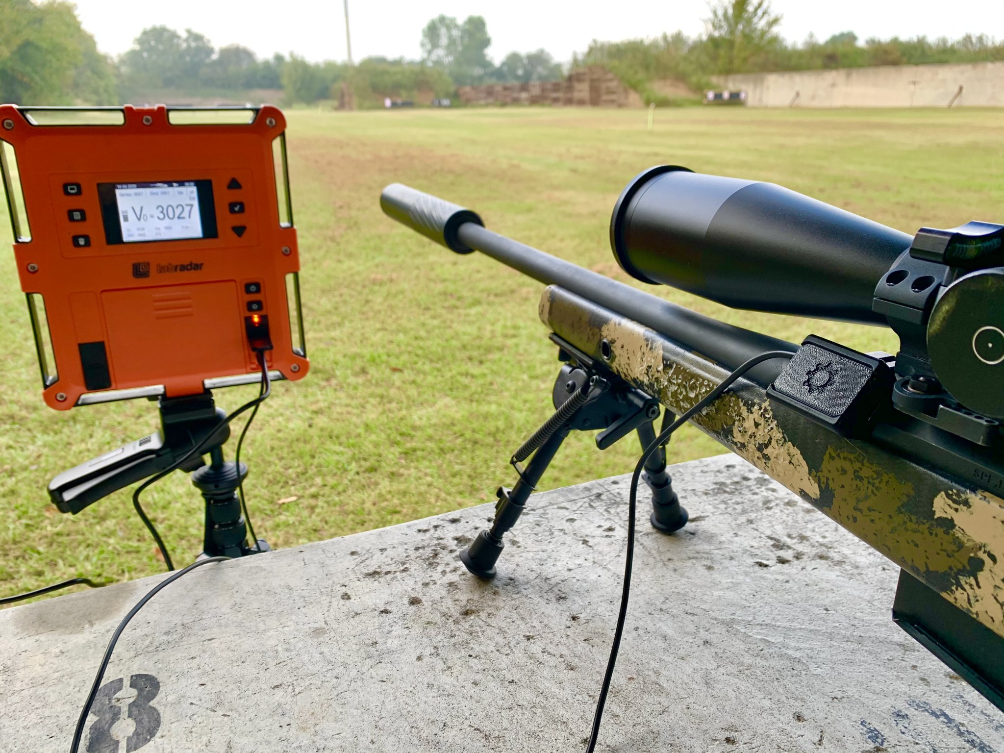

At my local range, I normally don't have too much of a problem getting everything to work right.
But one bay... the right hand bench is right along the wall of concrete ecology blocks on that side. If I set up the LR on the right side of that bench, I can't get $hit for readings. Any where else on any other bench, no problems.
Like so. Notice how the radar is even with the bipod.
(Was laying on the left side of a permanent bench, the pole caused a couple intermittent missed captures, so I swapped to right side of the bench)
