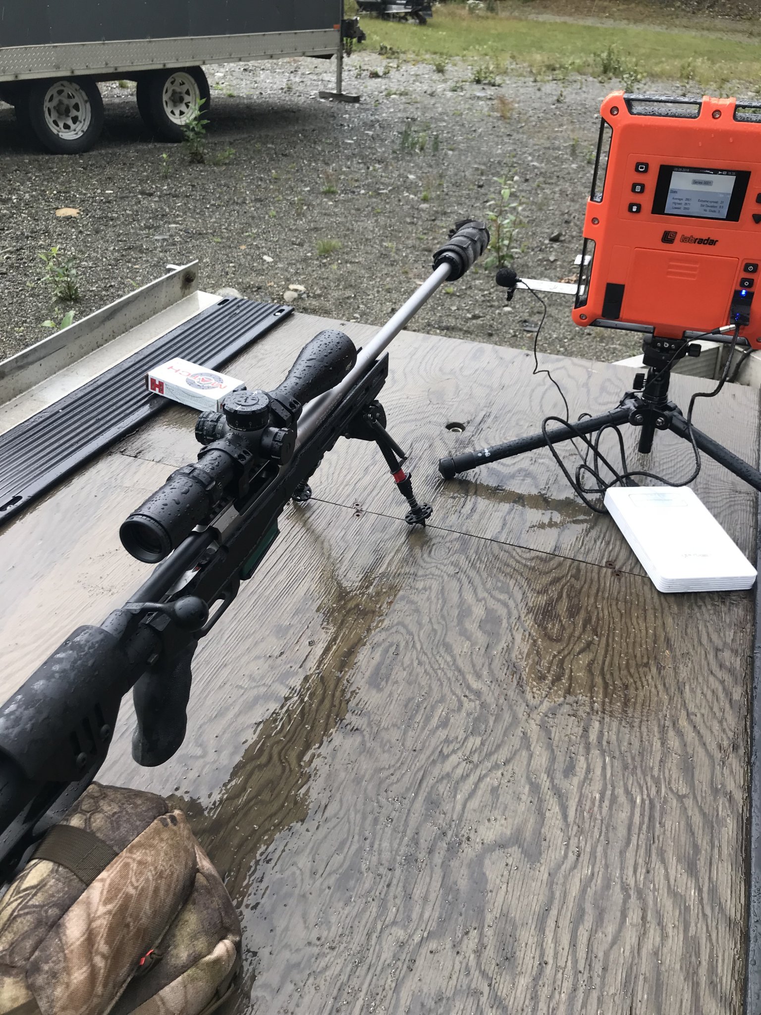

This is not my pic, but when I bought mine I set it up in similar fashion and it has always worked:
( I actually move the LabRadar a bit more to the right.)

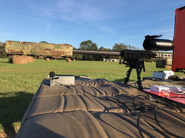

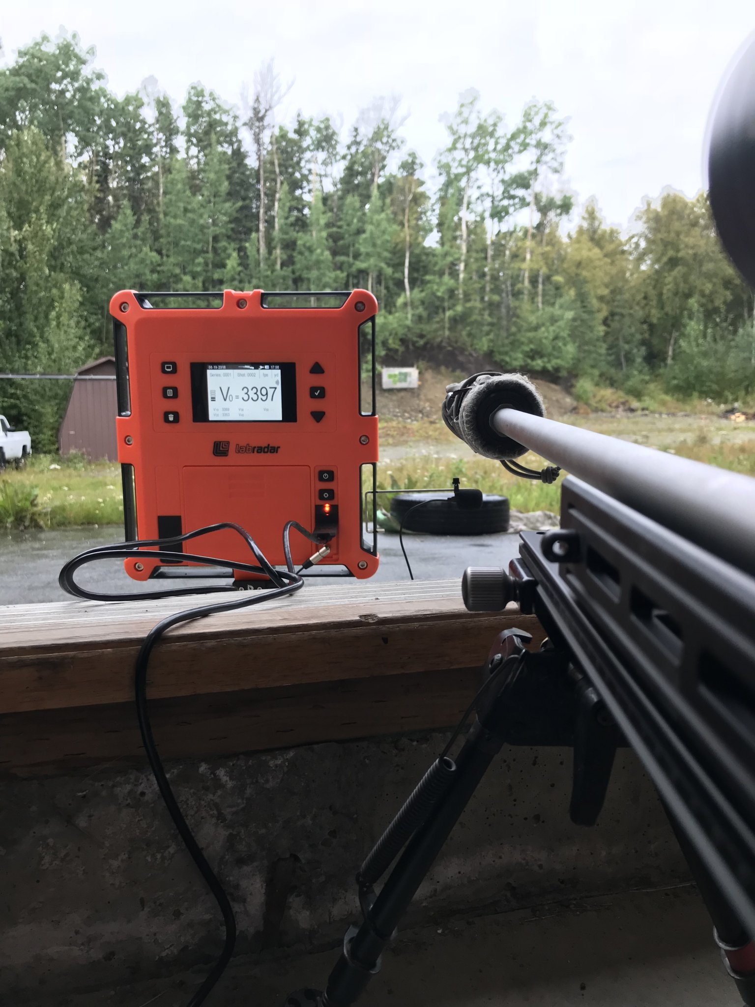

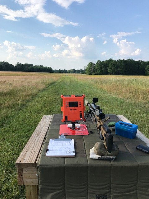

Cool. But, as I said, I don't have to get up to run the unit with the airgun trigger set forward and the unit set aft, so I'm not sure it would change much for me. I'll probably end up getting it though. Not the best pics, but here's my setup.
