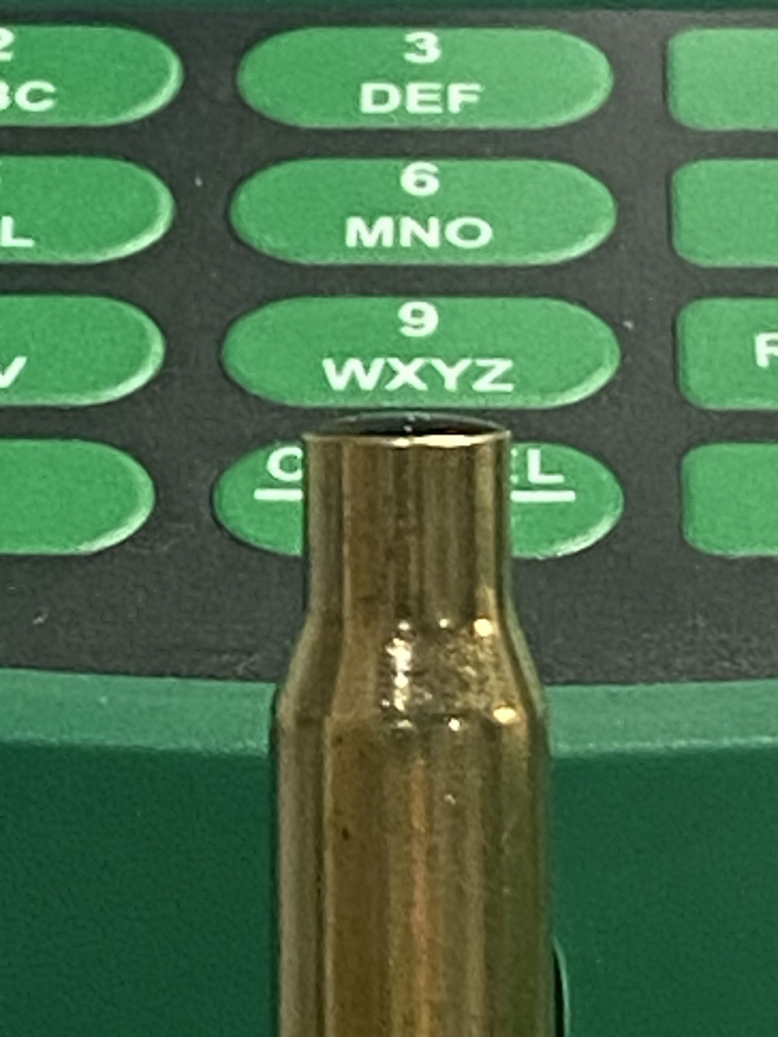

This brass is once fired brass. It has been cleaned, resized, swaged etc. I weighed the brass twice. Used denatured alcohol (density weight of 0.794) and converted to H20 weight. This is a sample of 100 pieces.
Filled to the top as shown in this picture:
I made every effort to insure that everyone was filled to this level.
