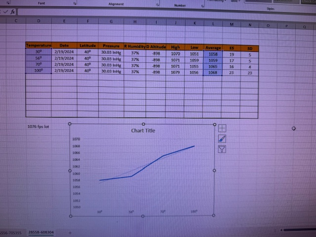

CenterX is fairly linear when I do MV Temp. The temperature is of the actual ammo that I put in coolers and has about an hour to stabilize at that temp. Been pretty reproducible with multiple lots.
