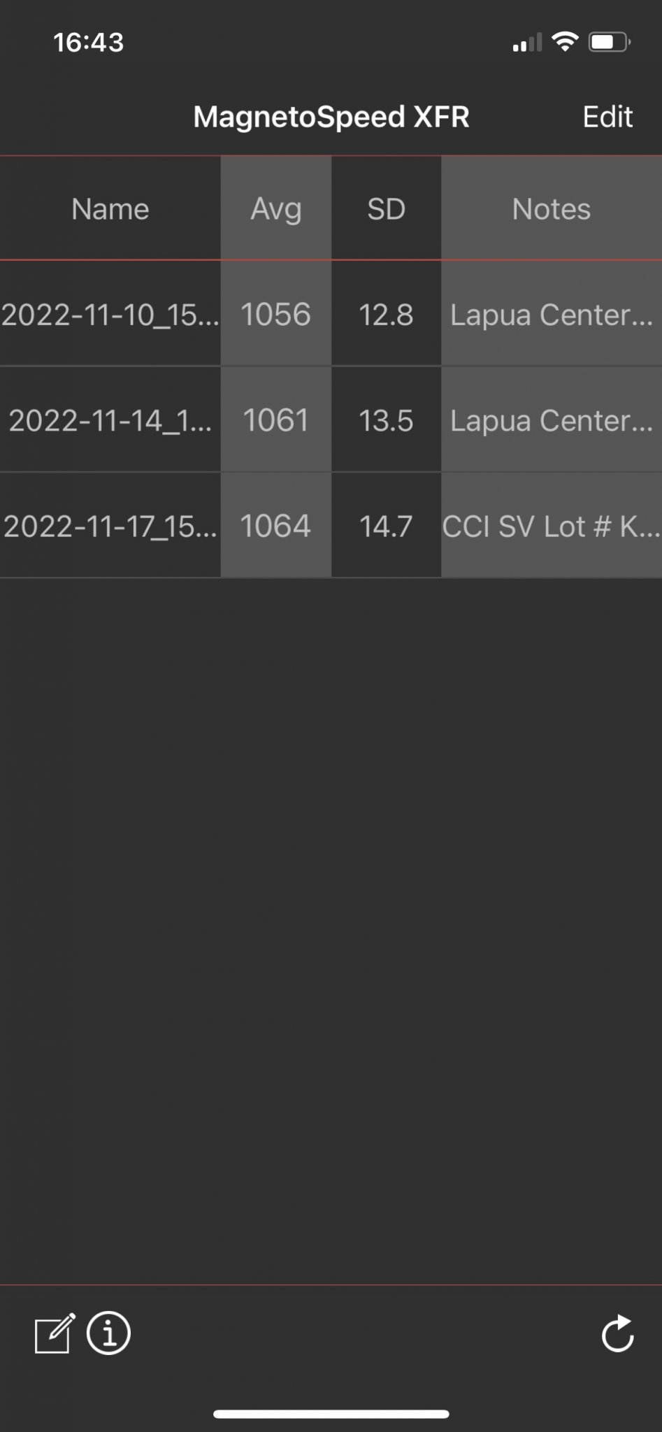

These are my go to ammo choices for my T1x. In my gun they shoot to roughly same zero and I used to get 4:1 cost advantage for CCI to Center-X for practice vs match ammo.
My un-scientific testing showed that the CCI shot really well except for a random flier that sounded quite different. It’s really obvious shooting groups at 100y and that round goes way low.

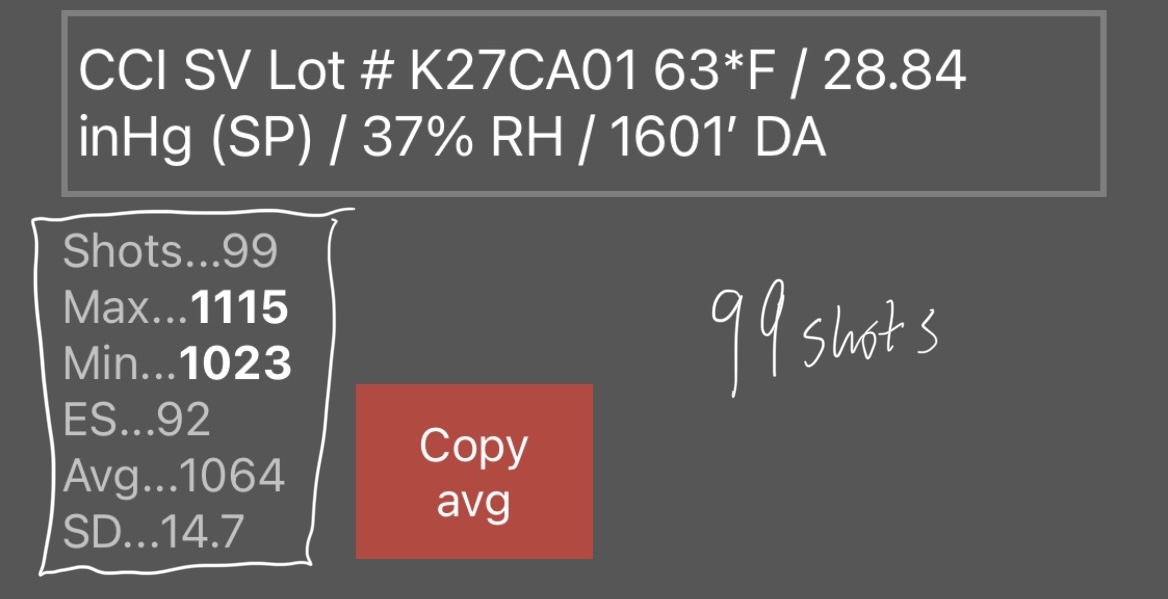

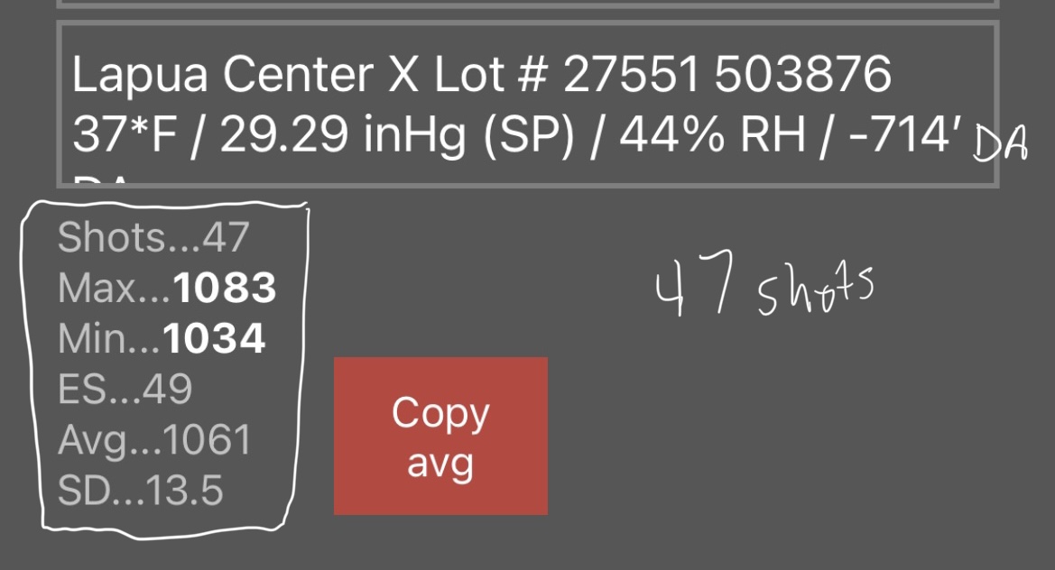

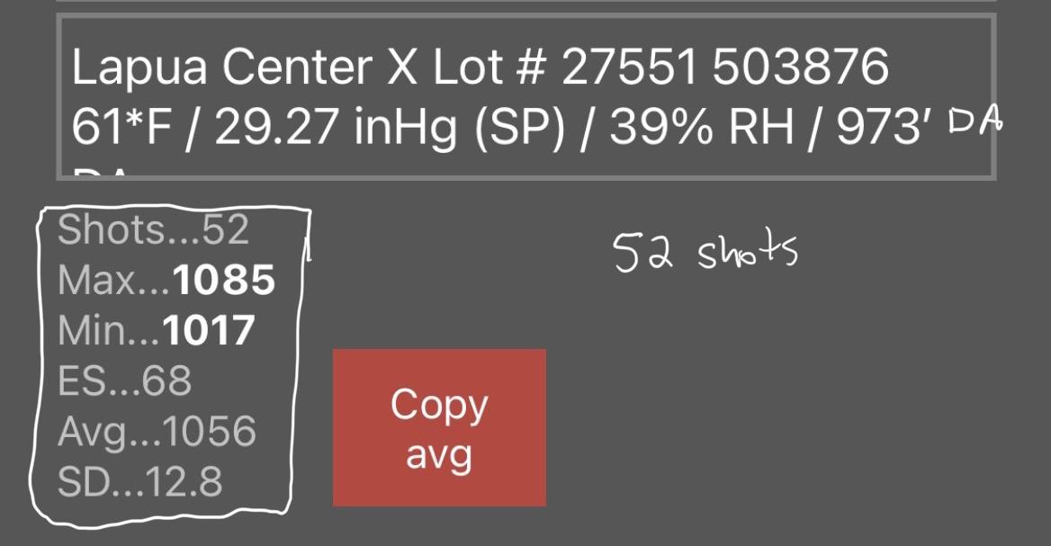

It was a test that measured one value, velocity. I expected less that 10 fps standard deviation and less that 50 fps for an extreme spread on the center x.
When I didn’t get those numbers I decided what the hell, wonder what my CCI SV is putting out to use as a baseline.
