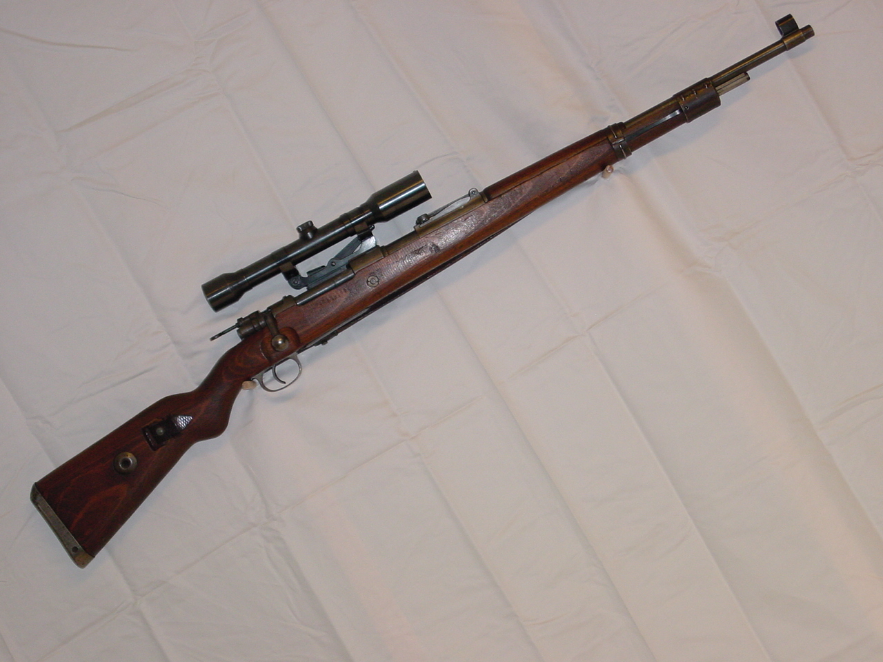

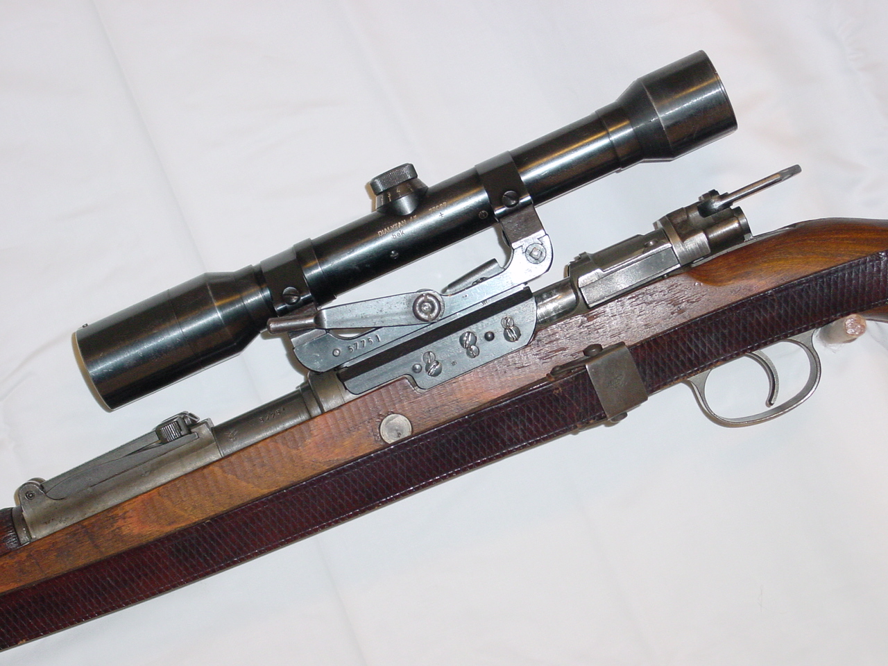

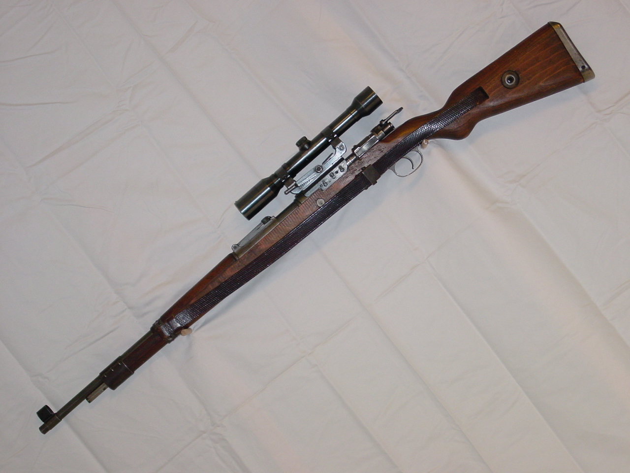

Another of many.... I am new to this forum and have collected German Mausers for nearly 40 years. This is a BCD 4 code rifle . Produced at Buchenwald, the “long side rail” was purpose built as a sniper. The receivers are like no other K98 made during the war. The receiver is oversized with a flat machined on the side for scope mounting. The safety utilizes an extended “key” unique to the model. Sanding was curtailed in the latter stages of manufacturing. This stock exhibits the corncob finish sought after by collectors.
