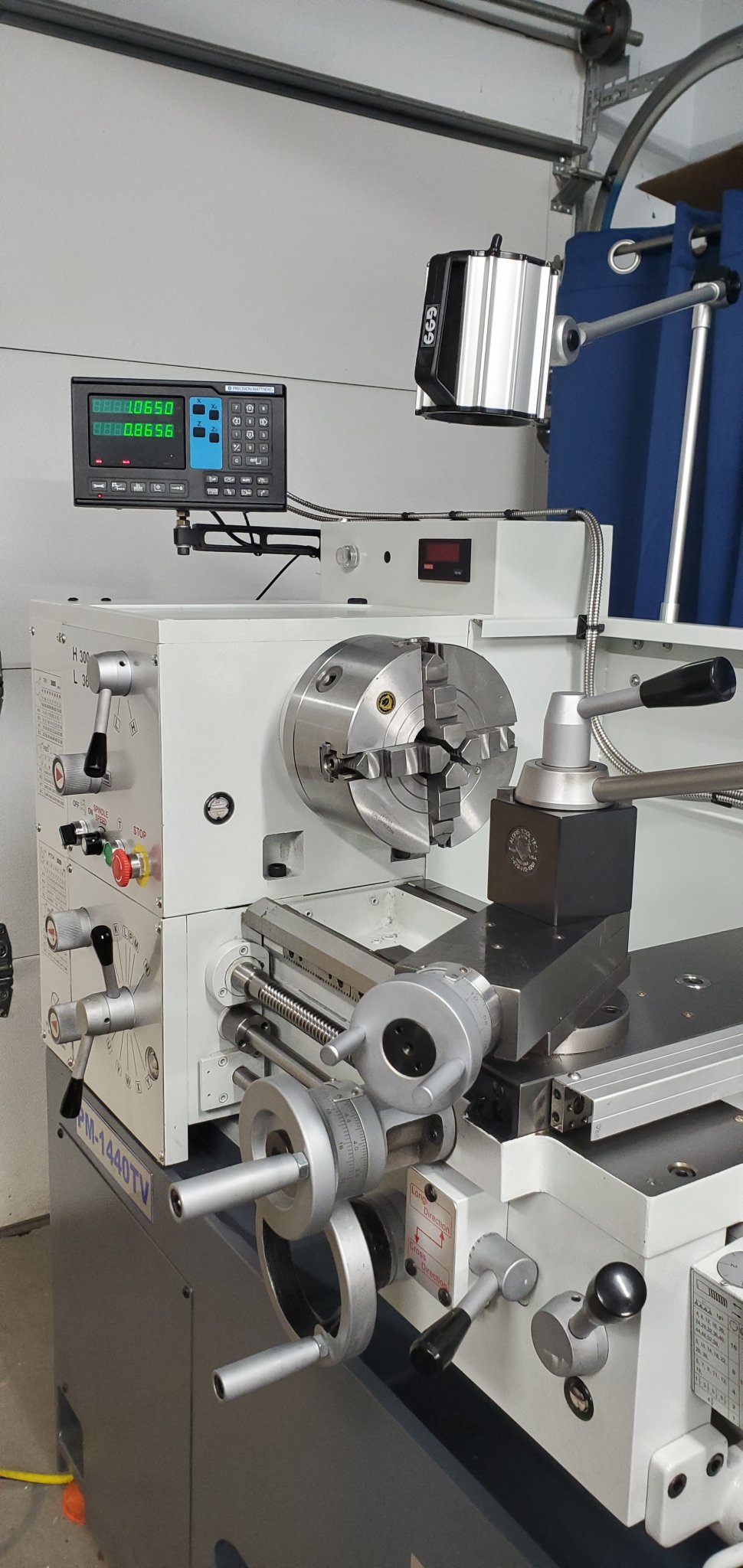

I received my special order PM1440TV from Precision Matthew's. It is Taiwan made, 5HP 3P motor, 7.5HP Yaskawa 7.5 HP VFD, 9 inch bed, one piece heavy cast iron base, DRO Pros DRO with megnetic scales, and D1-4 spindle nose.
It is rough leveled, DRO checked out,
Watch "PM1440TV Testing Cross Slide" on YouTube
