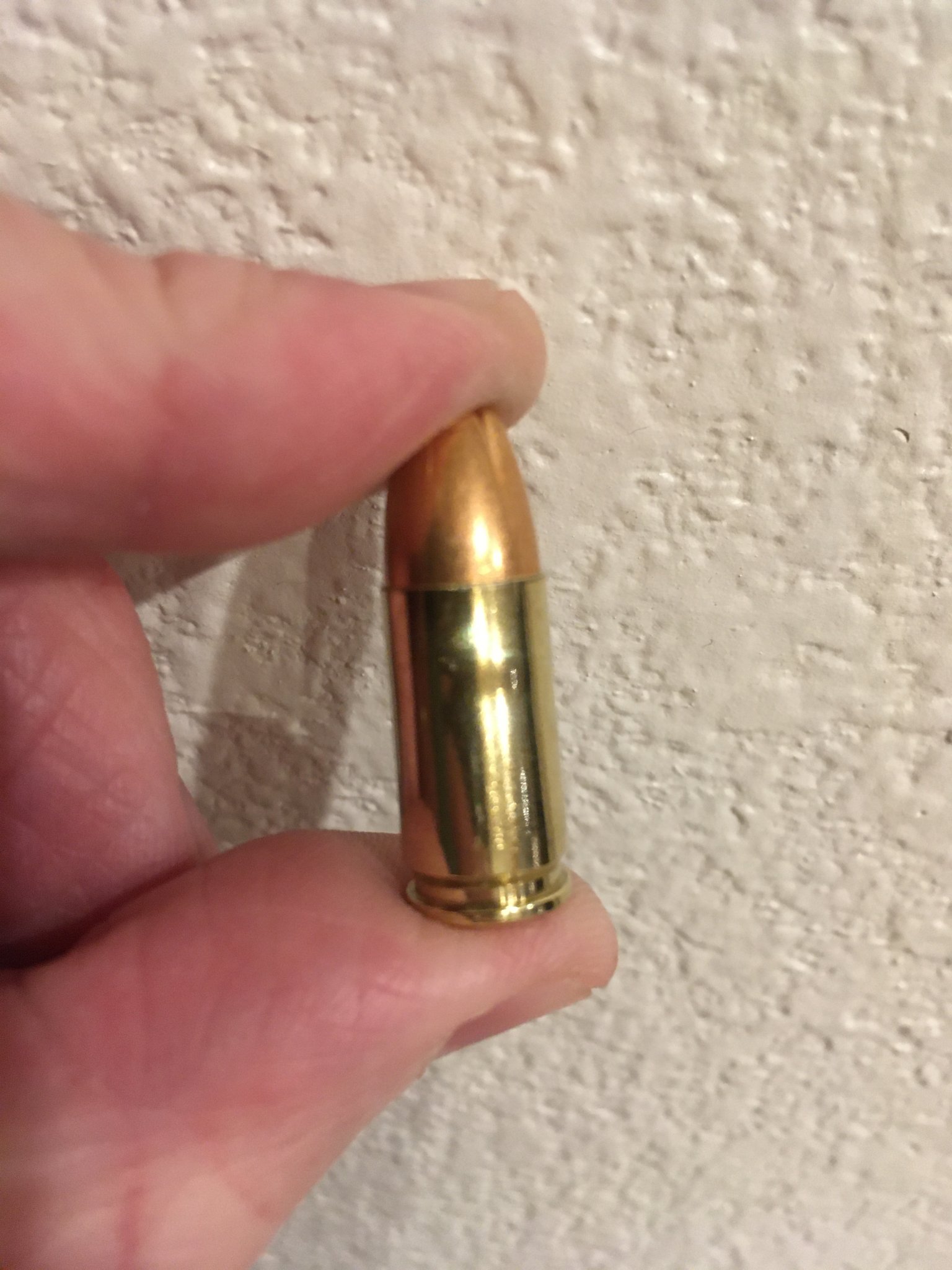

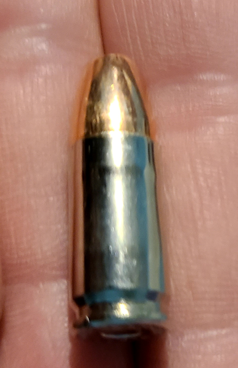

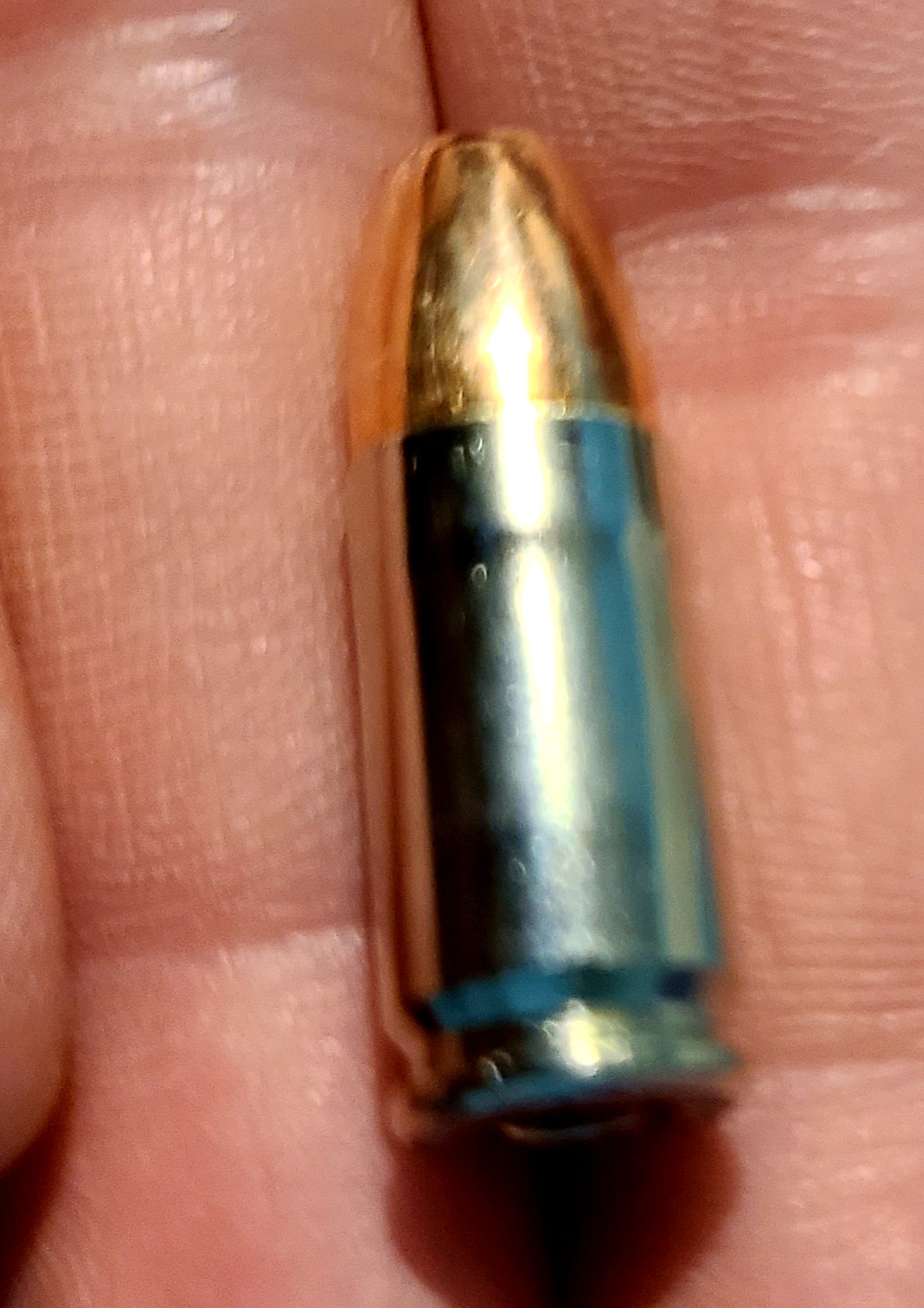

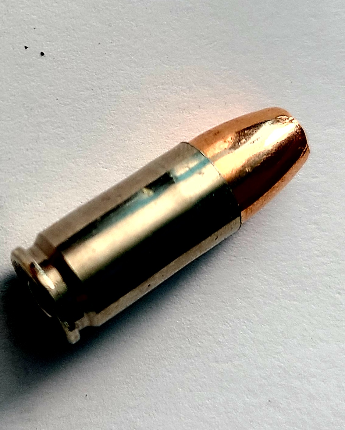

    As best as the camera allows.
    Reactions: Vamike9
    Ahhhh, now that's different.
    Although it may not effect firing & functionality, that's not normal by any stretch (pardon the pun).
    It certainly won't be doing any good to your equipment or bullets either.
    I'd send that die back, it's definitely not within spec.
    Yeah, been a long at work, couldn't post pics then.
    Thanks for the help
    Vamike9
    The bulge I see I have to hold the case up to the light & I can easily detect a bulge but, nothing close to that.
    Matter of fact, I've never seen anything like that.
    You must be seating the hell out of those loads? You poor bastard. Sorry to put you through all that although, you should've posted a pic in the 1st place.
    Regards...........Barelstroker
