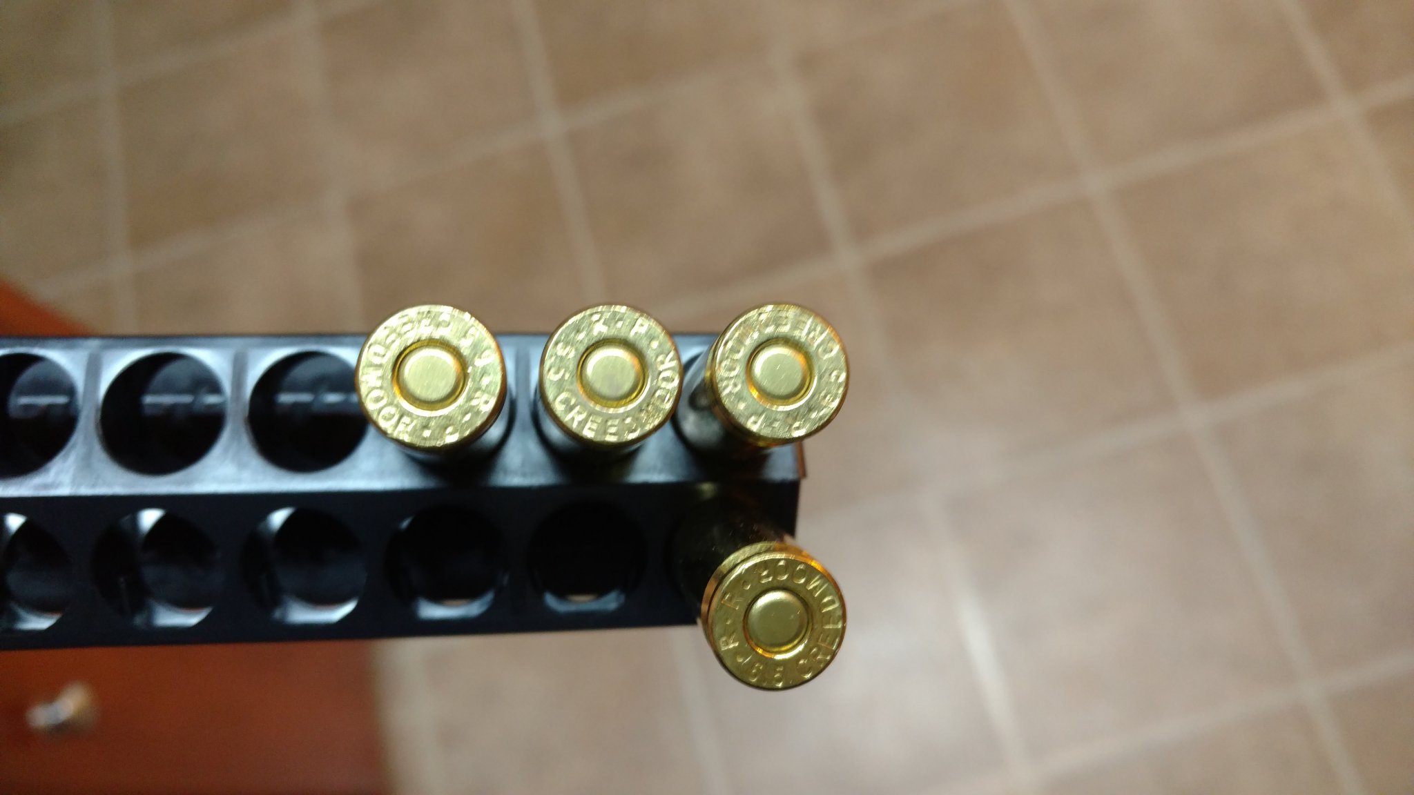

Not calling you a liar. Do you have pics of the case heads you fired?
He threw the used brass in with his other 6.5s that he's been collecting. So no telling, but he sent me a picture of what's left in the box. All the rest of the ammo is still in the magazines that I do have in my range bag.
Thanks. But that does you no good. I need to see the ones that were actually fired from your gun.
