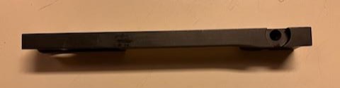

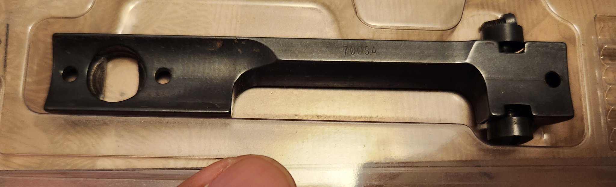

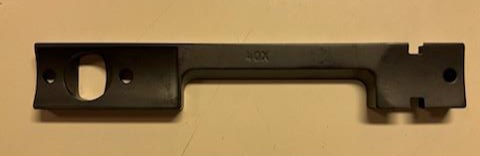

Wondering if the top base is a legit 40x base?
Definitely NOT REAL. Even the markings on both bases are wrong. I don't even think they're Redfield bases, they might be Leupold bases. Any markings on the sides of the bases? If they somehow have the Redfield "R" in crosshair on the fromt right side of the base, then someone faked the 40X marking on the bottom. If it's a Leupold base with that marking on the side, then that might be the way Leupold marked their bases on the bottom.
Just a quick glance, the markings are completely wrong for Redfield bases, the lightning cuts under the windage screws of the 40X base is wrong (shouldn't even have them), and even the direction of the milling machine marks on the rear bridge portion of the bases is completely wrong (marks should be perpendicular to the direction they're going on the bases in the photo). Taking all of that into consideration, I don't even think that these are Redfield made bases.

I hope that you didn't pay more than $10 per base, because that's about what they're worth. Were they sold to you as actual USMC M40 bases? Please provide us with some information about the deal, if you can. The more details we have, the more we can learn about what happened and how to prevent being taken advantage of as a potential customer. This information is important to all of us.
If the dealer blatantly ripped you off and charged hundreds of dollars or thousands of dollars (real Redfield 40X bases are $2,000 each) for these base, then they should be named. There's no reason for a customer who got swindled to protect the people who ripped them off. This is a constant thing in the gun collecting community, for some reason no one ever names dealers or gunsmiths who do something wrong. People need to know this information, so they no who to trust and who to avoid. I've only seen the victim buyer protect the perpetrator dealer/gunsmith in this area of collecting. No where else does this dynamic occur, and I find it extremely strange.

From my research the windage screw slots should not be cut completely through the base.

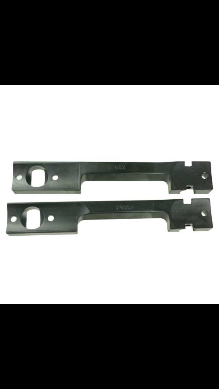

Here's a few original Redfield 40X scope bases. I've seen them blued and refinished, what's important is the markings and lack of lightening cuts. The front bridge area on the underside can have 2 or 3 different types of milling (2 different milling types in this photo). Look at the direction of the machine marks on the middle base (with the original bluing), the marks around the 40X marking are perpendicular to the directions of the straight lines of the base. Hopefully that makes sense, but it's a feature to look for.
Also notice the specific font and size of the 40X stamp and the closed top of the 4. The 40X stamps on these real bases are smaller than the 40X on the base in question. The size and font of the 40X stamp is the very first thing thst I look at, and that can immediately tell me if the base is legit or not. Again, these are all very important features, and they should all be taken into consideration. Compare these features to the top base in the first post, and you can see that whatever that base is, it's not correct.

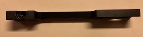

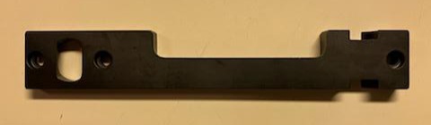

@fe1 just texted me some photos of the scope base he received, I can confirm that it's a fake. There's at least 5 things wrong with it:
● Wrong 40X stamp font
● Wrong 40X stamp size
● No Redfield "R" stamp
● Wrong machining marks
● Shouldn't have the lightening cuts under the windage screws
@fe1 is going to reach out to this company via email this weekend, and we'll see how the company handles this issue next week when they return from the long weekend. We're not naming this company right now, but they will be publicly named as soon as @fe1 receives an email response from them, which we'll also publish. Customer relations can make or break a company (as with selling fake parts in the first place), so we're interested in seeing how they respond.

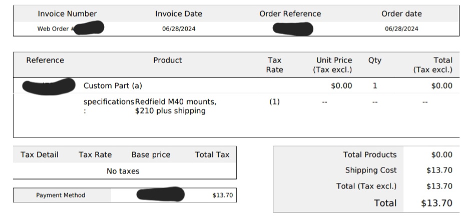

It's disgusting that something like this can happen, and this base is a blatant fake. As you can see by the invoice, the company claimed that it's real. The base isn't even marked with a company name or initial, which is also very strange. I wonder if this is a newly made fake just to sell to M40 collectors/clone builders.
Remember, I have published a lot of high quality photos and detailed descriptions about real USMC M40 Redfield 40X take-off scope bases and other M40 parts. Please use these reference threads to determine if a part that's for sale is legitimate. If you need to talk to me for further verification, please feel free to message me at anytime, I'm more than happy to help out anyone in our community! Right now I'm doing my best to help @fe1 with this fake base, and hopefully he'll receive a full refund. I'm going to look through my collection and see if there's anything useful that I can send him to use with his M40 clone build.
Here's the fake 40X scope base (photos received today from @fe1):

AS the invoice says, they are NOT M40 bases. Even though the style looks like it.

Dude, what are you even talking about?! The invoice straight up says that this is a "Redfield M40 mounts." Additionally, the owner of the company that sold @fe1 this scope base told him on the phone, and in emails, that this was a 100% original Redfield 40X scope base that was used on the 1966 era USMC M40's. The people from the company swore up and down in phone calls and emails that it was an original USMC M40 base. They are wrong! This is not an original USMC M40 Redfield 40X base, they flat out lied about it or are so incredibly ignorant that they don't know what a real issued USMC M40 Redfield 40X scope base is.
In one of the emails, the owner of the company writes, "I have everything original and also new parts for every Remington Military Rifle made between 1965 and today." So, to recap, the company owner himself told @fe1 on the phone that he was buying an original USMC M40 Redfield 40X scope base, and he even said in an email message that he has original Remington military rifle parts going back to 1965, which is one year before Remington built and delivered the 700 M40 sniper rifles to the Marine Corps. @fe1 was under the complete assumption that he was buying a real USMC M40 Redfield 40X scope base, and what he received was a fake. It's that fucking clear cut.
The OP was taken advantage of, and he was sold a fake base. There is no disputing any of this, and there's far more to it than what's on the invoice. The invoice straight up says that it's an Redfield M40 base, and that's not what @fe1 received. This isn't an M40 base, and it's not even a Redfield base! It was sold as 1 very specific item, and it turned out to be a fake. I'm not sure how to break down the situation any more than this.
