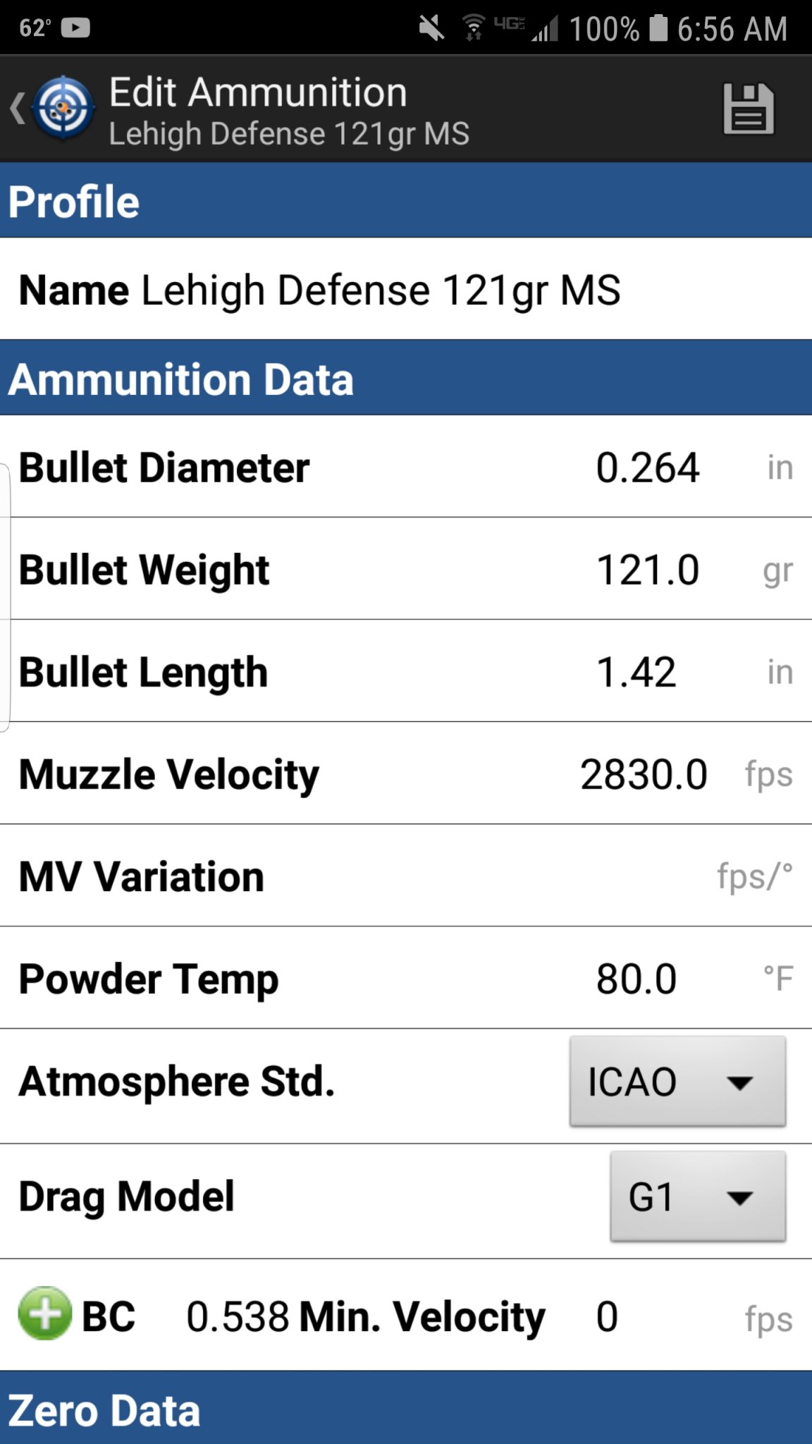

Pretty accurate. What's the G1 BC on those 121's?
Supposed to be 0.538 G1. I need to shoot them at longer ranges to confirm.
