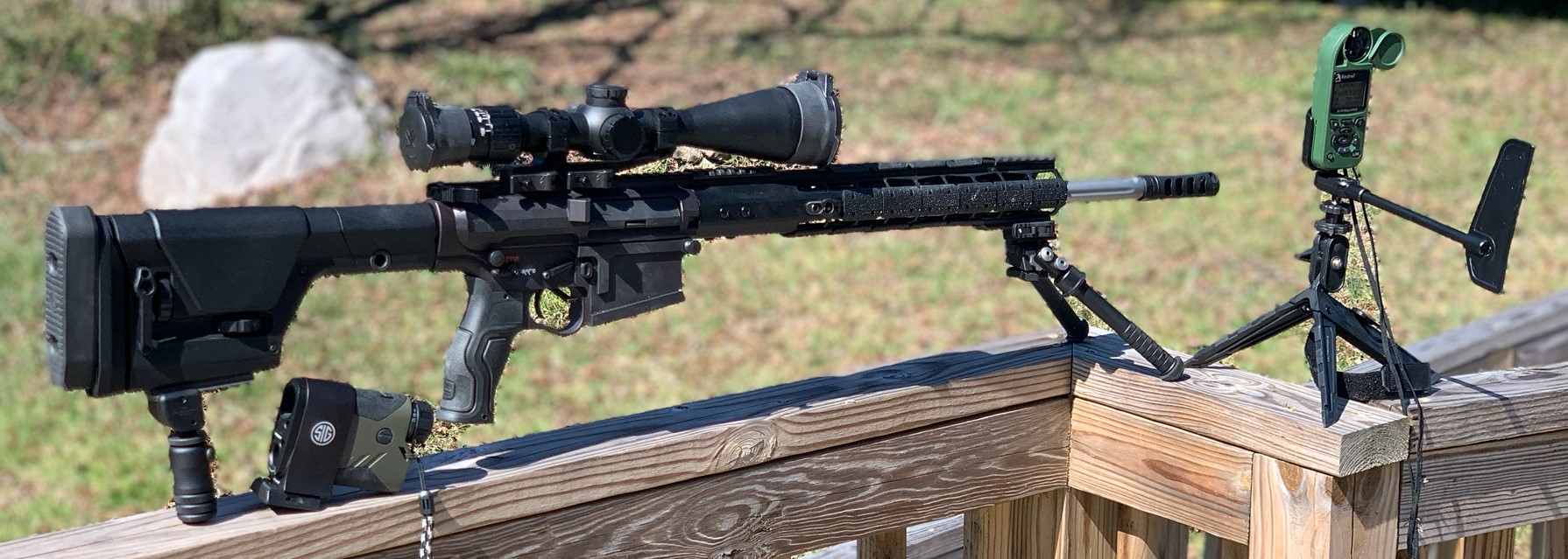

Not sure if your department would go for it but look at the Sig Sauer Rangefinder/Scope combos. I have their Sierra3BDX 6.5-20x52 mm. It is linked to their Kilo 2400BDX rangefinder. This can also be linked to a Kestrel 5700 Elite Link weather and wind meter.

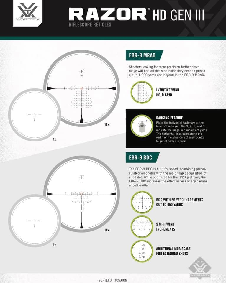

I carried a 4x ACOG in combat and never thought twice about this stuff. The reticle was always exactly the same when I needed it.
Quick question, if you don't mind, I put a 1-10 Razor HD FFP, and wondered if you thought a red dot at low mag makes up for the lack of a SFP cross hair? I don't think the pic can do the red dot brightness on this optic credit, but it's clear, bright, and easy to pick up reflexively in bright sunlight. I have never needed to put it on its brightest setting. I'm not suggesting this would be the appropriate scope for the OP, given its cost, but just wanted to facilitate the discussion in reference to your thoughts to alternatives to SFP. Is this a best of both worlds solution, or just not appropriate to the task?
I can say that I loved my ACOG, but wouldn't hesitate to carry this one if I were ever down range again.
The nightforce lit center reticle produces the result you describe. Less expensive firedot leupolds do the same. The leupold firedot is not the same tough as NF, but, I've been surprised by their holding zero on loaner pig guns. They get beat up pretty bad, and are still ticking.
One not to be named 3/75 gentleman carried a firedot leupold in Afg.
So, what you ask, can be an option.
Would depend too, on the level of skill, training, and maturity of the OP knowing he has to be a bit more careful of an optic that is thought less robust. There are a few people with a level of focus that can protect less robust equipment and keep it alive a long time.
We have to do this with lower dollar thermal sights, it can be done..
