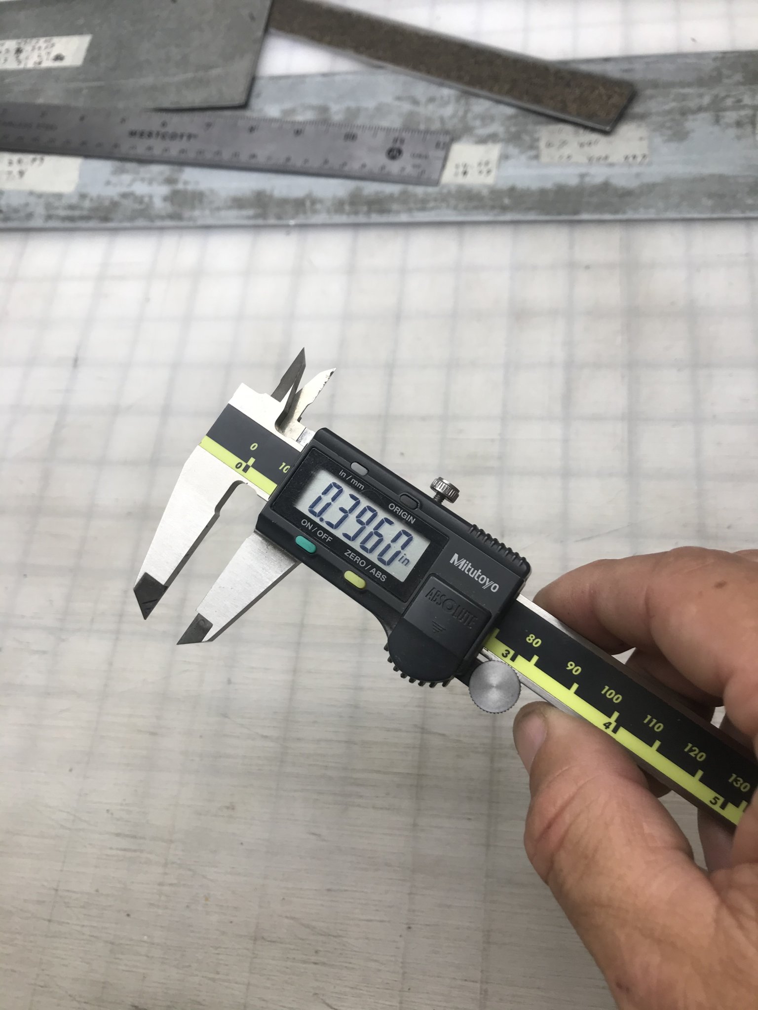

    I have the mitituyo as well.
    Just keep in mind they (like most all calipers) may not do so well as small things.

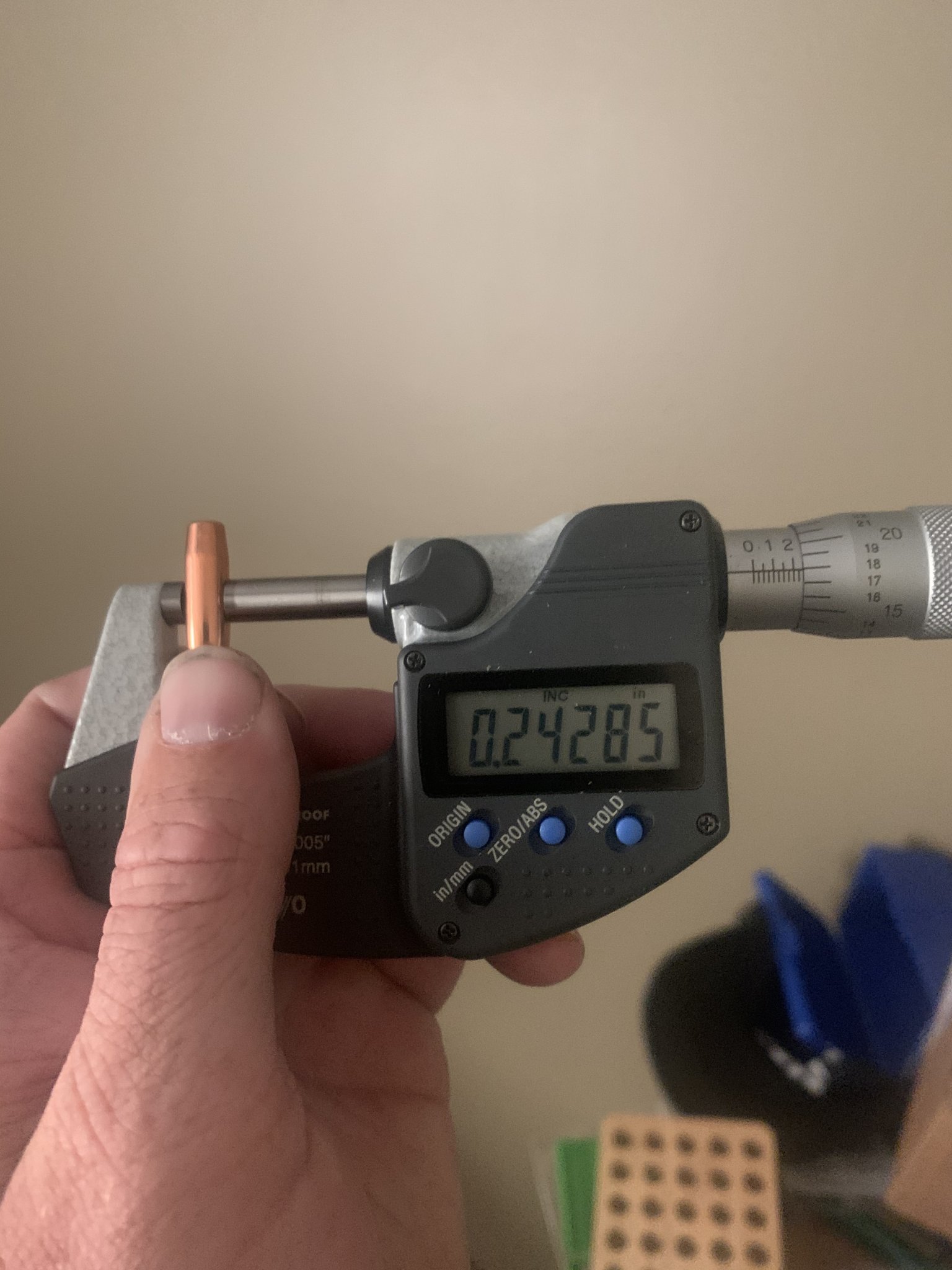

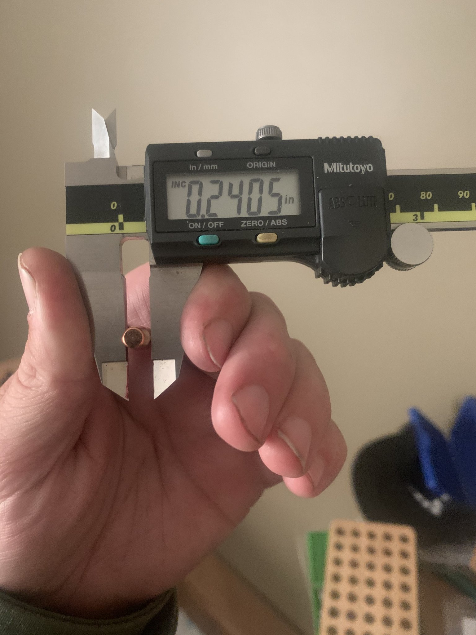

    Here is a pic with calipers and mic. This was after both were verified with a .5” gauge block. Both measured the block at .500 exactly. Then gave this measurement:
    Calipers would do the same then when measuring loaded neck diameters. Be about .002 smaller than what it is.

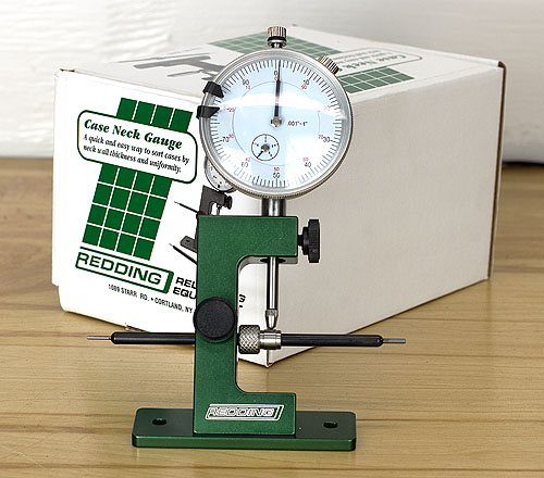

    I use a Redding Gauge for neck thickness I bought it nib off of accurateshooter, it’s serves me very well. But I’m also a neckturner, I see some guys just write it off as unnecessary, I think it’s absolutely needed for consistency. And this is a very inexpensive option that’s easy and consistent to use.
    I use a Redding Gauge for neck thickness I bought it nib off of accurateshooter, it’s serves me very well. But I’m also a neckturner, I see some guys just write it off as unnecessary, I think it’s absolutely needed for consistency. And this is a very inexpensive option that’s easy and consistent to use. View attachment 7276482

    I have a stand for mine. I might try the Redding just because I like trying different gadgets.
