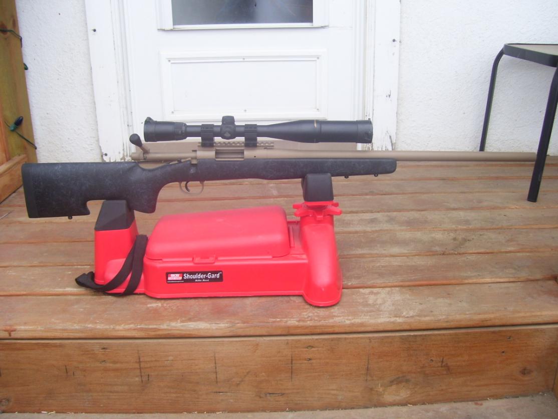

6.5 creed built by ad arms in Jamestown nd
24" bartlein 1-8 5r in sendaro contour
bc stock
timney trigger
now has a vortex 6-24x50 hs ffp with xlr reticle instead of the buck master
cant wait for the pdogs to get out

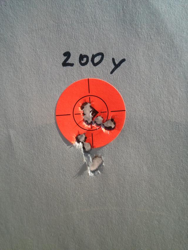

Started life as a Rem700 SPS Tact in .308. Just had the action trued and Krieger barrel chambered in .260 and installed by NW Actionworks. Only has 130ish rounds through it, 142SMK's at 2820 FPS, and has proven to be plenty accurate from 100-1300 yards thus far. Absolutely zero complaints.

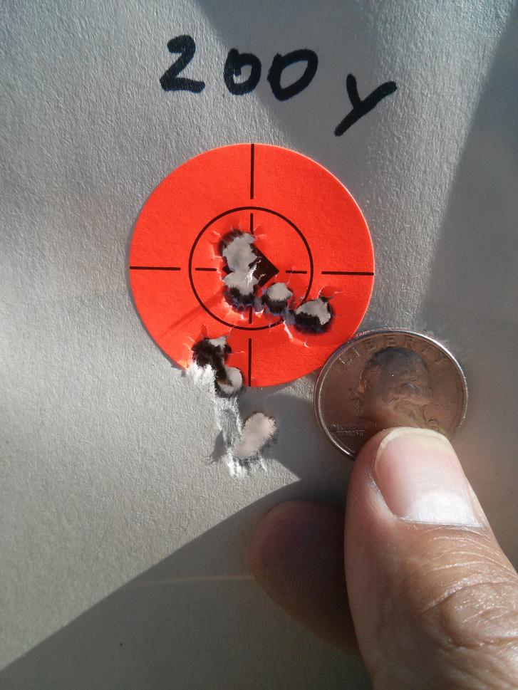

5 shot group last night.

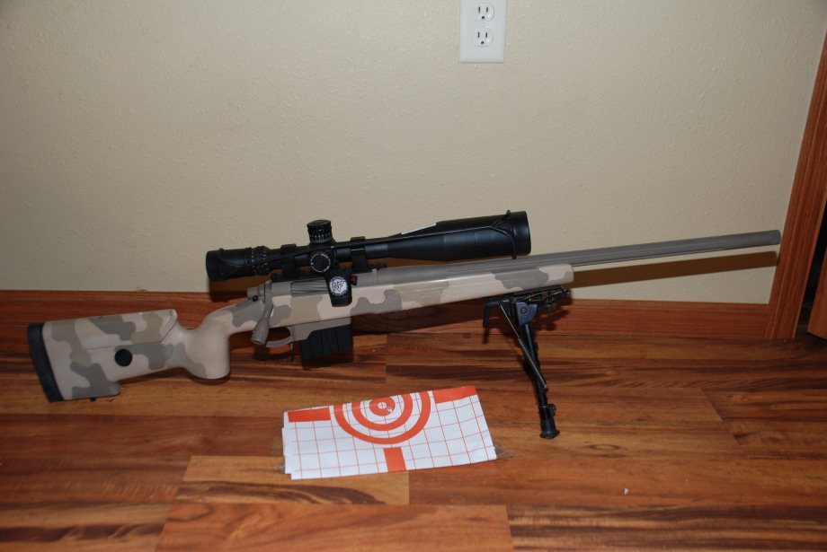

Heres my contribution.im using two diff stock at the moment and i think will be for sale soon:)
Aics 2.0/ MCM A5 soposed to be 35 gray 35 white 30 black
(Look like 60 gray 20 white 10 black lol)
Put togethr by randy R&D precision
Phoenix action rem 700 clone(takes aics or aw)
24" bartlein MTU 1"8
Seekins oversize lug
Jewell trigger
Flueted tub bolt
Badger knob
Stealth m5
Harris sbrm
nf ring and nf 8-32x56 R1
Surg base 20moa

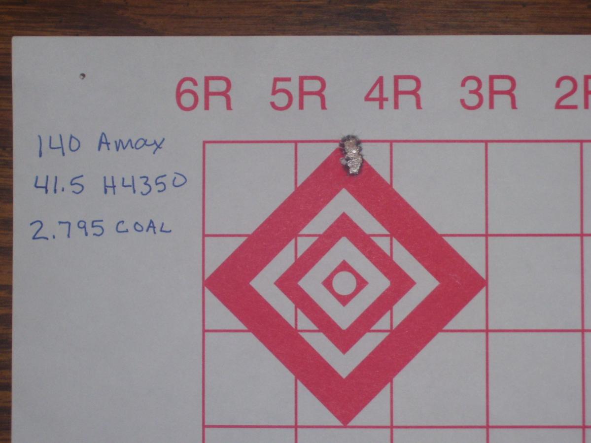

After switching from chassis to A5 heres her first try to 500yd 1 3/8" group 5shot Center to center.(can someone pls tell me what moa is that)

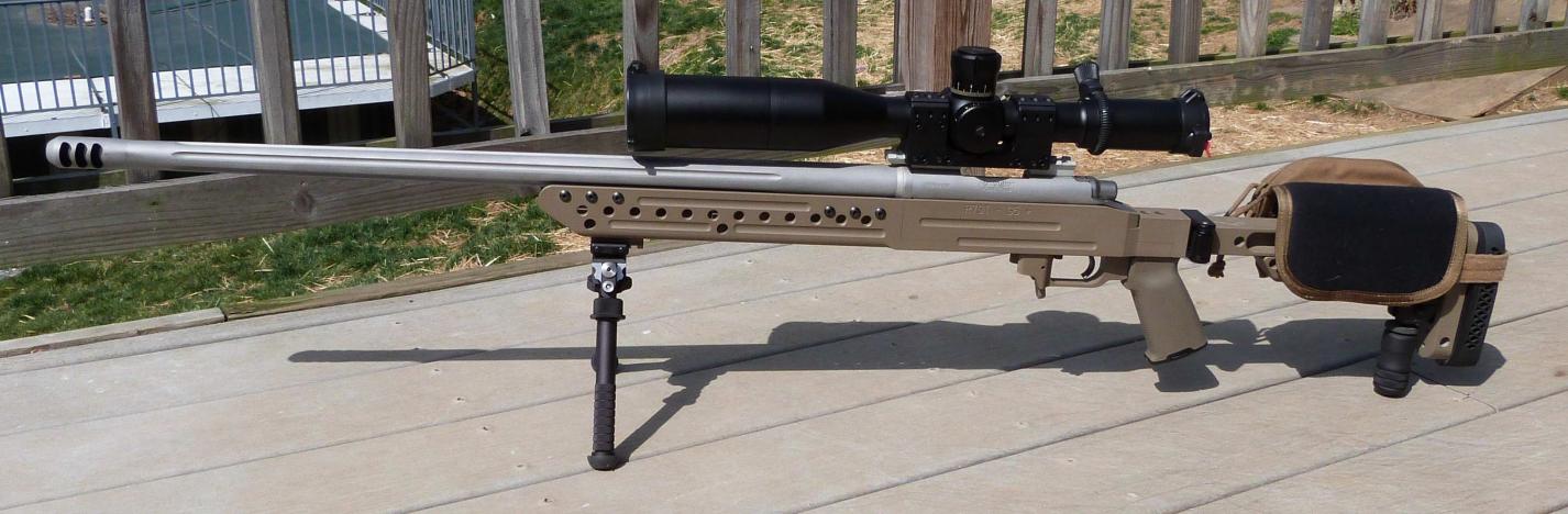

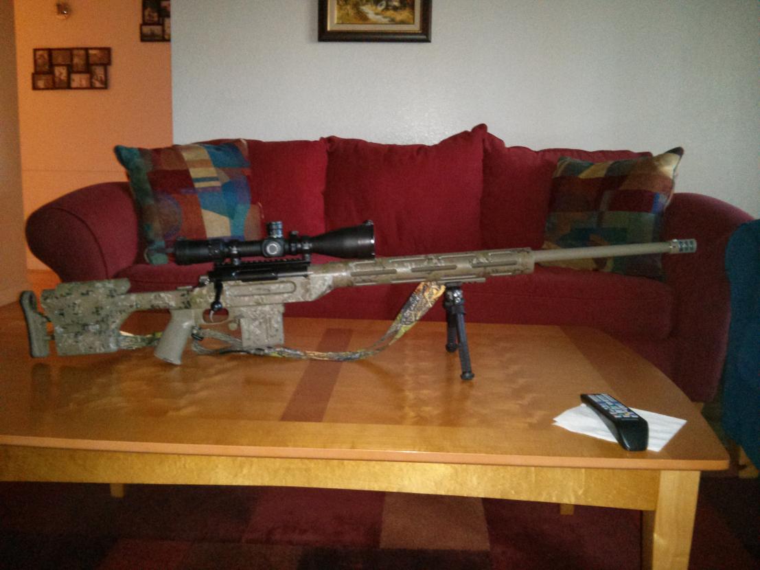

Caliber: .260Rem
Action: Surgeon 591R
Barrel: 26" 1:8 Bartlein MTU threaded 5/8" x 24 tpi;Now on barrel #2 M24 Contour still 26" w/ JEC Muzzle Brake
Stock: KMW SENTINEL w/ I.M.B., LOP spacer system, Logger Head adjustable cheek peice
Bottom Metal: KMW
Bolt Knob: KMW Gen2
Trigger: Jewell set to 2#
Rings: Seekins 34mm 1.00" High
Optic: S&B 5-25x56 PM II Gen2 XR retical with CCW 0.1 MIL turrets; Now with S&B 5-25x56 PM II MTC CCW 0.1 MIL turrets and MSR Reticle
Bipod: ATLAS with QD
Sling: TAB Gear (not pictured)
Cerakote Flat Black

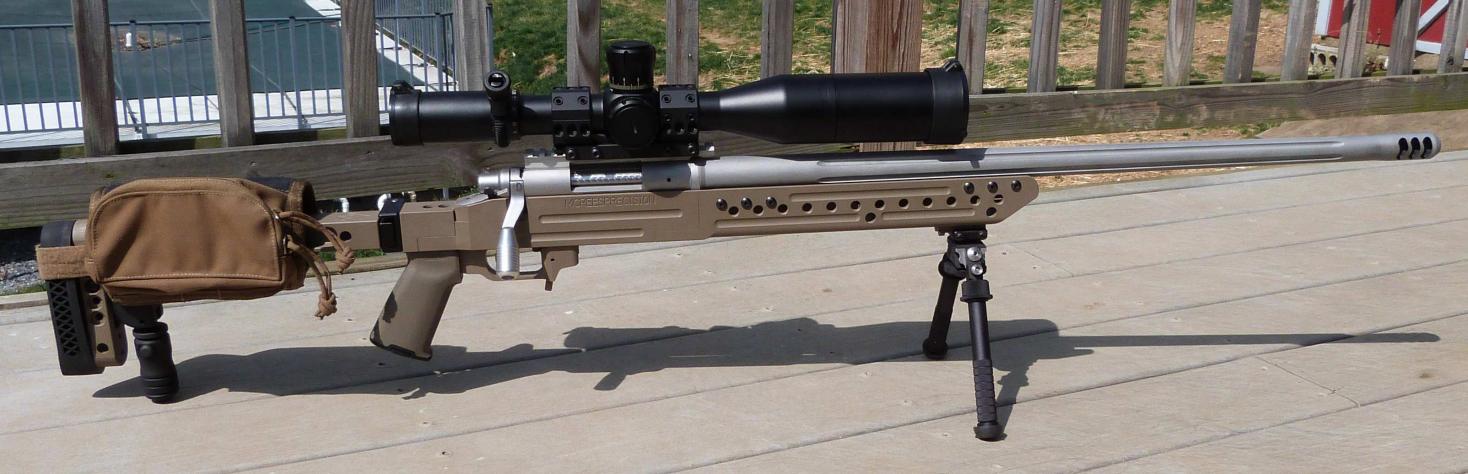

My .260 on the cheap build
On the cheap with some used parts and my own labor
McRees chassis with Atlas bipod and monopod, MOE+ grip, and McRees stock pack
Remington 700 action with PTG .300 recoil lug and Brux 24" M40 profile barrel with Little Jimmy brake. I bought the low round count used barrel from a Hide member and headspaced it by making a spacer to fit the gap left by it being fitted prior to a Defiance action then glass beaded the barreled action
Timney 510 set to 1.75 lbs.
EGW 0 MOA rail pinned and oversize (#8-40) screws
Home brewed bolt knob
XRS in a Spuhr 13 mil ISMS with cheapskate switchview
Haven't had a chance to run a ladder and work up a load yet but so far it is the most accurate rifle I've ever shot.
