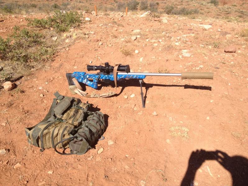

Lets see if the attachment thing works (Pic from the OPPS Shoot for the Green, 2nd pic from another match last year)
260
Stiller Tac 30
Brux Barrel 1-8.5 M40 Contour at 25" Screwed on by Chad DIxon
KMW Sentinel Stock (30% Red, 30% White, 30% Blue = Merica!!)
TBAC 30P1 Suppressor
Steiner 5-25
Atlas
TIS sling
CG Jackson Trigger
Have just over 1200 rounds on barrel. It has NEVER been cleaned. Shoots better every time I take it out.

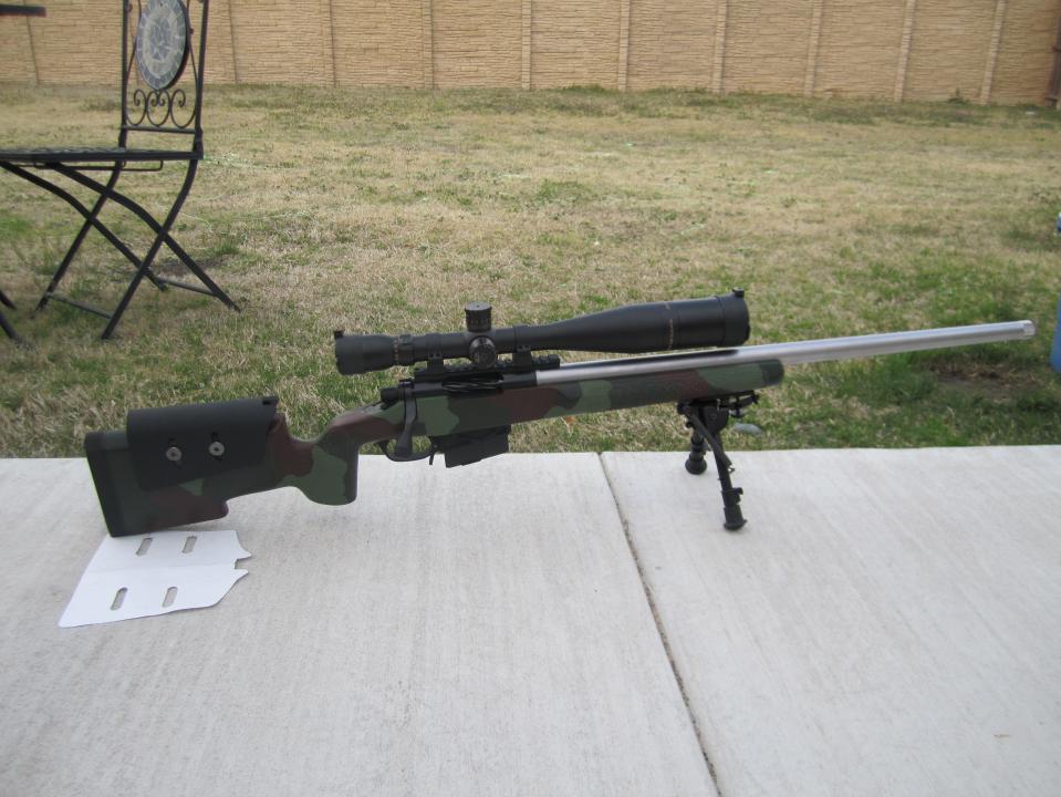

So there has been A LOT of Great .260 Rem and 6.5 Creedmoor Builds lately. I've been searching for a dedicated Picture/Build thread but didn't find one, so I'm hoping we can start one. With Pictures/Specs/Builder/Load Info if possible.
Here's mine.
This was my First Ever Bolt Action Rifle started life as a Remington 700 Short Action SPS Sporter Pencil Barrel .308.
Specs Are:
Remington .260 Shilen Select Match Barrel 24" Fluted 1 in 8 Twist
Bushnell HDMR 3.5-21x50mm G2DMR Ret (First Gen 5 Mil/Rev)
Seekins Precision 34mm Low Rings
Weaver Tactical 20MOA Base
Factory Tuned Trigger
Choate Tactical Stock with Adjustable Length of Pull
(Fully Bedded the Entire Length/Fore end all the way down the Barrel Channel) Also Replaced the Sling Swivel with QD Cups to use TAB Gear Sling with QD Connect, this is actually the closest stock I can find that "feels" like my TRG22 Stock which I like a lot.
Badger Bottom Metal Cerakoted OD Green with 10 round Alpha Mags
KRG Bolt Lift in OD Green to match the Bottom Metal.
Harris S 6-9 Bipod to finish off.
Here's some Pics, Let's see Yours!
I just recently getting into Reloading so I don't have a load cooked up for it yet. But with Black Hills and Lapua 142 Match Ammo Her best group was .371, so far less than 300 Rounds down the tube.
Is the bbl free floated? Wondering because of the bedding.
Yes the Barrel is still Free Floated. The Choate Stock isn't the best but I like it's ergonomics for personal reasons (Feels close to my TRG22). But to strengthen it further some material was taken out of the barrel channel then completely bedded. It is very solid and yet still very light weight compare to many high end stock/chassis.
I wanted this to be a comp gun so I made sure to keep it simple and light. It worked out pretty good and didn't cost me a arm and a leg either. Thanks!
