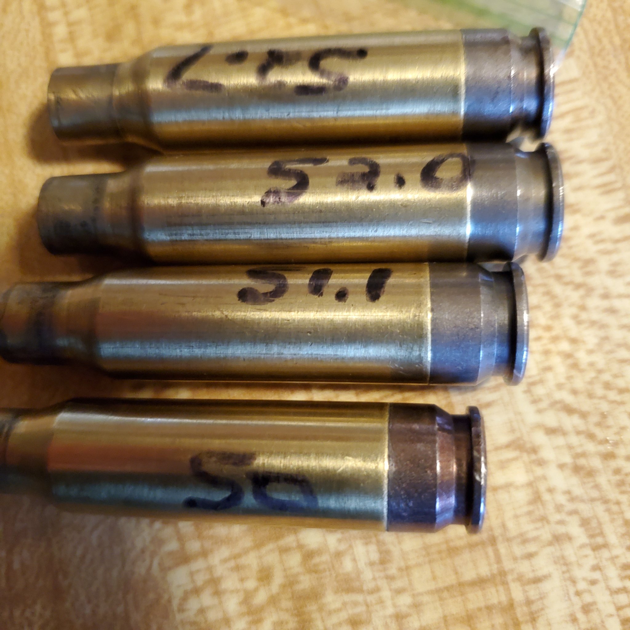

OK I'll bite, where does one find these hybrid cases? Or just tell me the metal used & I''ll whittle some out on my lathe.
Yep, military 6.8X 51 is the head stamp on the case ...civilians have the 277 Fury in 2 varieties, all brass and hybrid SS heads ...not likely that you'll whittle some out on the lathe.
But you can buy them, not always readily available, like most everything else. But they can be formed to 308, 6.5 CM, 358 win, as I have, or any 308 based cartridge, 277 length or shorter. They appear like these with the marked ladder load for the case. Yep some 308 loads contain 55 grs of powder, they have more capacity than brass cases. Live and learn...the cartridge world is changing. Better powder blends are needed to make these really go like the 277 powder used in military cases. The military is running machineguns with these 80,000 psi loads.

These cases will take more than 80,000 psi with ease... so be careful with any endevor you pursue, in the hybrid case arena.
For educational purposes only, enter at your own risk.
Definitely not a place for morons, and nothing can beat the Hornady’s "New" lines of ARC. & PRCs ..it says do on the box, and in their advertising, & ballistics hype talks, propaganda, & charts...but none of its new or improved...but the hybrid case and 80,000 psi IS...
