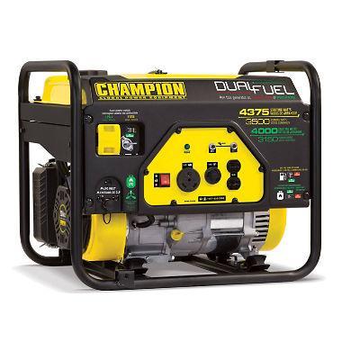

Sams club has this one which I will likely buy soon. Its a dual fuel so it will run on LP or gasoline. Since I already use LP I can just hook it up to my 200 gallon tank. Its not a lot of power but will run the Fridge, gas stone some lights and the computer. Small enough to take with you. Sams Club for $447.00
» 110 volts Appliances » 110 VOLTS Generators
Product main image
CHAMPION 100401 POWER EQUIPMENT 3500W / 4375W DUAL FUEL GENERATOR 110 VOLTS (ONLY FOR USA)
5
Champion 100401 Power Equipment 3500W / 4375W Dual Fuel Generato
Product Code: 100401 Product ID: 29928
Product sold by: samstores.com
$ 347.99
Availability: In Stock NEW

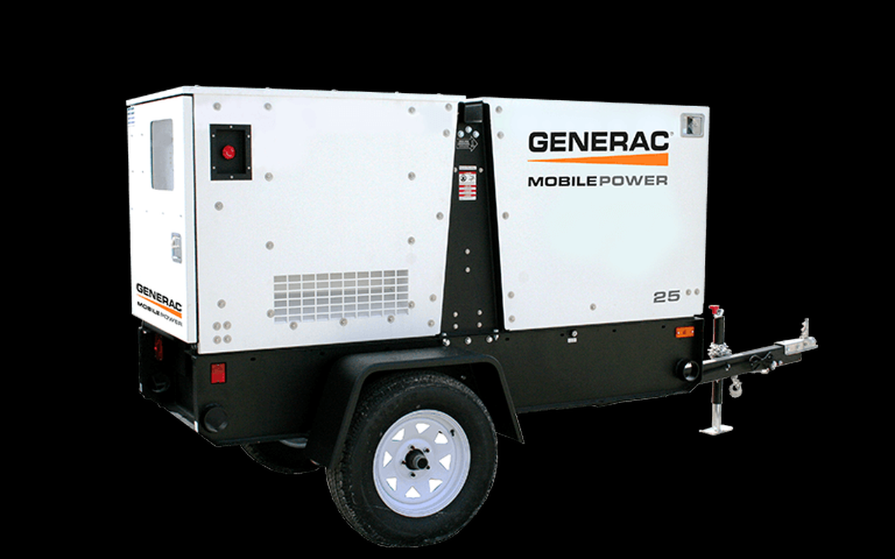

covers your house and a few others . that or you and the electric fence to keep out others. and you can move it with only a truck or car with hitch so its pretty portable .
my first though until I saw portable mentioned even though with a fork lift its pretty easy to move besides who don't like large industrial power equipment
