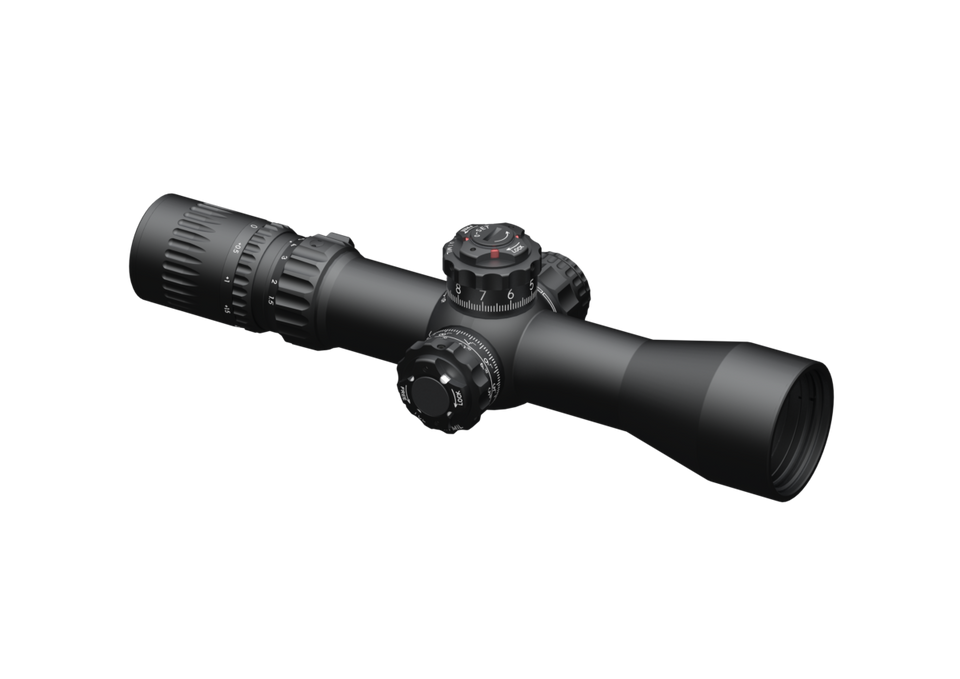

@koshkin I saw on one of your Shot Show live streams you saw a new Riton 2-12x44 than according to their website is FFP and about 24oz.
Did you spend much time with it at Shot? Doesn't sound like you were impressed with what you saw as you barely spoke about it.
I'm glad Leupy decided to listen to the market and release the 2-10. But its only going to come up short compared to what March is about to start shipping in their 1.5-15 dual focal plane with a legit tree and illumination/paralax control. The increased buy in would be worth considering if it isn't hard to get a sight picture.
From a marketing standpoint, charging a $400 premium for illumination and lack of a mil based tree is only to slow the embrace of the 2-10. That being said IMO it has lots of potential if Leopold addresses its shortcomings and keeps the final cost capped @ $2k
I realize Leupold is going to offer better reticle choices in the future but shooting yourself in the foot by bringing a half baked product to the table wasn't the right move considering the competition .
I spent some time with it and it has potential. The one they had there was sort of a late stage prototype, so there were still a couple of quirks to fix. One of the things I would prefer to see in a scope like that is an exposed elevation turret with zero stop. They position it as more of a hunting scope, I think.
