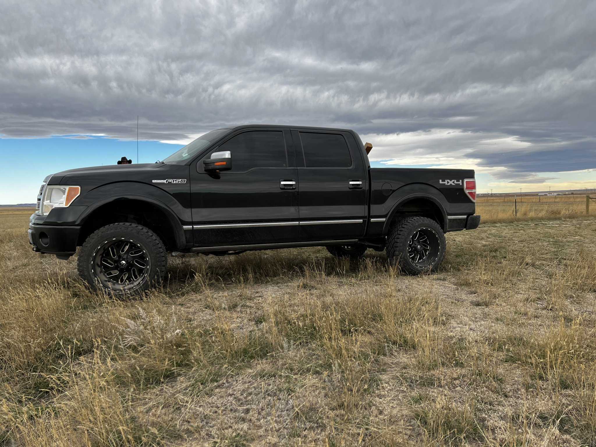

I have a 4" BDS on my platinum. It's perfect height and everything.

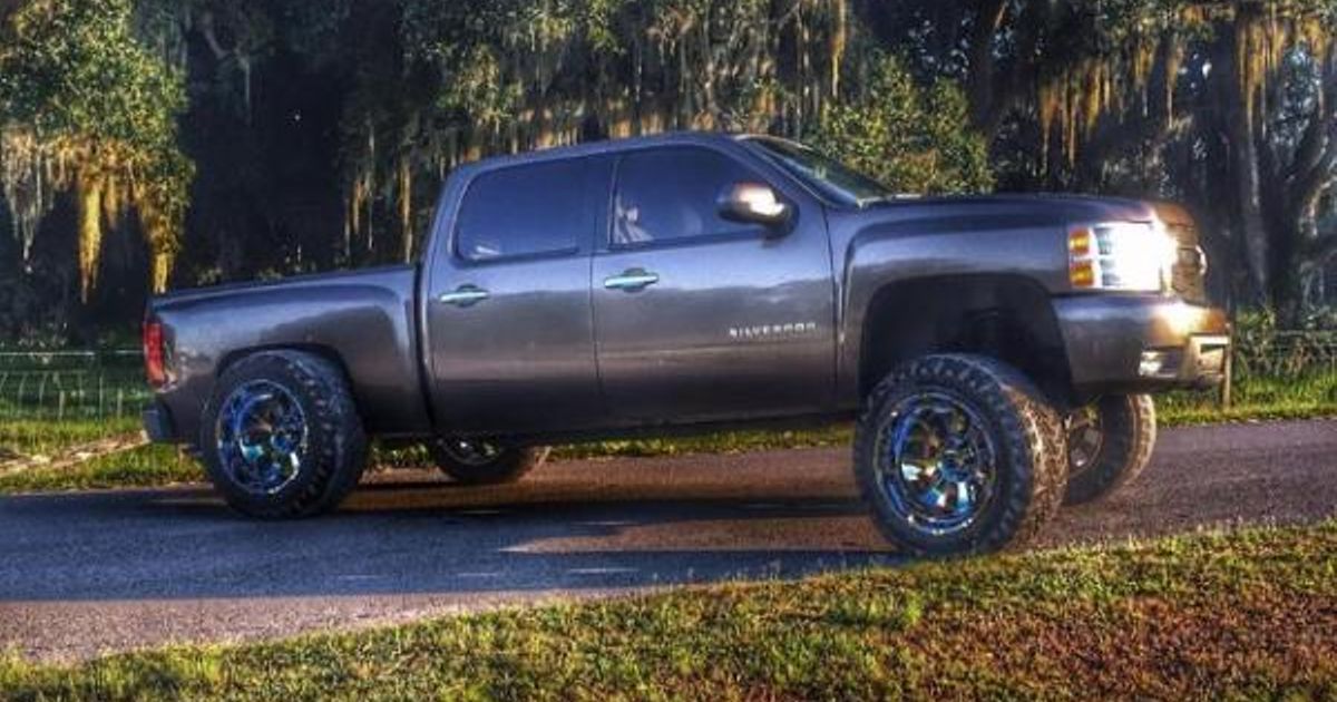

Different, but similar application. I put Bilstein 5100's on my 2011 Silverado all around. The fronts are "adjustable" height and I set them at max which was supposed to be 2.5" and should have been level. It wound up a little taller than that so I added 1" lift blocks in the rear. It looks perfect, and the shocks ride decent all around (for a truck).
That gave me clearance for the larger K02's I wanted as well.

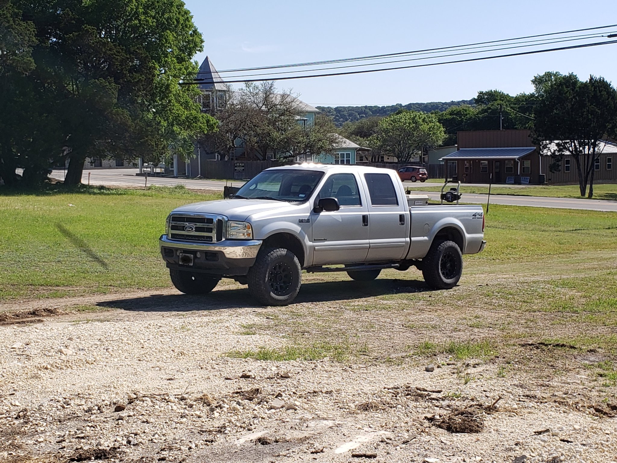

I've had two different leveled F350's. One was an 05 leveled with coil overs, the other was a 16 with readylift spacers. The ride and handling was better on the 05 with full coilover replacement. I towed a lot with both of those trucks and never had an issue. Both crew cab long bed single wheels.
Reactions: shields shtr
F-350 is a solid front axle.
F-150 has Independent control arms.
They are completely different. They work completely different. What works on a F-350 has no bearing on a 150

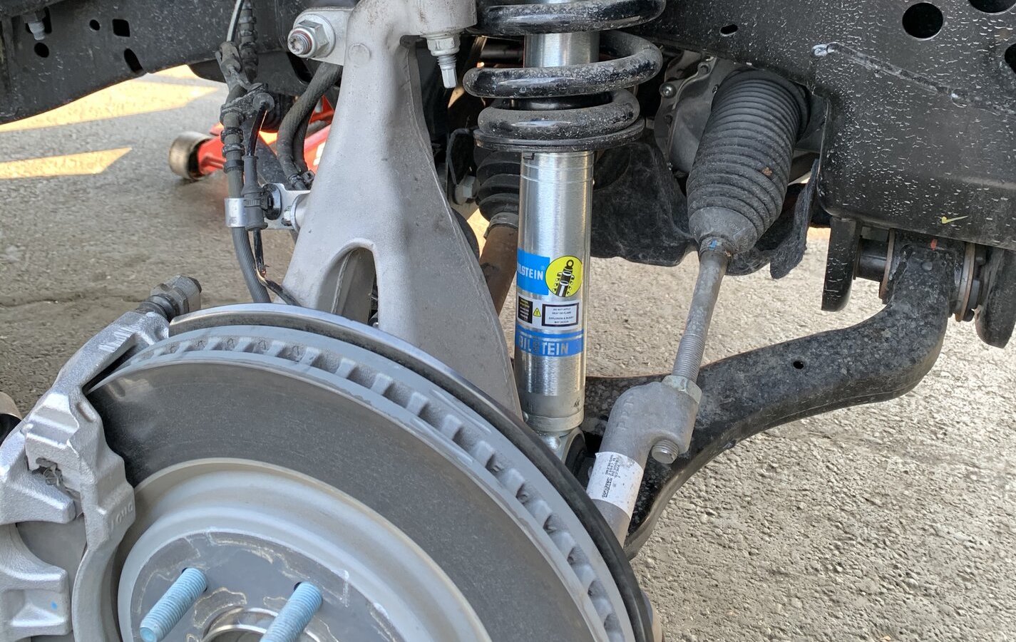

I just leveled my truck. At first I was going to put a leveling kit on my 2017 f150 but decided to get the “adjustable” shocks from bilstein.
I looked at 5100s on all four cornered but I really didn’t want to disassemble the shock/spring assembly and reassemble with the new 5100s.
I then found the bilstein 6112s that come with a new spring and shock. But you either have to reuse the old top hat and isolatoror get new ones. I got new ones for around $90 and pre assembled the spring/shock assembly. The 6112s have adjustable setting and I put it at the highest setting and it raised my front end 2”. They are way more expensive than the 5100s but the ride is great. No need for new ucas with this setup.
There is even a vendor that sells the 6112s pre assembled so all you got to do it’s stab’em. Shock surplus I think.
It took me around 3.5hrs to do both front shock/spring assemblies. The first side was slow as I was figuring out exactly how to do it and the second side took 45min. A trip to the shop for an alignment and done. I put bilstein 5160s in the rear and that took all but 20min for the install.

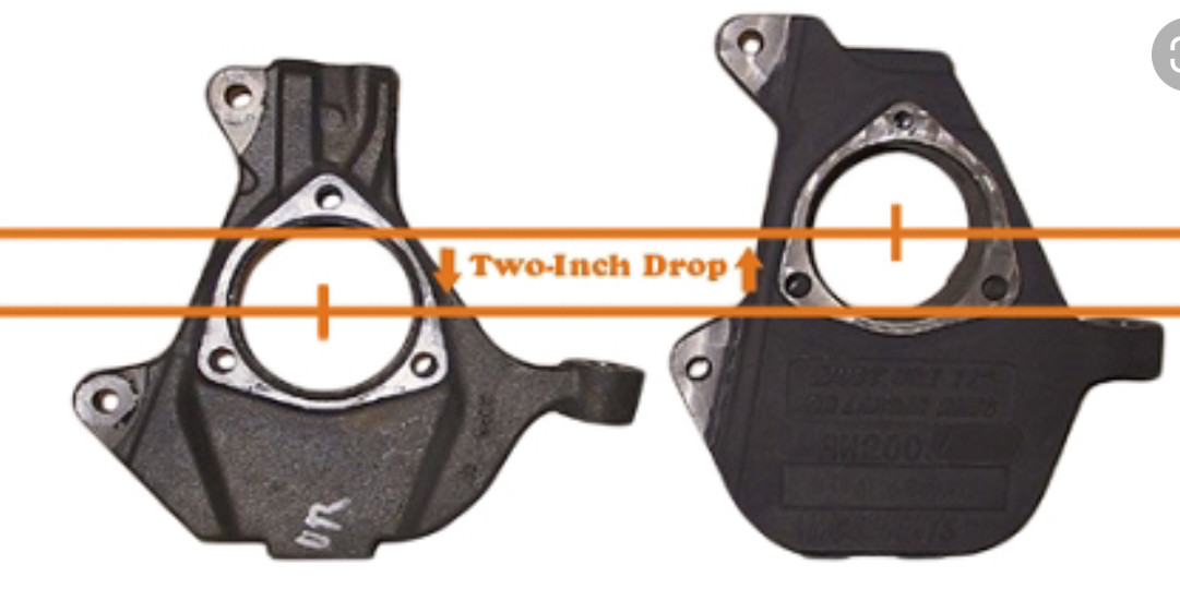

Spindles move the wheel bearings position, without changing suspension geometry.
Blocks move the suspension angle. Adjustable coil overs(as a drastic adjustment) do the same. This sacrifices handling, longevity and comfort.
Imo use the spindles for the drastic ride height change, then fine tune with the adjustable coil overs. That will yeild the best results for the least $$. Block the rear axle to match the front if needed.
There are other more involved ways but this is my bare minimum suggestion.
