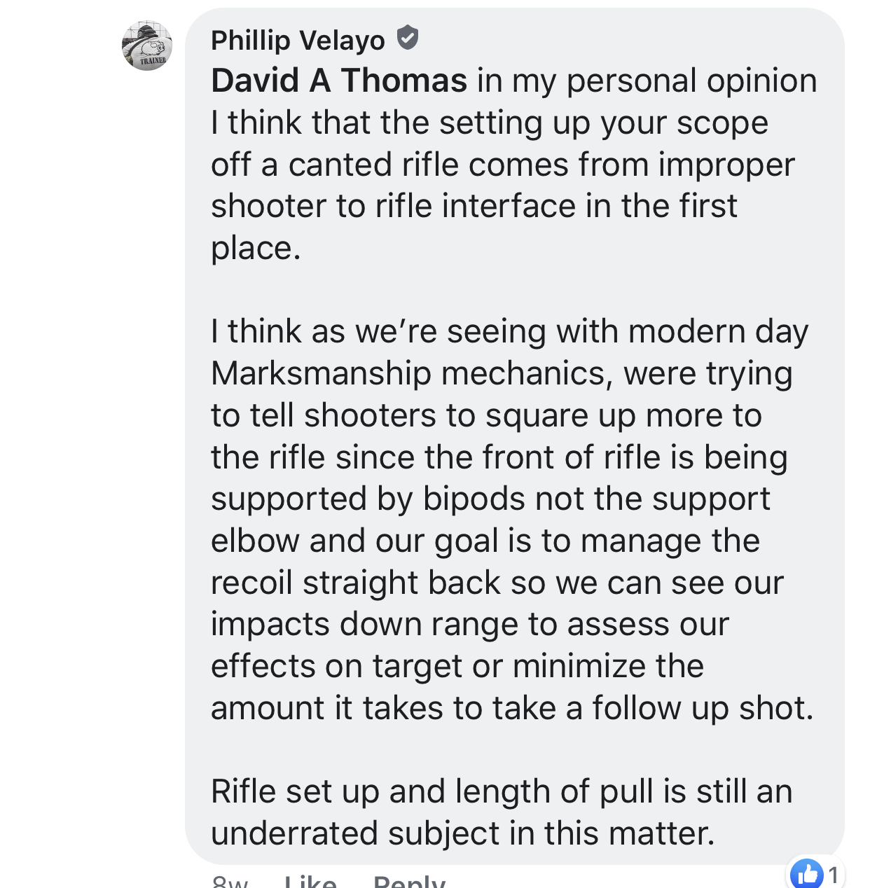

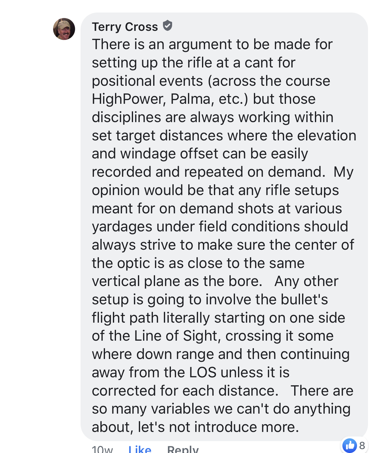

Here a couple opinions from some guys who know a thing or two.
Just food for thought.

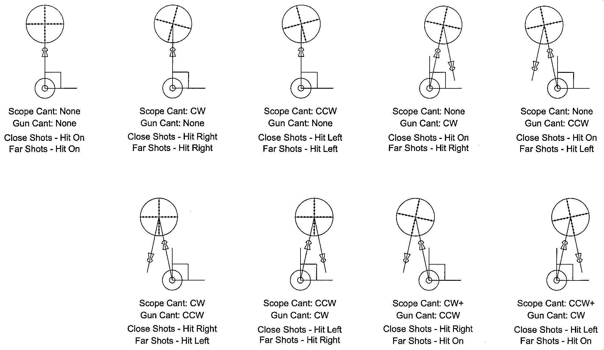

Seems guys are confusing cant with leveling the scope.
Cant is where the rifle and sight is rotated out of alignment. So counter clockwise rotation would shift POI to the left and down.... but that is not what I'm advocating here...
If the scope is level when the rifle is rotated counter clockwise 10 degrees for example the bullet will run a parallel path to the line of sight so slightly to the right that its not likely it would be noticed.... less than a scope click.
If the rifle was turned a ridiculous full 90 degrees the bullet would run a parallel path equal to the scope height.
This sums it up.
The issue here is the assumption is that when the scope was mounted it was done on a level rifle and a level reticle. If I purposely introduce a slight rifle cant then level the reticle it is the same as level rifle level reticle. Then this chart becomes valid if I deviate away from that intentional cant. As @Dthomas3523 shared opinions of @velayo_0317 and @Terry Cross i am in the same camp. It should be level rifle and level reticle. BUT, some of us have body types where maybe a small amount of intentional cant is necessary due to injury or something. But just like level/level, any deviation from cant/level, will cause shift. The offsets can be accounted for when you zero and as you gather dope as well as in your calculator if it’s worth a shit.

The only way a canted rifle shoots straight, with a scope that is plumbed to the fall of gravity, is when the reticle is perpendicular to the axis of the bore, like David Tubb has, with his special scope mount. Most mounts do not facilitate this.

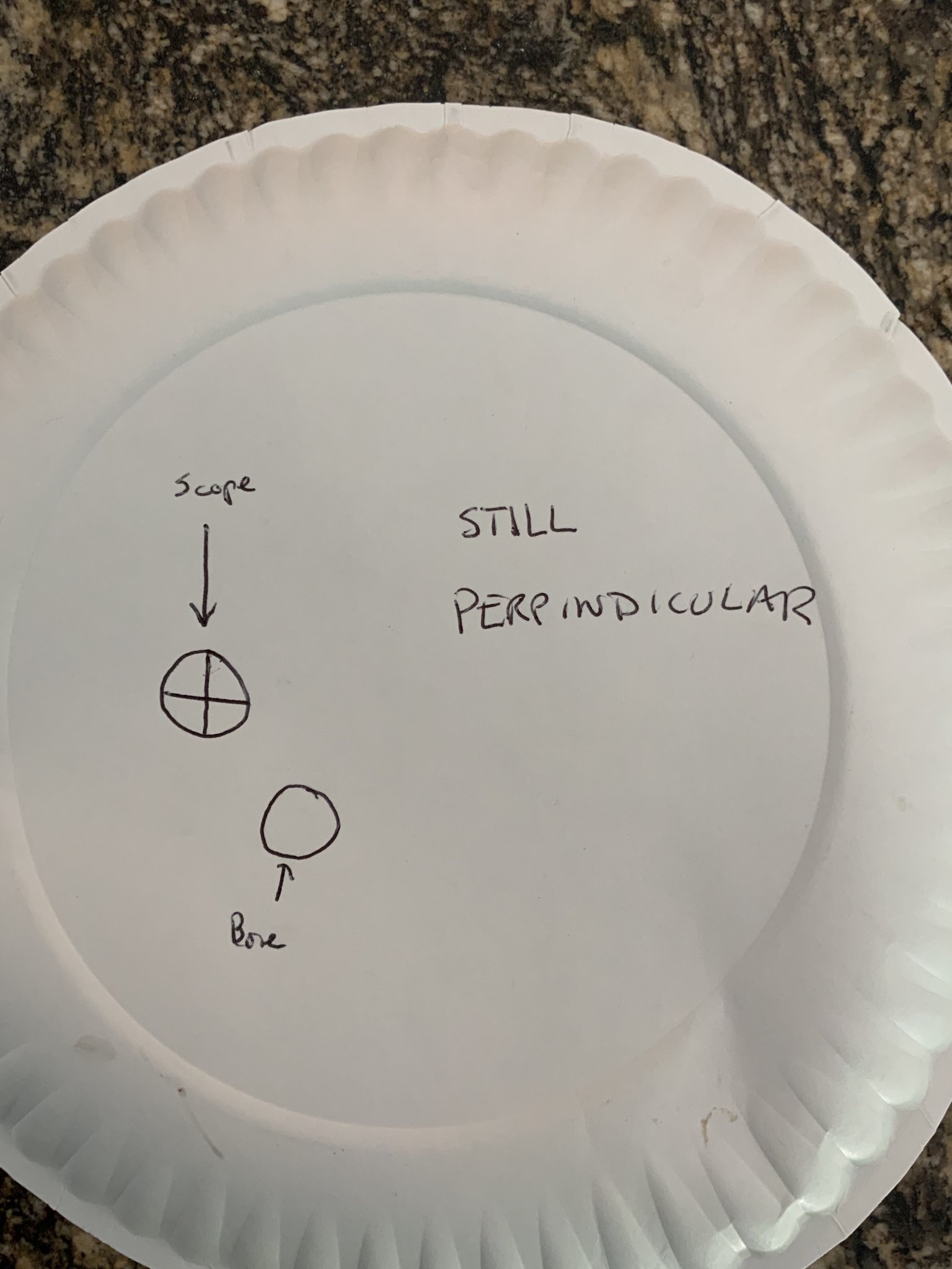

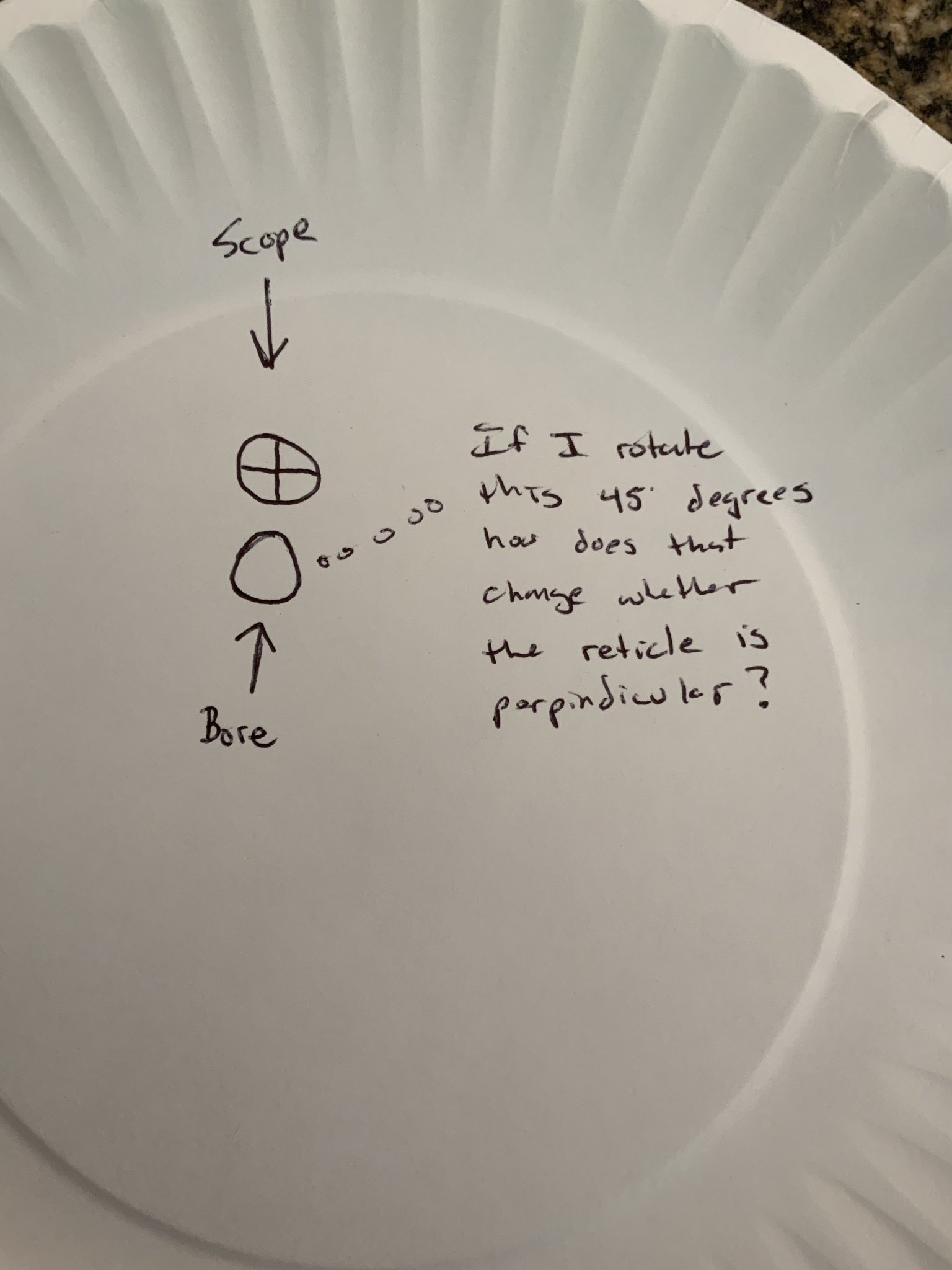

Let me ask you this. If I have a reticle that is plumb and a rifle that is canted at 45 degrees. Is that reticle not still perpendicular to the bore? What you mean is directly over the bore right?
7110075
The bullet doesn’t care where it exits. It’s still perpendicular no matter where it is.
7110076
This is outside of my knowledge base, as I level rifle and level optic to rifle, but with cant on the rifle such as in the picture, wouldn’t we have to account for the horizontal diffence in the optic’s line of sight vs the line of travel for the bullet?
I.E. we already have to take into account the vertical movement of the bullet due to gravity.
With the optic now basically to the left of the rifle bore, we’d have to compensate for the bullet leaving/entering the horizontal line of sight?
Obviously we could gather this data, but it would require extra work.
Also, for the small amount of cant most would have in a rifle setup, it likely wouldn’t show up in practical differences. Just making conversation at this point.

Yes. In the extreme example I showed just to illustrate that a reticle is always perpendicular to the bore no matter where it is, you have to account for it. Now there is a sight offset not just a height over bore that has to be accounted for. But again, if your calculator is worth a shit, it can be accounted for.
No, it wouldn't be. Look up what perpendicular means.
If the main vertical subtension doesn't bisect the bore, you do not have a perpendicular setup.

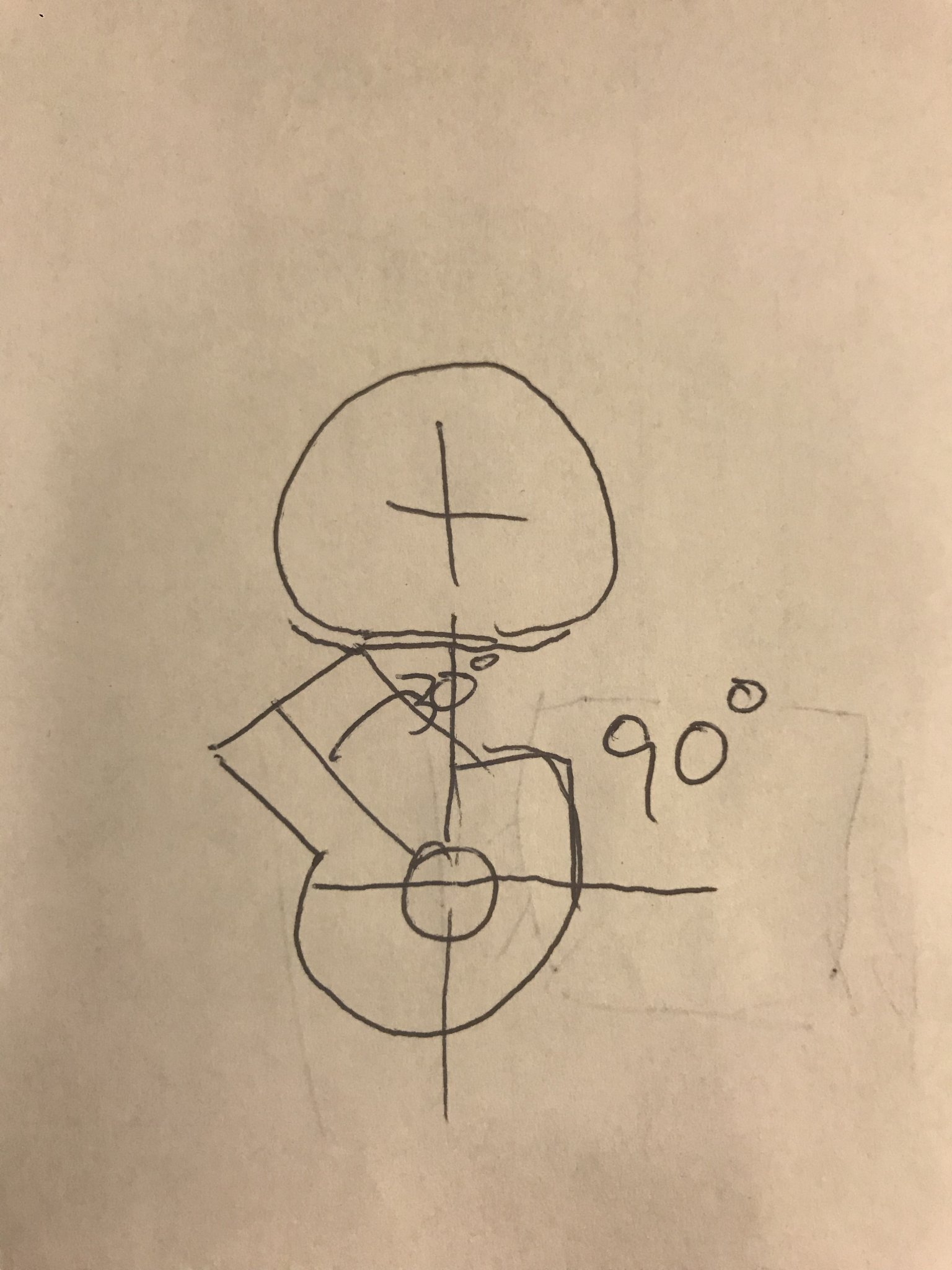

This is how David Tubb does it. The rifle is 30*. The retical is still perpendicular to the bore, because he has a special mount.
