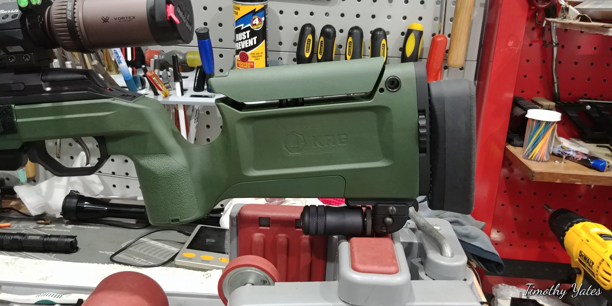

I have been considering getting the $68 KRG adjustable buttpiece for exactly this... and also for different standing/prone positions would be nice to raise/lower the buttpiece too.
I set the scope up with all the diopter tweaking. Set the rifle up with an adjustable length and cant butt pad (AICS) for my length of pull. Put the scope on and get the check-rest loose, and then play with the scope position and check-rest till comfy and scope shadow optimized. Then I get the scope level to plumb line or line on a target at 50/100 and then get the bubble level adjusted to agree with the leveled reticle. Then I do last round of adjustments on scope final position and rifle set up. Get the rifle comfortable with my eyes closed and then tweak the scope until it is level when I'm dead sleep comfortable. Torque down the scope. Double check the bubble level to the reticle. I should shoot some boxes and check the scope at that time, but I'm usually running up long distance dope, since ballistic calc are so off when I try to do them for 22LR.
With the cant adjustable butt pad, I try to keep the rifle level, but I don't obsess about it. To me, the critical thing is the reticle to the bubble level.
