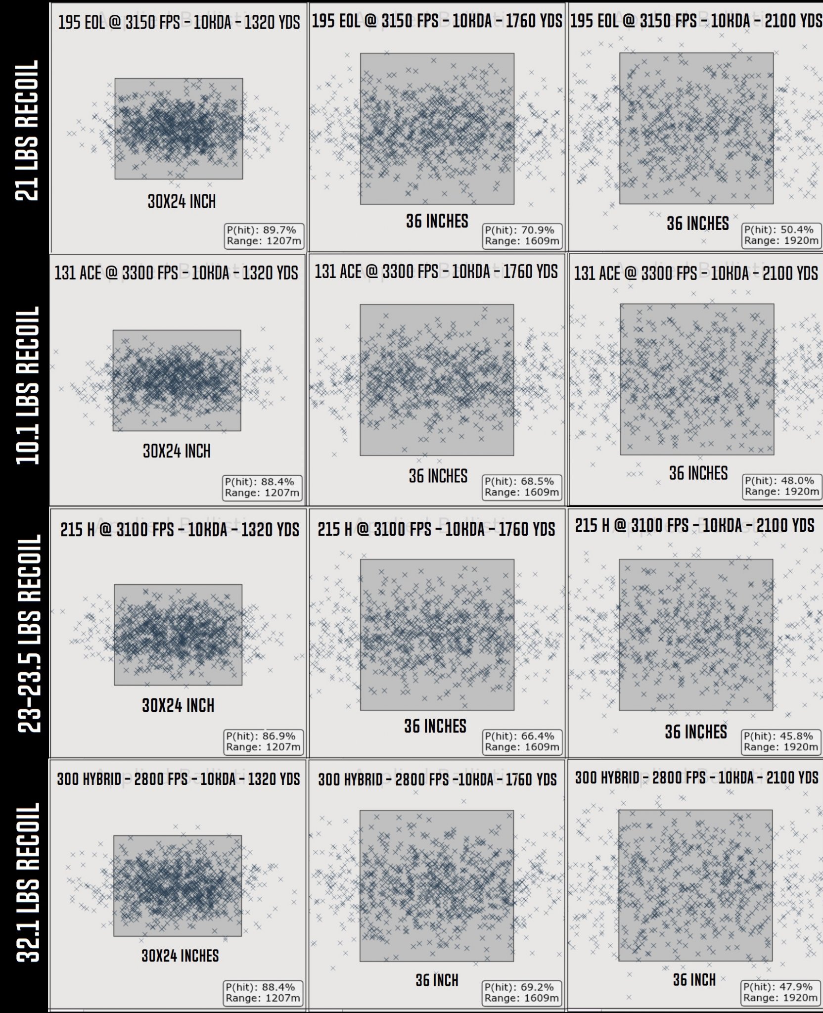

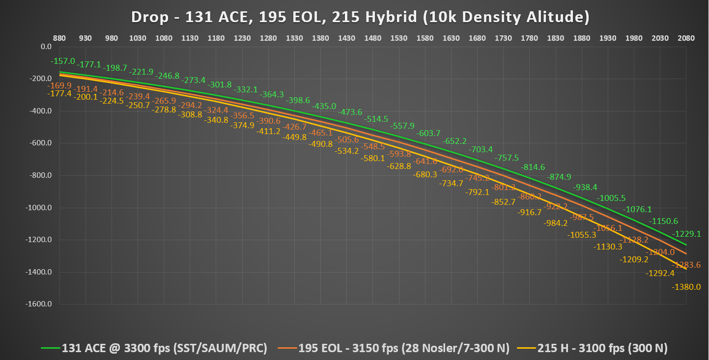

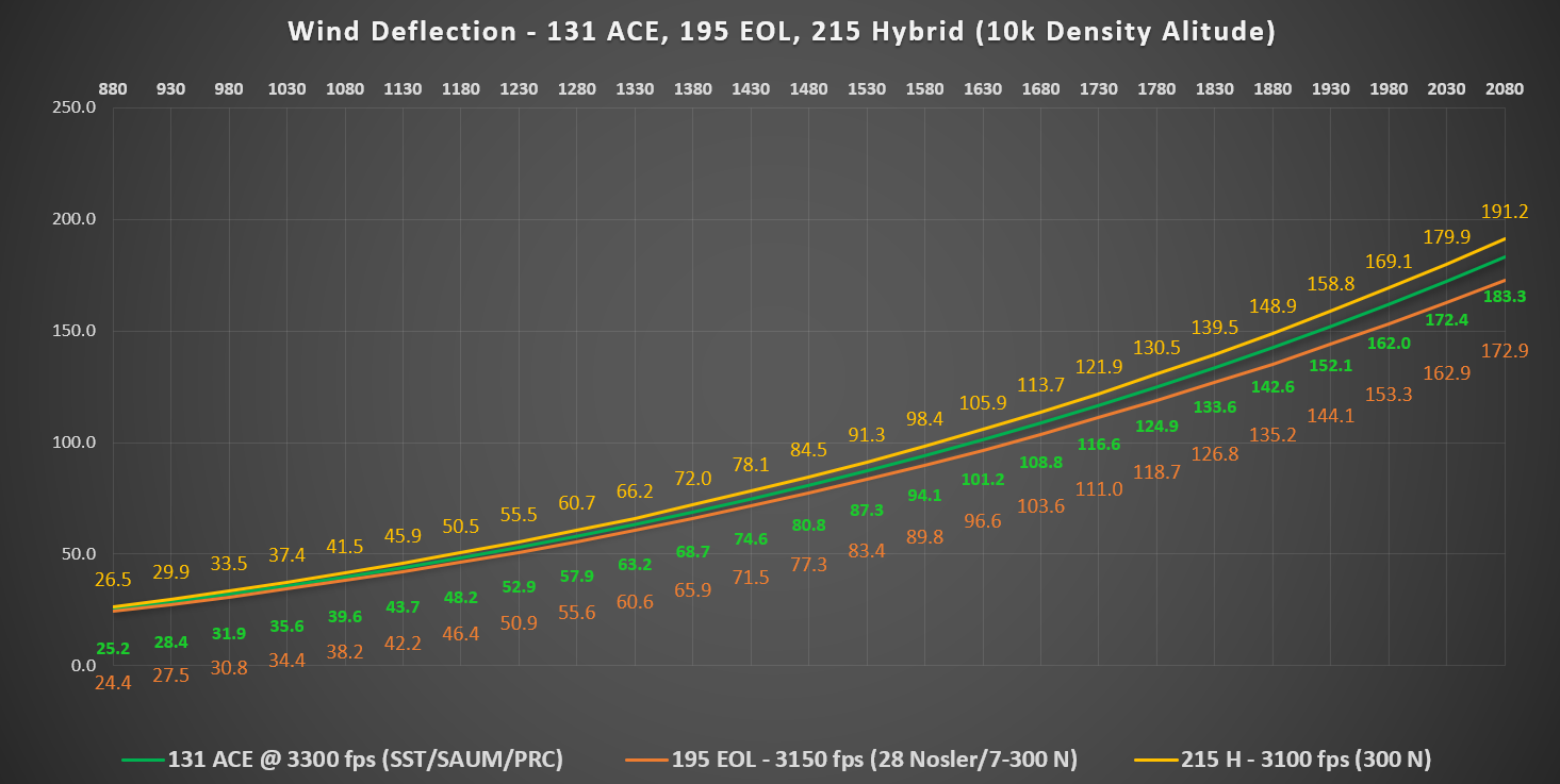

A 7mm mag will indeed make your goals. If you use a normally weighted high end chassis or stock, at least a 26" in a faster twist with at least an M24 or MTU profile and brake, the recoil will be a very tolerable push. The only downsides are less barrel life and much less to see when you miss.
Here is a older video (from the DIY camera thread) showing a 168gr berger. Note the two Large Watermarks on the left were from a 338 285Amax at closer range the two on the lower right from the same gun at 2400. The hit in the center as it is playing is the 7mm - notice how much lighter the water mark is.
Please note I have a lot of other videos closer but nothing with my 7mm (same holds true for the difference in splash however at 2400 as it does at 1500 or whatever)
The clip shows the misses and about how much dust the 7mm can toss up. Note the difference in quality is because I was testing different antennas:
338 with misses
7mm with misses

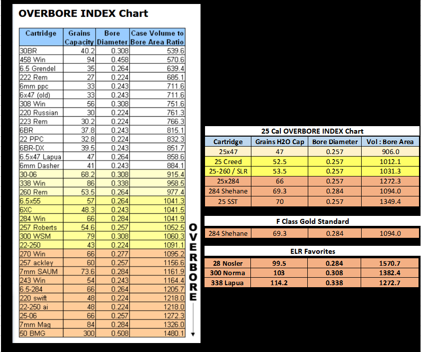

It seems like there is .284, .280AI, then the short magnums and then the big jump to magnum cases but 7x64 might slot in between .284 and the short magnums.
The 7x64 has a bit more capacity than .284 but the powder column is longer and the max pressure spec is less being fairly antique but it still seems to be somewhat popular in countries where military cartridges are not legal for sporting use.
Maybe it's a pipe dream but it seems like there is a chance that it might be good for ELR.

I like what I've read about the 7mm SS (Sherman Shortmag). Getting 2900-2950 with the Berger 195 in a short action.
http://www.snipershide.com/shooting/threads/7mm-sherman-short-mag.6870335/
I've also heard of a 7mm LRC by Precision Rifled Ordnance that is a .338 LM case shortened to fit in a short action and necked down to 7mm. Seems like it could be interesting, but I haven't been able to find any details on case dimensions or performance.

I didn't see any energy and range requirements in the OP but wanted to drop some surprising #'s for anyone who just needs hit % out to 2100 yds.
Hit % is only half the battle of course. Miss Signature and if you're trying to kill something, this little round is only really usable to kill to 1000-1150 yards at average altitudes and miss signature dries up around 1400-1500 yards.
The reason these #'s were oiriginally generated is that I wanted to check the handicap of our 25 Cal 131 ACE vs the match winning 7-300 Norma and similar ballistic cousins since we are offering $10,000 to any 25 Cal shooter who may win the Q Creek ELR match to 2100 yards this summer. We are also offering $2570 to the highest placing 25 Cal shooter regardless of finish. These target sizes shown are the actual target sizes at range for the Q Creek ELR Match.
If I missed something about energy requirements please correct me and I'll remove this as not to hijack. It seemed the OP's main concerns were Recoil and Component Cost.
If we are talking hit % then these AB Analytics Hit Probabilities are actually meaningful for someone who wants to hit stuff from 3/4 to 1 mile and not get pounded doing it. With the increase in popularity and reliability of flashers this approach should not be such an issue.

Recoil calcs from JBM
7042645
Drop

Wind
7042647

Made ELR Favorites addition to an edited version of Accurate Shooter's Overbore Index to serve as simple comparison.
Comparing 25 SST, 28 Nosler, 300 Norma, and 338 Lapua, the 338 comes out at the lowest Overbore Index with the highest recoil by far with the 25 SST in second Overbore Index and lowest recoil by over 50%.
338 Lapua - 32.1 lbs Recoil - 1272 OI
25 SST - 10.1 lbs Recoil - 1349 OI
300 Norma - 23.25 lbs Recoil - 1382 OI
28 Nosler - 21 lbs Recoil - 1571 OI

* note on 28 Nosler - I averaged a commonly reported H20 Capacity with the MFG reported capacity.
