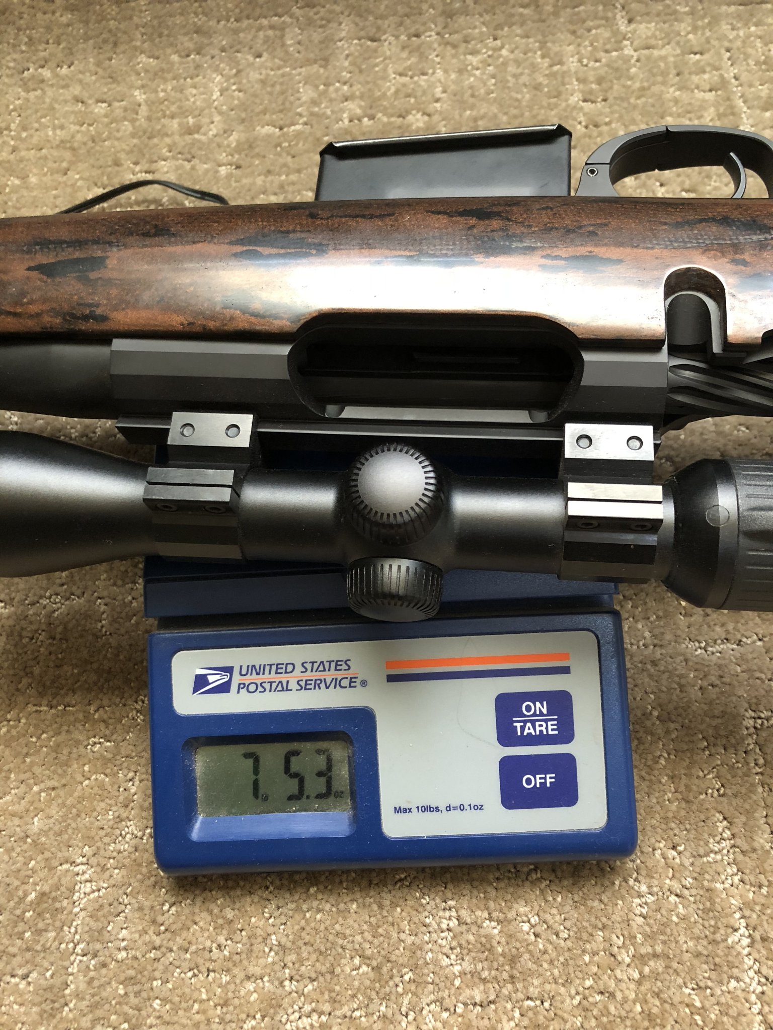

2 manners ultimate classic with M5 bottom metal (could save here)
2 action (fuzion ti saves 5 oz over bighorn origin)
3 barrel (lighter saves up to 10oz)
2.2 scope and rings (razor hd lh saves 1 pound)
9.2 pounds (7.2 with fuzion lighter/shorter barrel, new scope, could squeek under 7 with different bottom metal)
but you're also talking about $900 more to save the 5oz with action and again with new scope
Ya, and a sling and bipod ad more than people think
Yes. The Barrett for example, 5.2 lbs starting, goes to about 6 with a nice light 2-10 optic, bipod and sling bring it up to 6.8.
He's going to need to drop a pound somewhere to compensate for the tank of a scope. Christensen can get you down around 4, but you're into a $5k+ rifle by that time.
