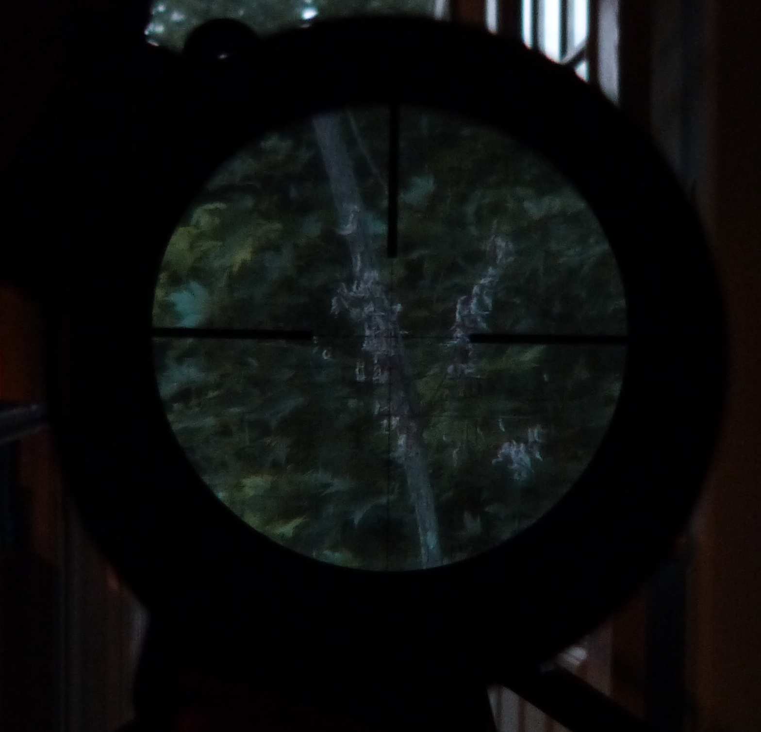

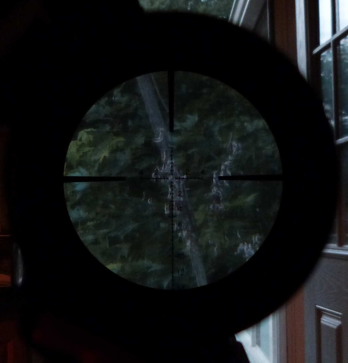

At 7:31 PM EDT I had my rifles setup on my kitchen island focused on a tree branch about 50 yards out (and unfortunately through a window screen).
I can't setup outside, you know, neighbors and all.
The Steiner was brighter than the March at 12x but the overall quality of the image was similar.
The difference between the Steiner and the March reminds me of a similar test I did when my Optolyth Compact 80 spotter arrived, comparing the image every few minutes at dusk. The Bushnell Legend Ultra HD 20-60x80 spotter I was comparing it to seemed a tad brighter than the Optolyth, but I could still discern detail better with the Optolyth. The Bushnell image appeared "washed out", if that's possible in such low light conditions. I still believe the Bushnell Legend Ultra HD spotter to be a great option at $450-ish street price, but the CA free Optolyth is easier to use for extended periods, colors appear more natural, resolution is a little better in normal lighting conditions... but I digress.
I wish I had jumped to 18x in the fading light to see how much advantage the Steiner had. My guess is it would have been more pronounced.
At 12x in those conditions, would I have taken the shot? In those conditions, I don't think either scope was the limiting factor.
I did my best to get pictures but I'm afraid they're misleading; with a point 'n shoot camera, I think it compensated for the low light more with the March (longer exposure or larger aperture) so the March picture looks brighter, but it is certainly not. An SLR with manual controls would have been better suited but I don't own one.
After I took the pictures and looked at them on my PC, I noticed how canted the reticles are. The cant is in the bipods, as I haven't leveled them since getting back from the range and the crappy warped plywood benches.
Joe

Joe,
What's the reticle thickness on the Steiner?
I'm guessing the pics didn't do the Steiner's reticle justice in actuality???
Not at all. The view through the Steiner was noticeably brighter than the March. The darker March image looked more natural, though, one of the things I really like about it is its neutrality.
The camera has a mind of its own and if I posted the entire picture you'd see how much darker the entire photo was compared to the photo through the March.
Another thing I failed to mention is that both photos are cropped a lot. The pictures were shot in a 12 megapixel camera but after I cut out 90% or more of the photo to post just the view through the scope, they are fairly low resolution. I tried using the zoom to narrow the FOV through the camera but then it wouldn't focus at all. I took a lot of pictures just to come up with 2 that were any good at all.
These are 2 very different scopes but they both get it done. The Steiner is just too big and heavy for the .308 I have it the March mounted on, an 11 pound rifle (with scope and loaded) that will be used on some whitetail this season.
The stadia at the center of the Steiner's MSR reticle is .05 mil if their drawing is to be believed.
Steiner is revamping their MSR to give it a thinner stadia in the center, not sure if units currently being sold have the old or the new.
For target shooting it's a bit thick but for tactical work it is good.
It was fantastic at 640 yards Saturday on steel silhouettes.
So was the March, although I only got to 500 yards before barrel heat ended the fun with my .308.
