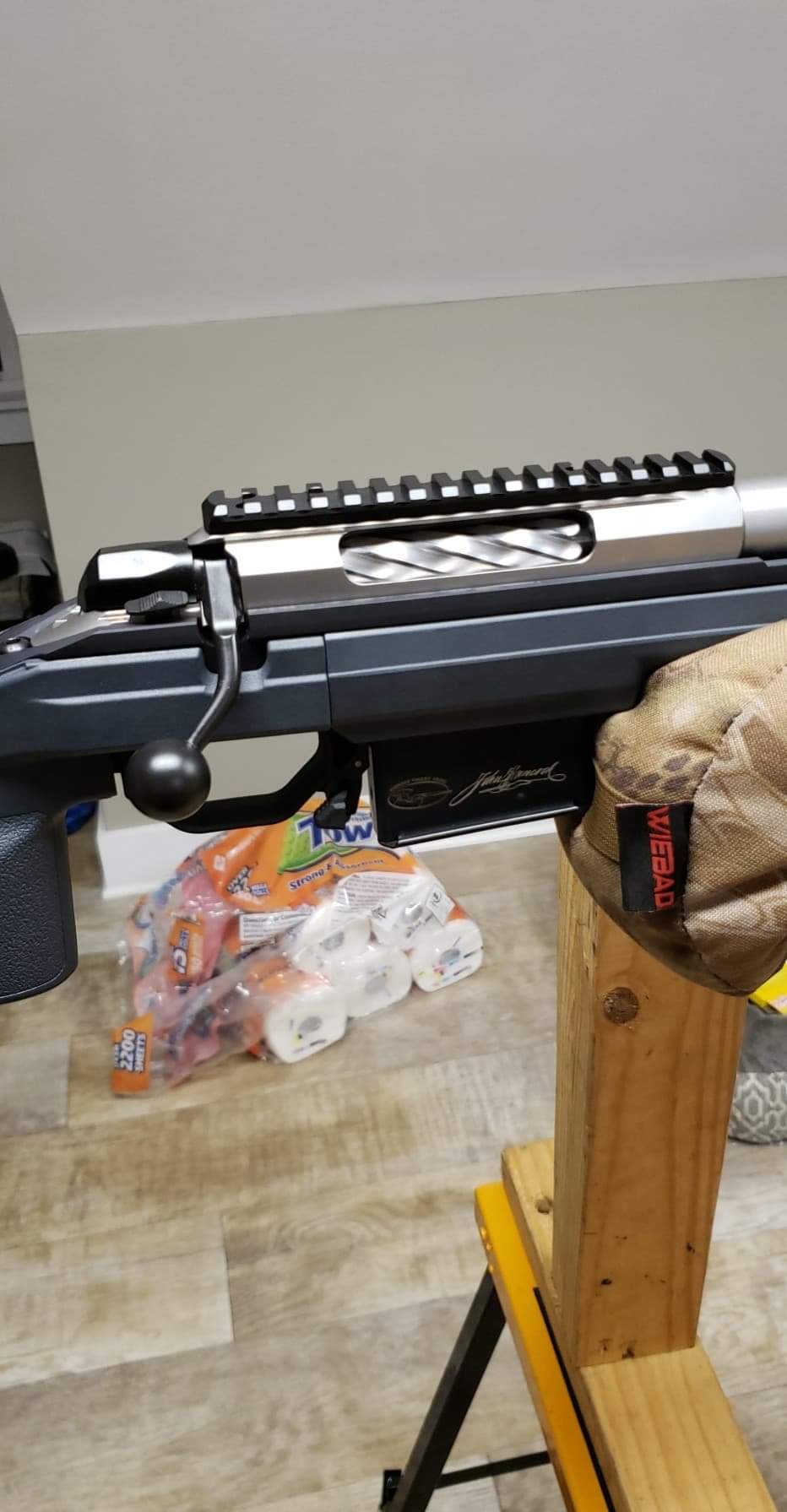

Kinda like this bolt handle/knob combo on my 7-08. Works for me;)

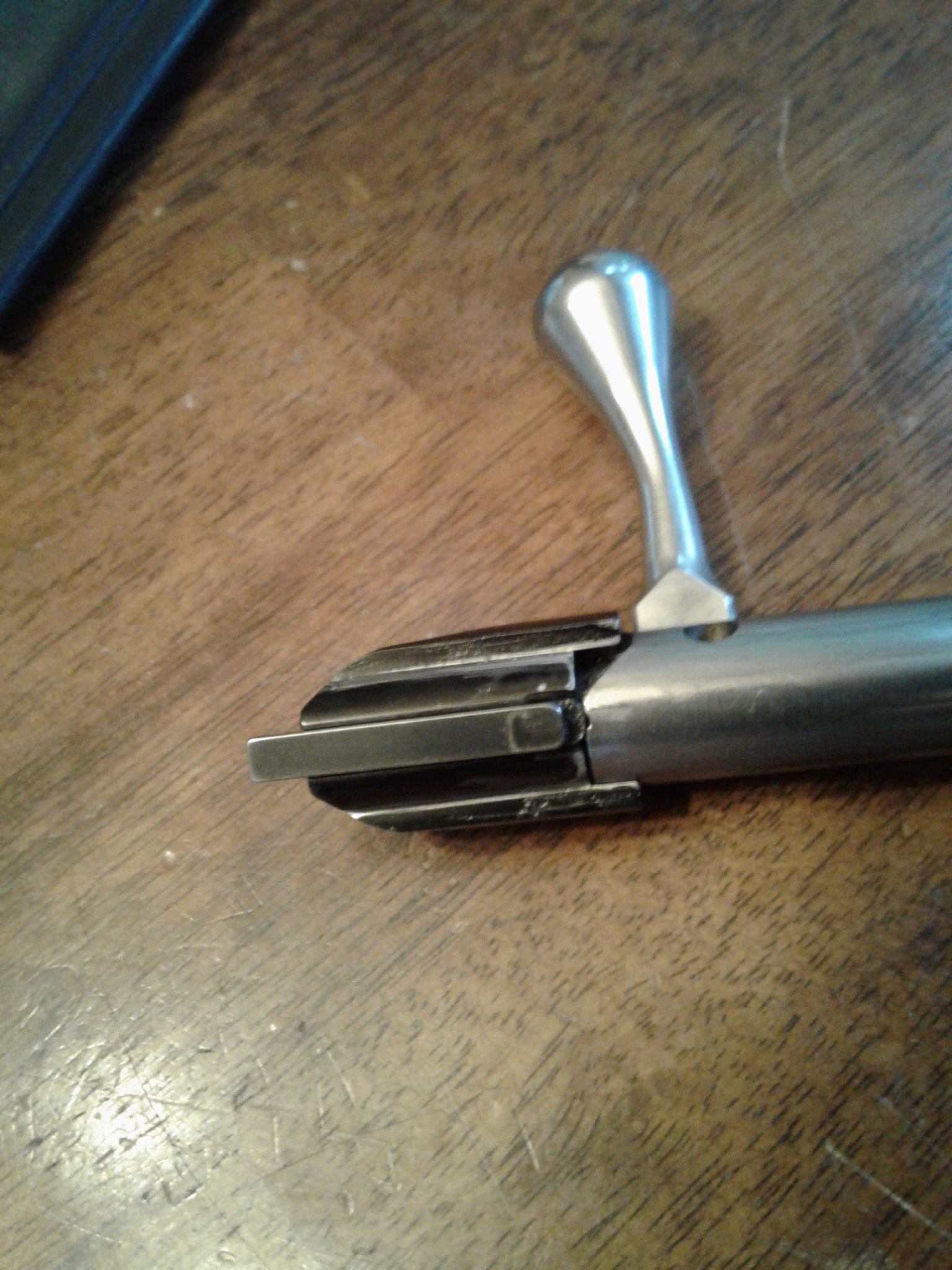

Look at the shroud for marks in the anodizing both were it slides into the race ways just forward of the tang and inside were it is engaged with the bolt during cocking.
I can put up a pic and show the areas mine was causing issues due to not having adequate clearance if you would like and I didn't put the spring in since I didn't see any benefit to it.
The shiny spots are the areas I had to file and hit with sandpaper that were dragging on the race ways just above the tang.
There were a couple other spots not visable without removing the shroud that were internal.

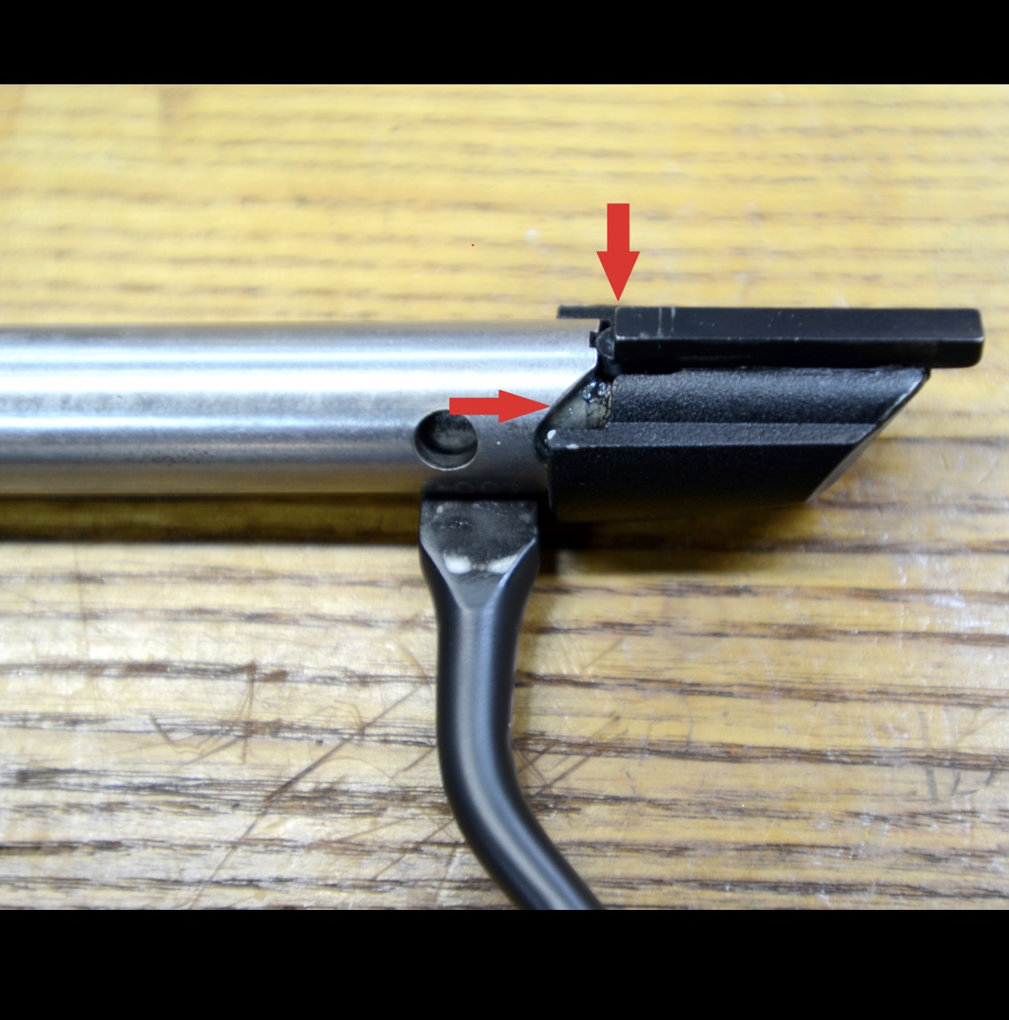

That still doesn’t completely solve my issue. Remember I found out last night it’s the cocking ramp grinding against the cocking indicator lip. See pic. I can either polish and remove some metal, leave it and use some lube and keep working the action, or send it to a smith that knows the issue and can polish it for me.
After I lubed the cocking ramp with TW25B the grinding/binding went away, but it’s still on the tight side.

there is some wear on the shroud and
