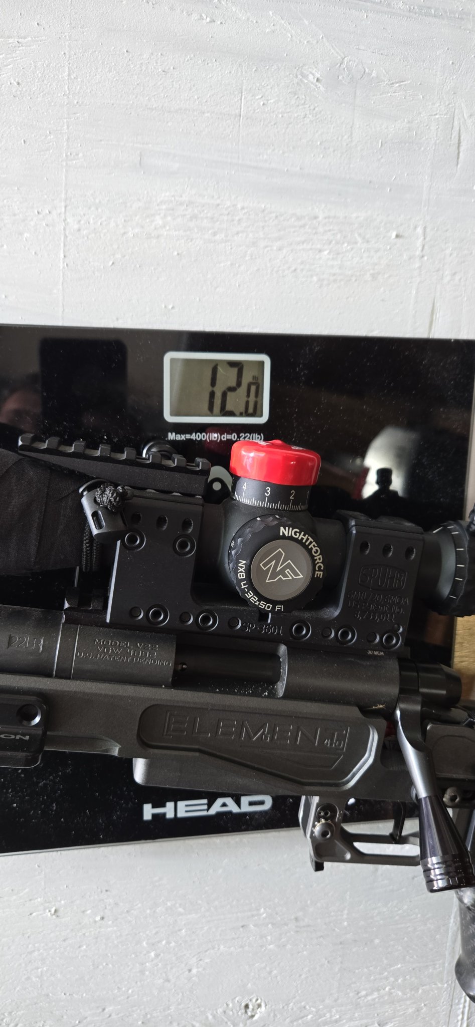

Here is my Gen 1 Vudoo with 25" 1.2 Brux barrel. Full rig weighs 21lb. Triggercam & McLeod Rail add 4lb to the setup. It balances well, but you can still see optical bounce from my heart in the reticle. I try to free recoil as much as possible to prevent this. It's the nature of a Lighter rifle and positional shooting. I can add a 4lb DST Precision Shaft Weight to the ARCA and the rifle does not move at all.
Running and gunning at a NRL22 X Match this past weekend was a blast. I had about 15 sec left on a 105 sec par time.
Rifle setup and weight is a personal preference. Match what you shoot the most.

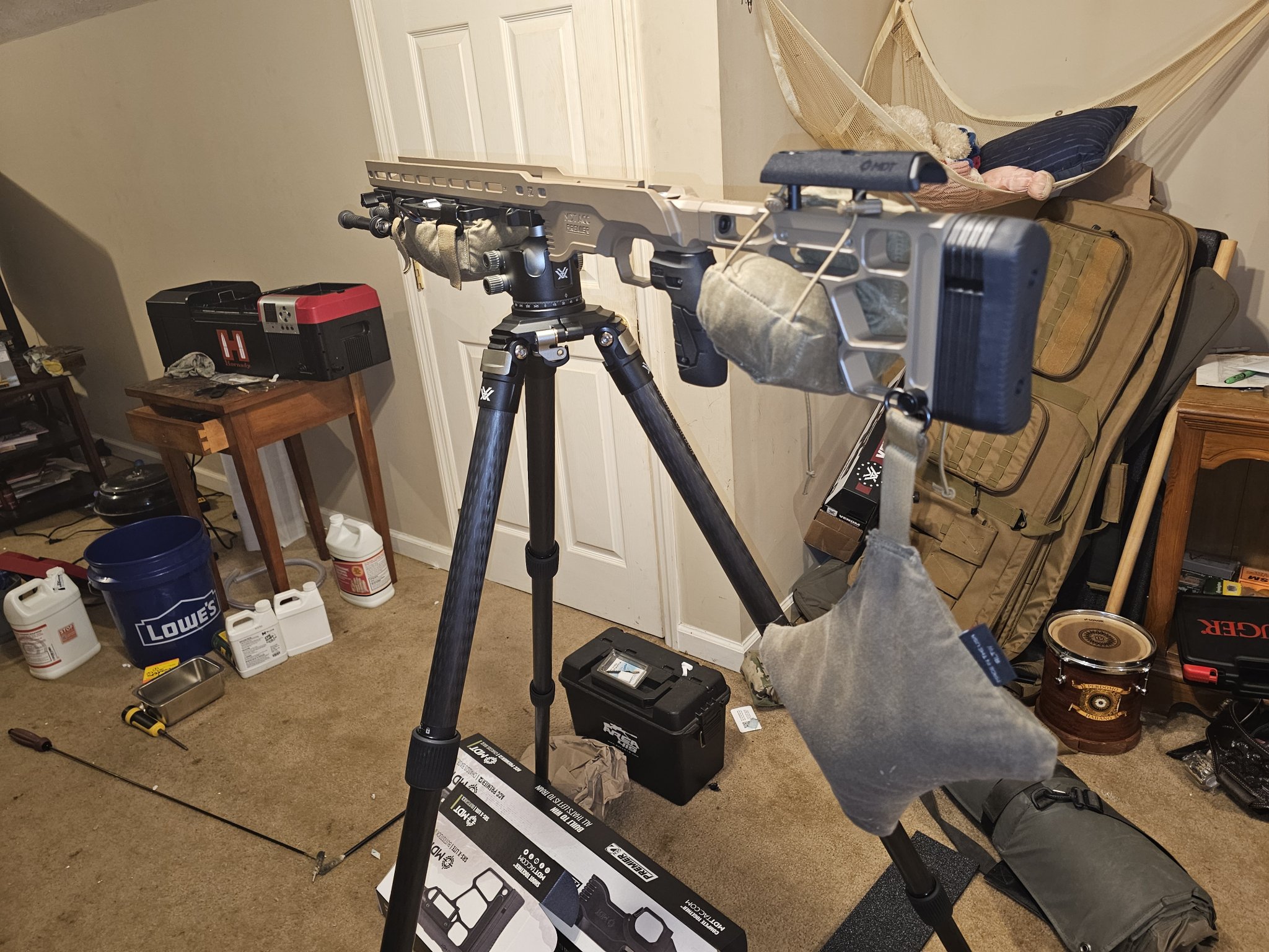

Will do, I'm out and about so tomorrow morning

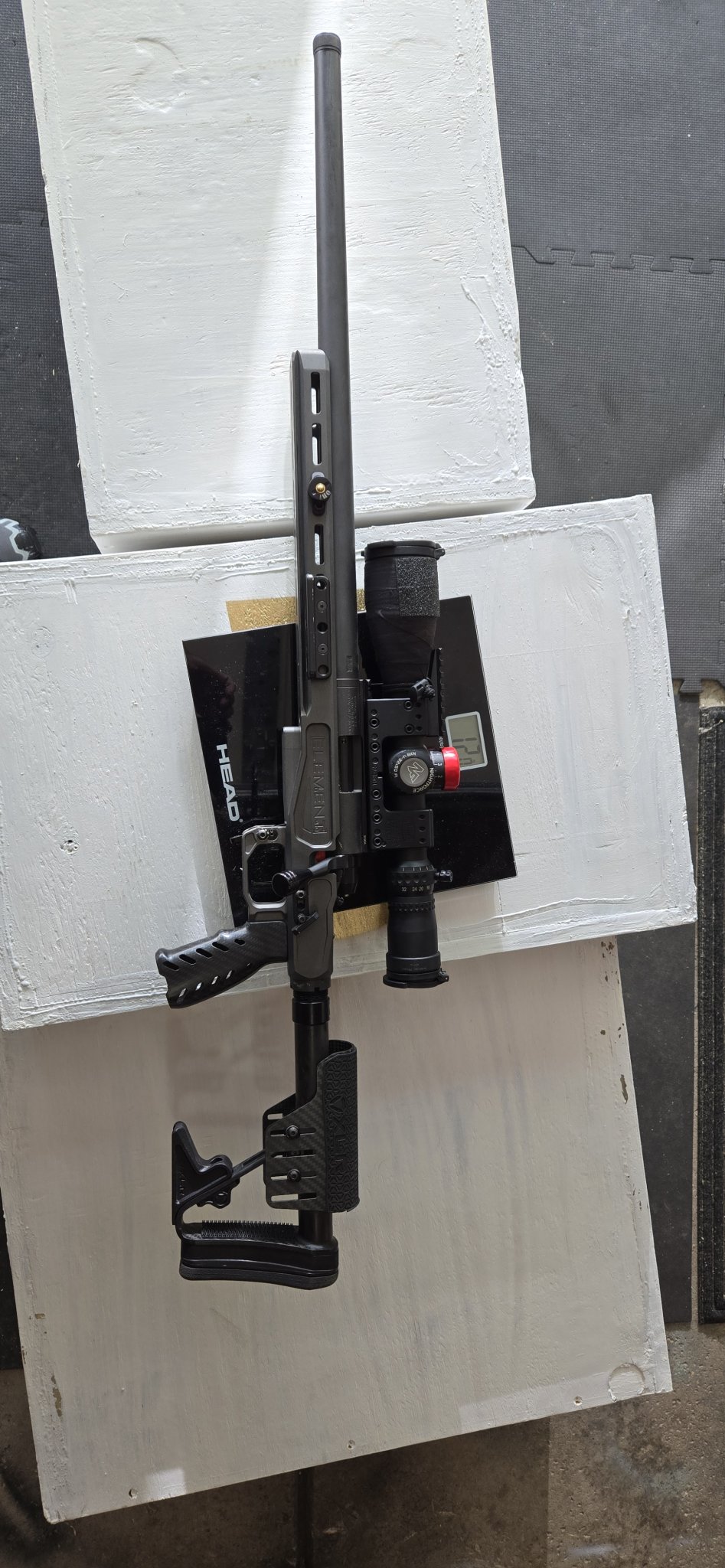

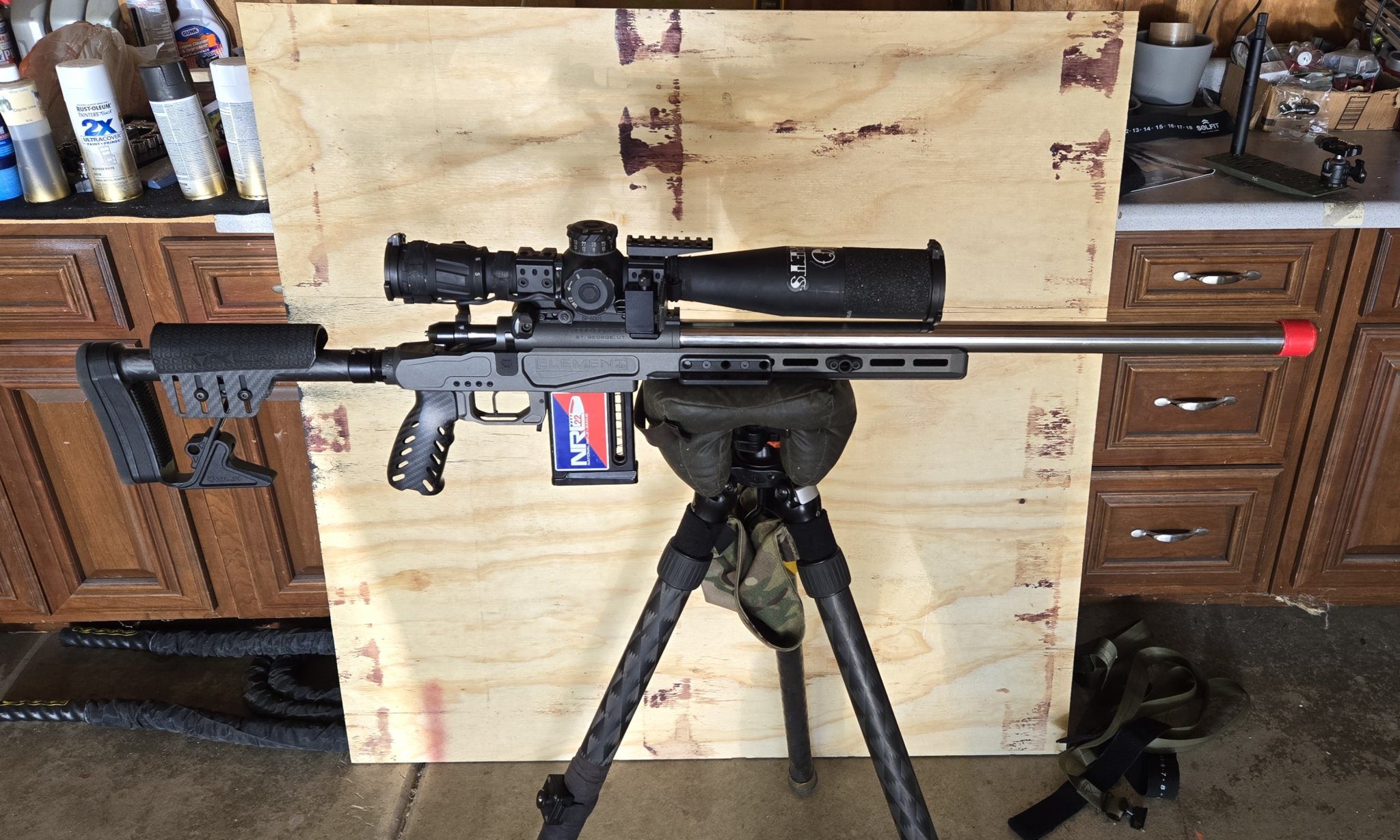

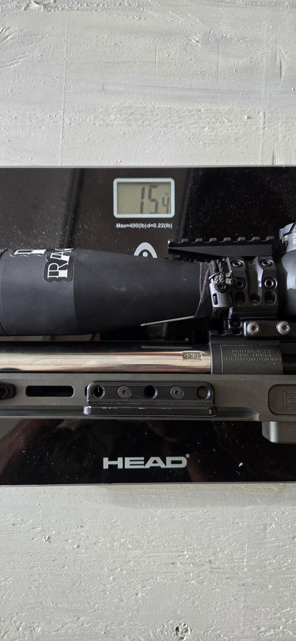

22" Gen 2 MTU with NX8 - 12lbs
24" 360 Straight with Zco - 15.4lbs
The 24" balance is perfect, almost front heavy.
The 22" MTU isn't bad either, maybe a tuner or keeping bipod on will give the right balance..

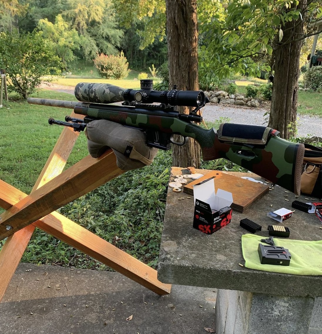

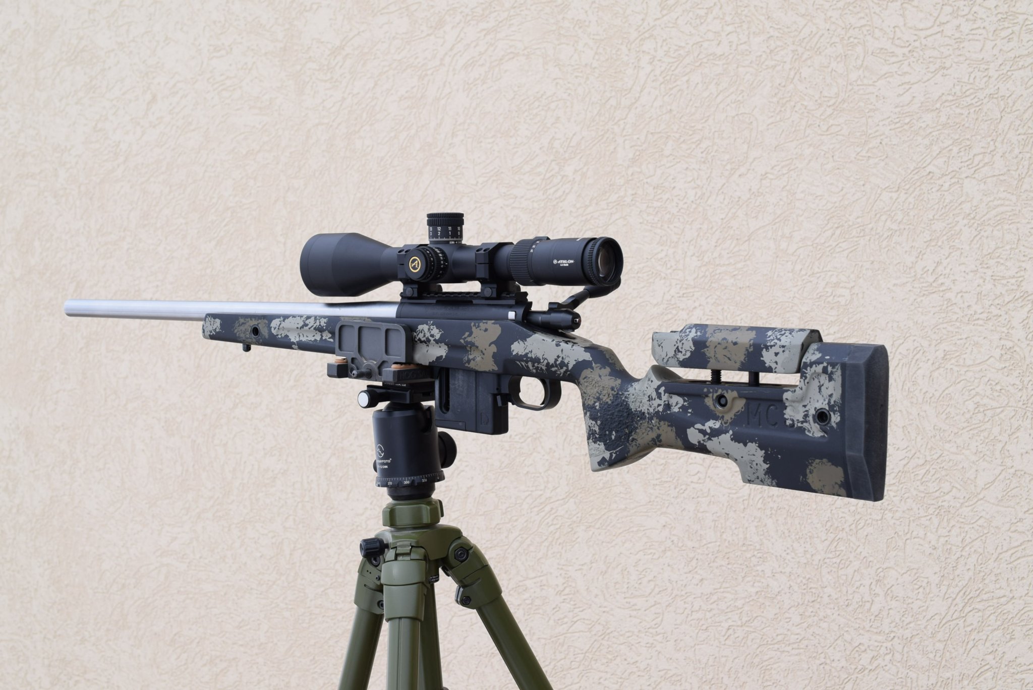

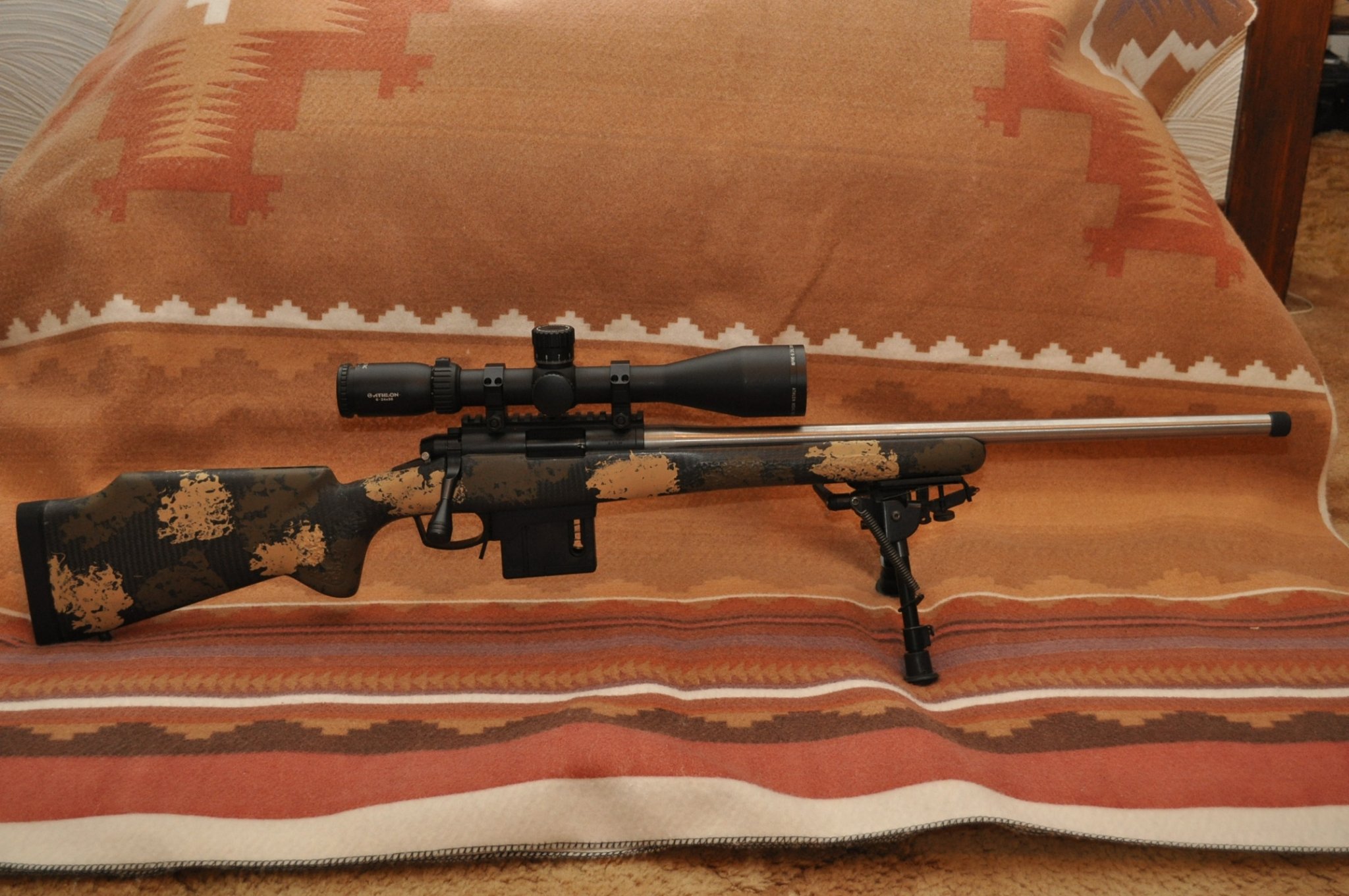

Several years ago, I decided that I wanted a very light Vudoo Gen 1, so I ordered a bbl'd action with their 18" Ranch bbl, and put it into a Manners EH2 stock. While doing initial shooting to zero scope & find out what ammo it liked, I found that it shot really well off the bench with a bipod & bunny ear rear bag, but even with this relatively stable set-up, there was more movement after the shot than my other Gen 1, which I'd set up with a 22" Krieger sendero bbl in a PRS1T stock. I felt that the rifle balancing so far to the rear exacerbated this tendency, and also made the rifle a bit harder to shoot offhand. I wound up pulling the ACE 18" Ranch bbl and replacing it with a 22" Krieger in their #4 sporter contour, which added just enough weight up forward to move the balance point to the front edge of the PTG Stealth DBM that I'd used, and the empty weight with the longer bbl came in at 9.5lbs, with an Athlon 30mm Midas TAC 6-24x50 scope mounted in TPS TSR rings. And though the 18" ACE bbl had shot very well, I feel that the 22" Krieger shoots just a tad better, where groups are concerned.
I've often thought about shooting this little rifle in a match or two to see how well I got along with it, but after shooting a match a week ago today where I felt quite stable with my 14lb Three-60 & 23" Krieger sendero (with a Pro-X tuner) in a PRS1T & a bigger scope (Athlon Cronus 4.5-29x56) - especially while shooting off a monopod supplied by the match director - I have a feeling that I'd have dropped quite a few more points if I'd been shooting the light rifle. Need to get out and shoot with it to find out for sure how much (if any) disadvantage the lighter weight would be in some of the positions we shot in. I've got torn rotator cuffs in both shoulders, and just the thought of handling a 20lb rifle during movement in a stage makes me cringe a bit, so I'm not going to build myself anything heavier than the 14lb self-imposed limit.

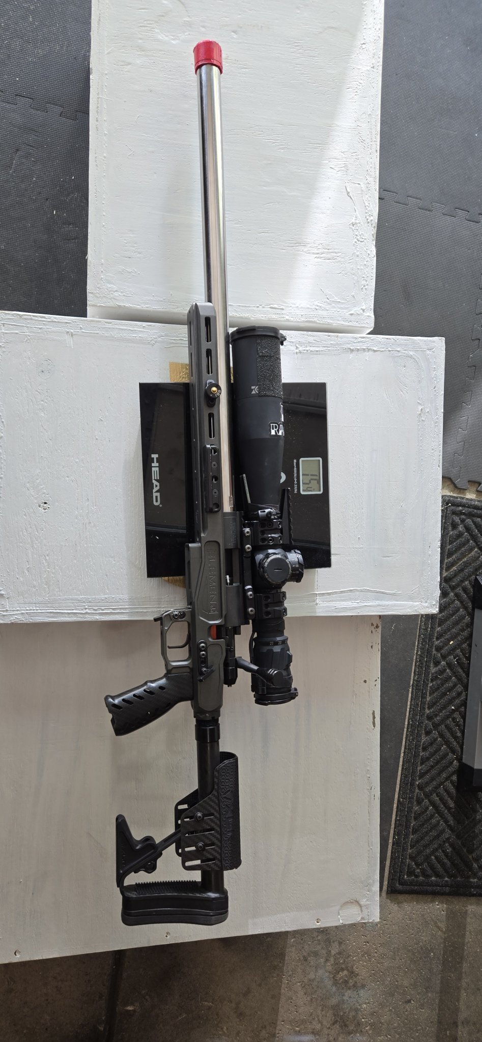

I just got done running a factory lightweight gun that barely balances well at approx 10lbs loaded. apart from being terribly inaccurate the light weight didn't hold me back particularly thanks to being 22lr.

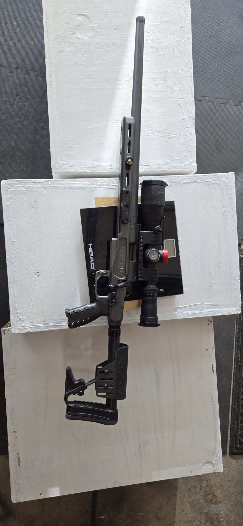

I'm going to build a gun that weighs about 15lbs this time around, just because.
cz457 threaded like a 40x, mullerworks cut rifled barrel torqued in, chambered by a pro.
24" 1.2 diameter in a mdt gen 2 premier.
it should be light enough, while still settling good and balancing. I don't plan on buying additional weights for it.
my centerfire weighs thirty something pounds, so I like a chunky monkey
