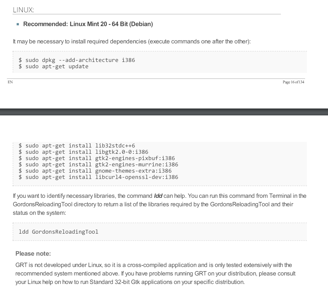

Hold "CTRL + ALT + T" to open the terminal, type and execute the commands.
First he has to find and unpack the tar ball...
Code:
cd Downloads/
tar xf GordonsReloadingTool-2021.2040-NIGHTLY-linux.tar.gz

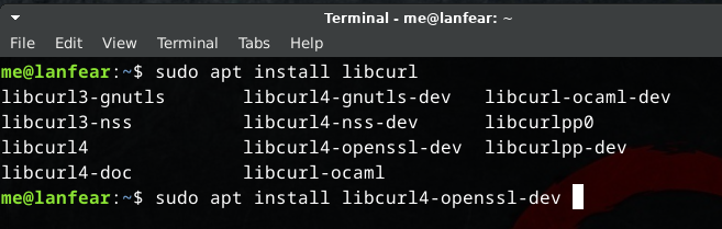

Dear fuzzy lord... if there was ever a package that needs turned into a flatpak, this'd be one.
Okay... after running through the string of dependencies, yes, it does install and run. Much better than the last time (quite a while back) that I tried... where there was no help in the manual beyond "we don't actually develop for Linux, someone else told us it worked, sorry". At least this time knowing what dependencies need installed goes a long way to making it work.
A couple of those latter ones - gnome-themes-extra and libcurl4 - don't necessarily need the i386 target, so if they fail out saying not found/available, try again without the :i386 at the end.
The tarball in general is a mess... with everything having full 775 permissions. Ugh.

So... backing up a bit: the file as downloaded should be named 'GordonsReloadingTool-2021.2040-NIGHTLY-linux.tar.gz'. You may have used utilities such as pkzip, back in the day, on Windows. If you want to do it from the terminal aka command line, you can use the commands I listed earlier. Basically it'll uncompress and unpack the file into a folder of the same name. You can accomplish the same thing by selecting the file in the file explorer, and right-clicking for the contextual menu, and choosing 'Extract here'.

The picture that @Evintos pasted earlier appears to be a screen shot from that manual. Unfortunately, the manual doesn't have a lot more than what was already posted. But once you've worked through those commands, you *should* be able to just double-click on the file `GordonsReloadingTool` and it *should* just run. If you are in the terminal, you can just type the filename, hit enter and it should just run. When I ran it from the CLI, it groused a little about something involving the current desktop theme (adwaita) vs. whatever it was originally built around. Still ran, so apparently not too much of a concern.

I run it using Ubuntu 22.04. Pages 16-17 of the english GRT manual show what additional software need to be installed (using apt-get install).
Try running to get the missing packages:
sudo dpkg --add-architecture i386
sudo apt update
sudo apt install gnome-themes-extras:i386

Can you hear the Heavenly Choir😍🤣🥰?!!!! Dropping the :i386 worked and changing to the l instead of1in the last line works. ( the L looked like a 1 to me at first,second, and third try) Thank you .....REPEATEDLY........
