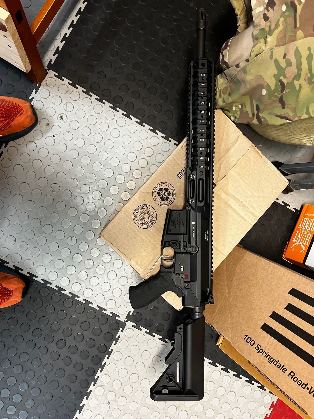

I switched over to all quad LMT's
after literally taking a chunk out of a DD mlok rail because a mlok accessory got stuck, and other issues with the rail shifts at the connection with the upper receiver etc
nothing against mlok, I would still rock high quality guns that happen to be mlok but after that, I was like 🤔, my hard earned money is going to LMT Monolithic quads
still debating on what scope to go with , currently using a 3.5x led acog, but I want the ability to stretch its legs and target identify better, any suggestions let me know, minimum 8-10x , I also dont mind if the the bottom end is 2.5-3.5
currently running a 16 SS 5r barrel, debating on a 18" rifle length, the other end of that spectrum would be a 13.5 p/w lw which I have wanted for a while..
thoughts gentlemen ?

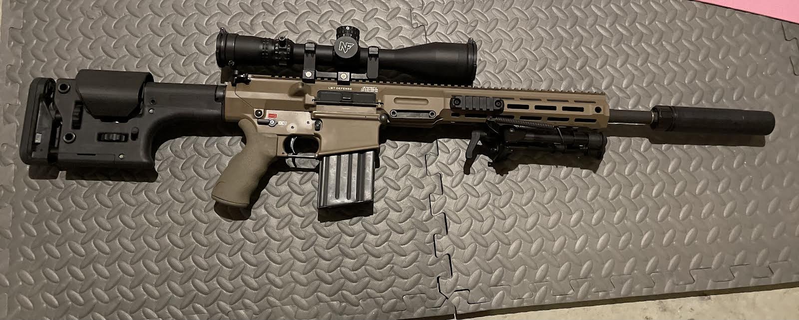

View attachment 8304878View attachment 8304879
I really like the SLK/SL8/WTF ever the current name for it is for the LMT. MLOK is a retarded choice for a switch barrel system unless it’s designed with MLOK clearance.
Anywho…
Mine has my 1-8 ATACR on it right now until I get my 3-15 NXS F1 back from a buddy (let him borrow it for hunting season). Although the 7-35 ATACR I popped on for ammo testing was also a good fit for the 20” setup lol.

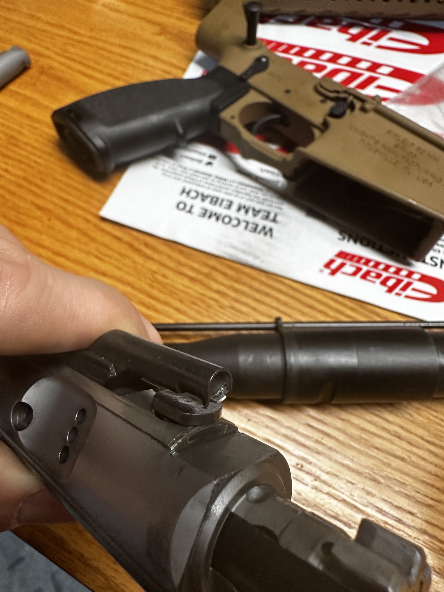

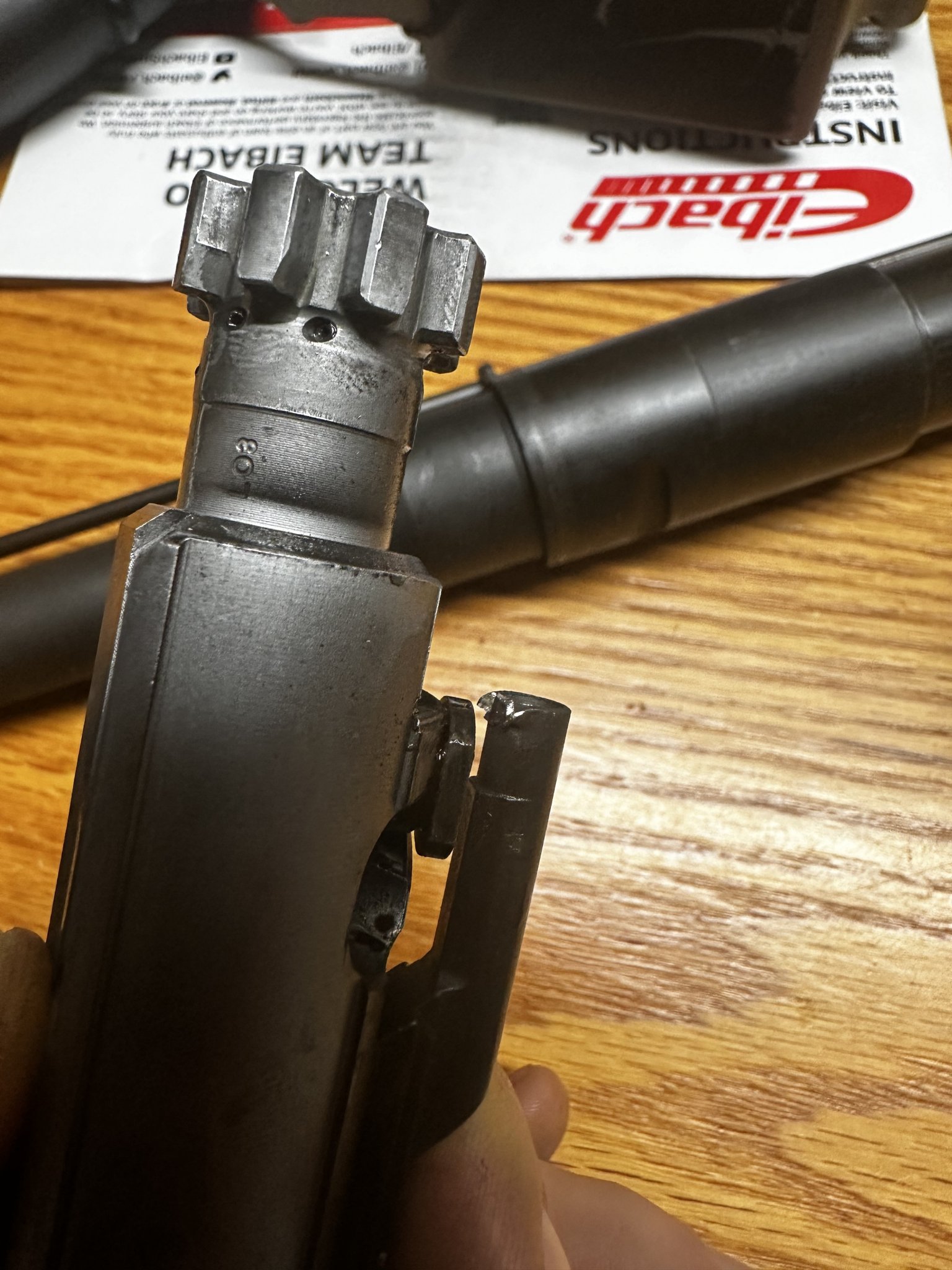

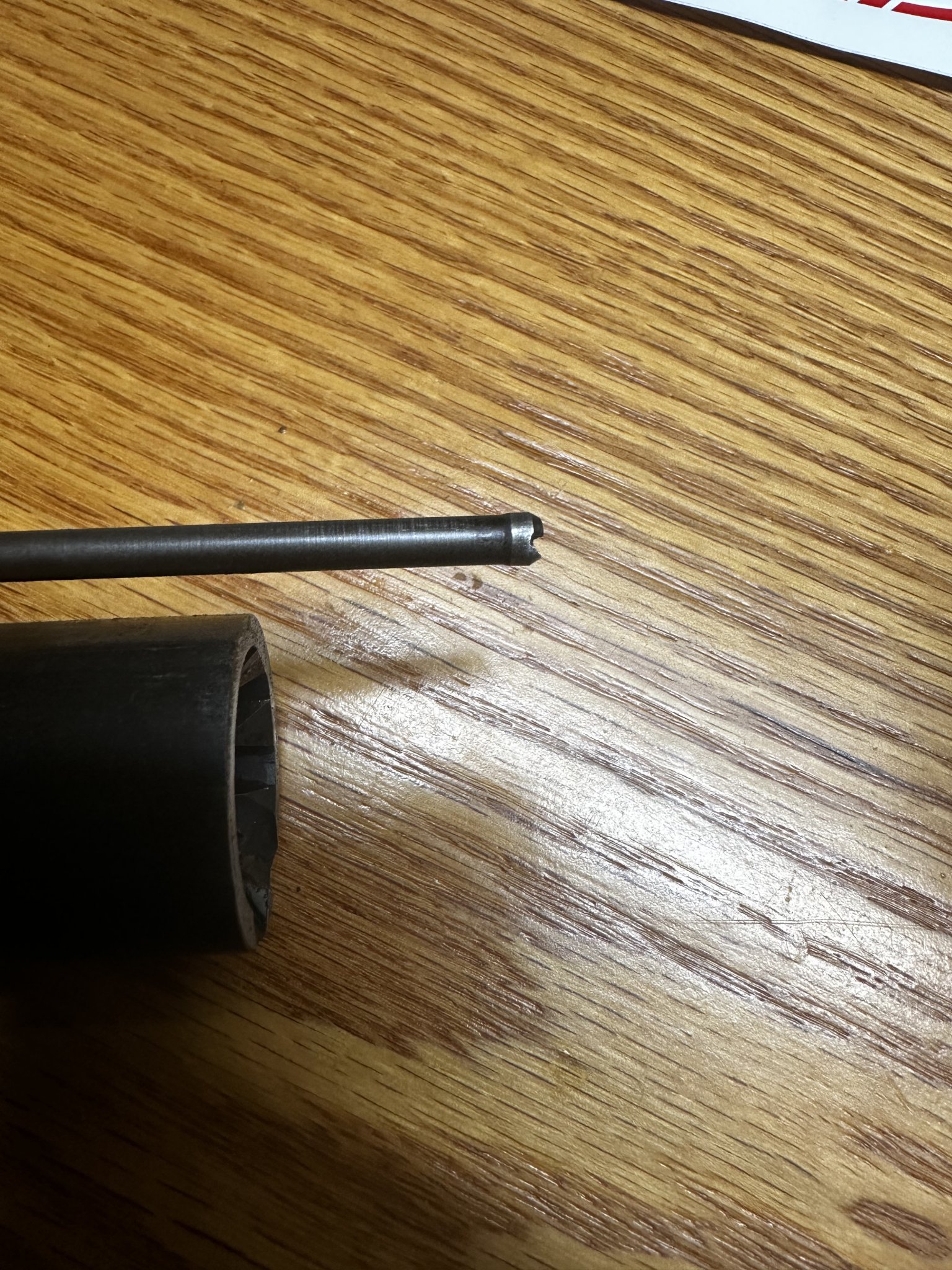

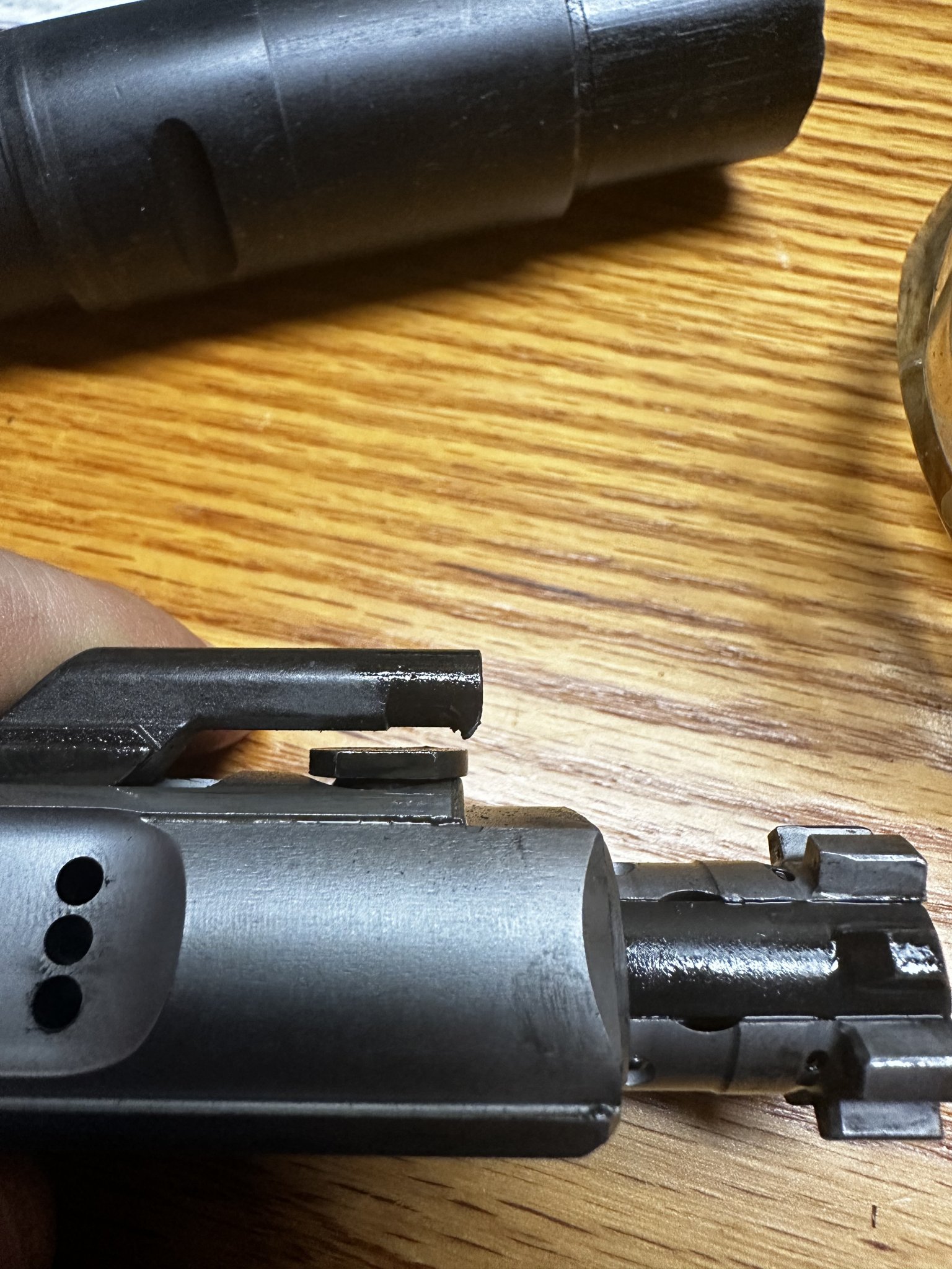

Has anyone ever seen this? Wouldn't go into battery on last round at my range so I put it in the case and shot the AI I brought. Got home to figure it out thinking it was a lube issue. Nope. Gas key and gas tube somehow got buggered up. Buy a new gas tube and gas key?
Most likely the gas tube and gas key are misaligned.
Have you removed and reinstalled the barrel recently? It is possible that the barrel was not completely seated properly when it was retorqued.
I would separate the upper from the lower, remove the buffer and spring. Slide the BCG back and forth in the upper into battery and see where the hard contact is occurring. I would stake on a new gas key and replace the gas tube after correcting the hard contact issue.

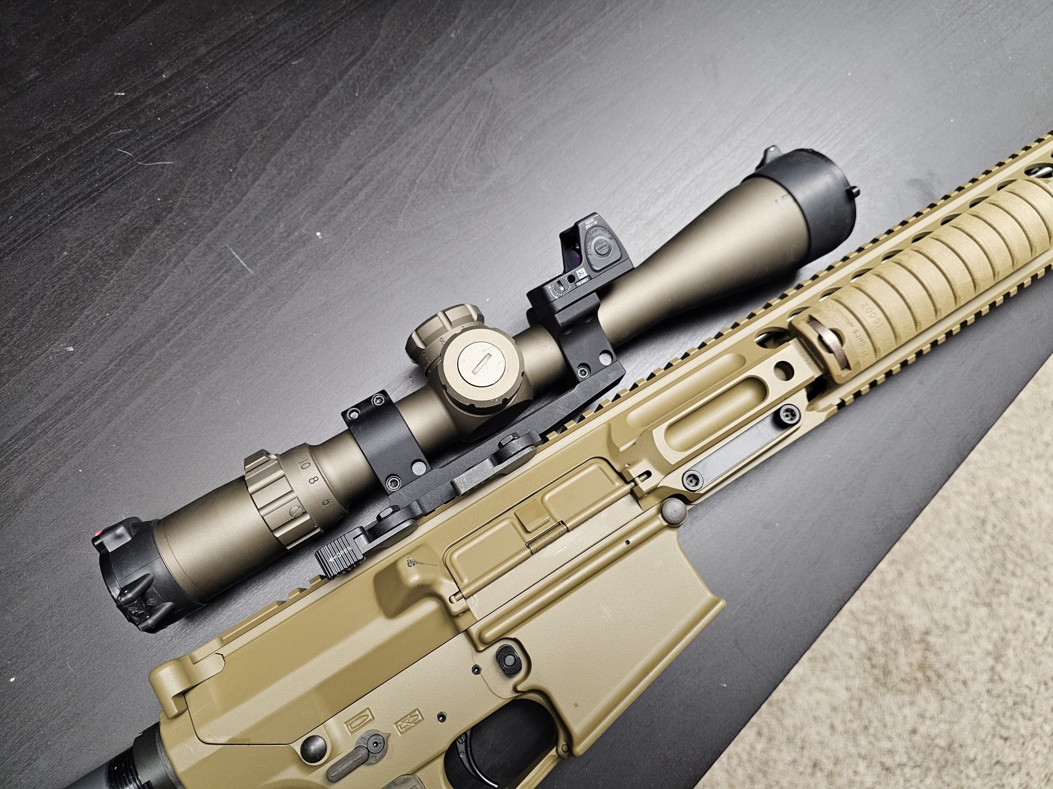

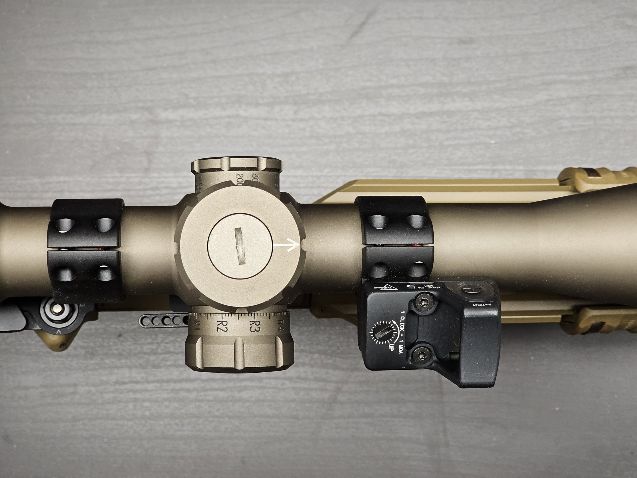

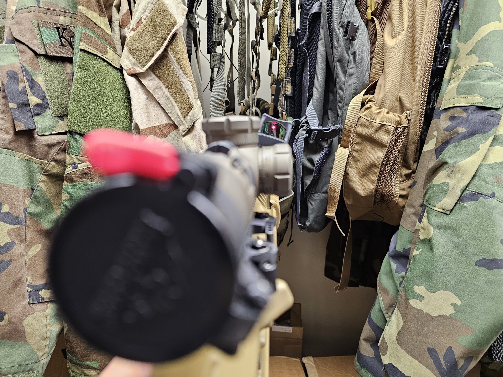

Do any of y’all run an offset reddot on your MWS? Curious as to what you guys are using. Have a bushnel LRTSi , debating between an aimpoint and an rmr. Any others to consider? Love to see pics too. Thanks
I run a LaRue mount with an offset RMR (also a Bushnell LRTS) and no real complaints. You actually need to have a low cheek weld to use the RMR and for an offset mount it doesn't stick out far at all. I may switch to a Badger mount with a 12 o'clock RMR at some point. With the LRTS, you're going to want a 20moa mount, FYI. There's not enough elevation in the turret, and I ran out at 800 yards or so with a 0moa mount. This current LaRue mount is a 20moa mount I believe.
Thanks for the info.
Looks like my set up. I do like the LRTSi. I ended up getting the 20 moa mount. I may need to do some thinking about which mount to get for the rmr.

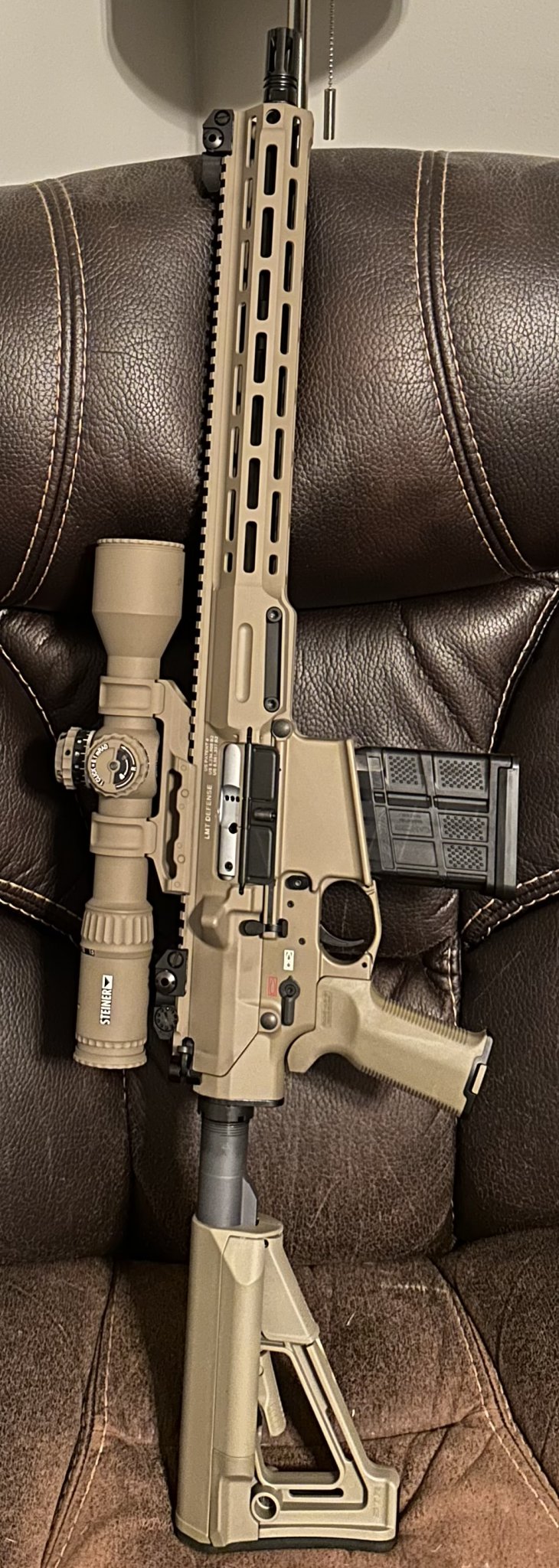

I like the 4-16 ATACR scopes for my MWS guns, although I do have one running an ACOG like yours. But my first choice is the 4-16 NF scopes. And offset BUIS but I am looking into a RDS offset. Good luck finishing up your Quadzilla !

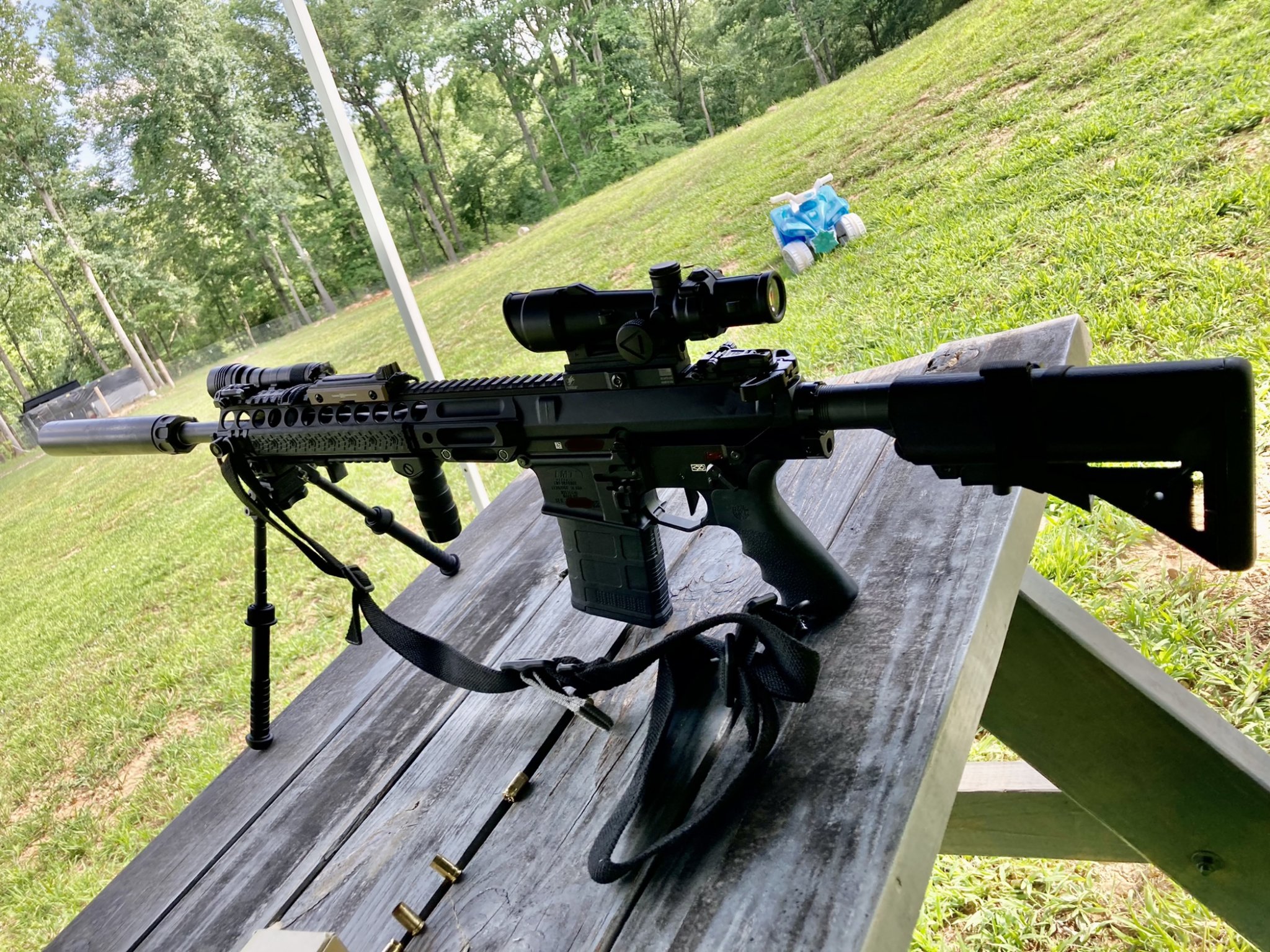

I’m running a Sandman S with BRT 50/50 gas tubes on both 16” 308 WIN & 20” 6.5CM barrels using the factory H3 buffer. Not gassy and really smooths the system out

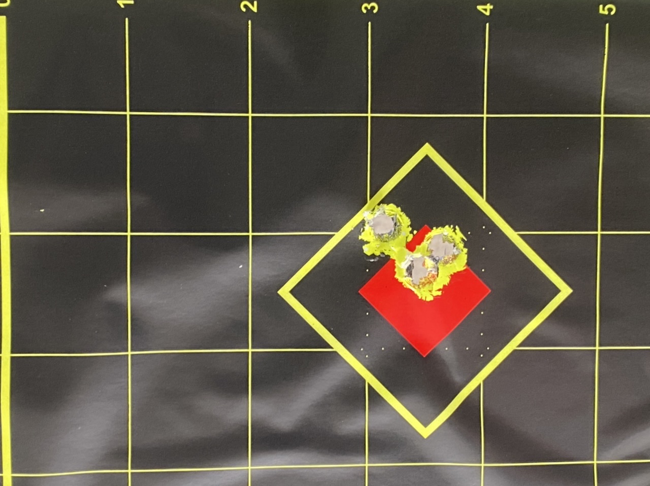

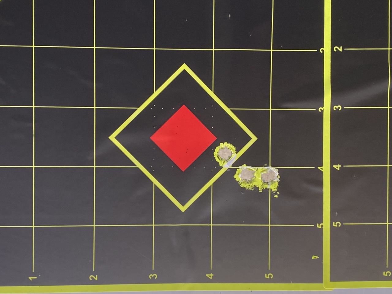

I have not shot my 6.5CM CIP SS barrel yet. I did get out today for the first time with the 16” 308 chrome lined CIP barrel that was on sale for $399. Tried a generic load with Varget and Hornady 178 BTHP.
First 5 shot group (scope not yet zeroed):
A couple three shot groups:
I was pretty happy with the accuracy out of a reasonably priced and durable chrome lined barrel.

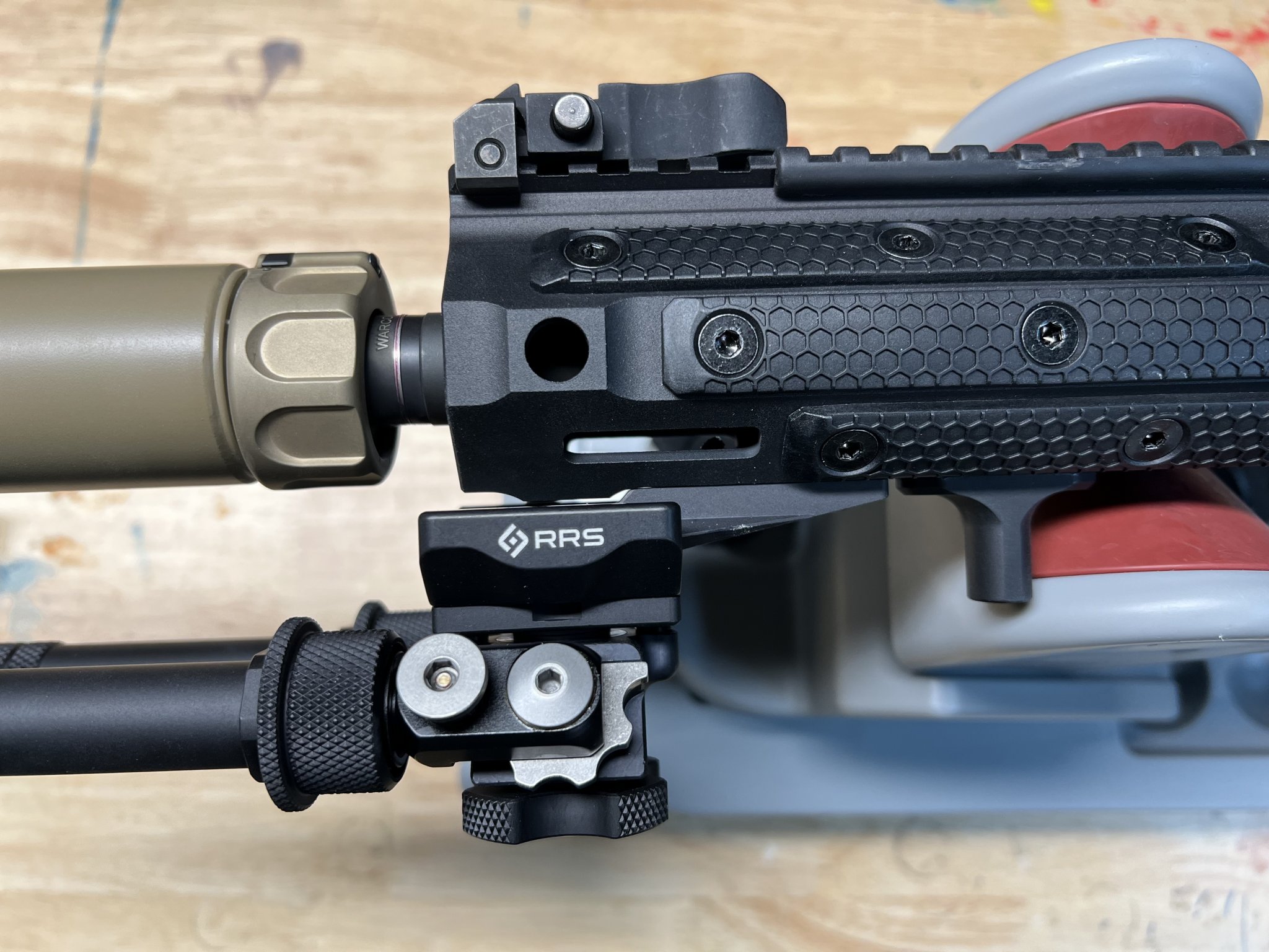

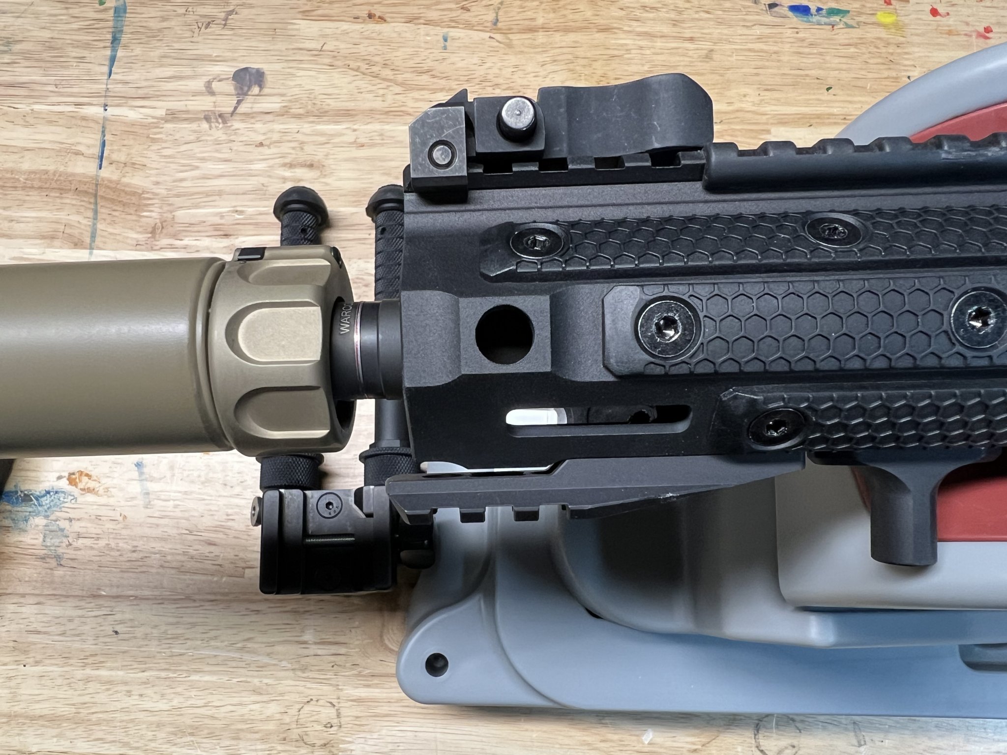

I was looking for a little extra real estate on my general purpose MWS to mount a bipod. The magpul cantilever mlok mount works good to get a pic rail over the bottom qd mount while still letting me get the finger stop far enough out.

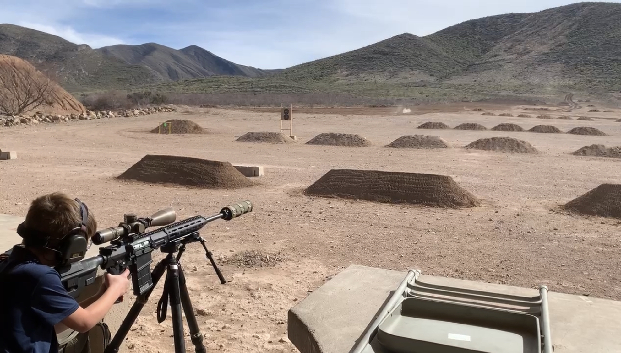

Took the kid out to 500yds (farthest the public line has) on a 12” plate.
20” 308 SS w/ 3-15x NXS F1 and ECCO modified AAC 762SDN6.
Pretty solid way to wrap up an 8th birthday.
