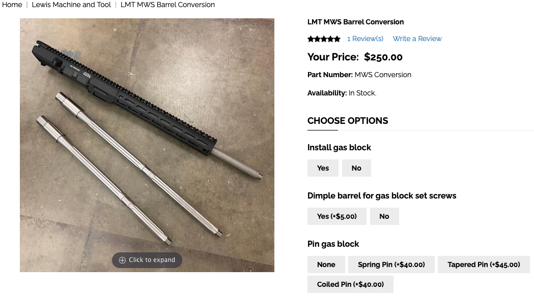

D.Wilson Manufacturing
You provide the barrel and they convert it for the MWS platform.
https://www.dwilsonmfg.com/LMT-MWS-Barrel-Conversion_p_38.html
D.Wilson Machining
Thanks for the info. I believe Dave just does the conversions only. The barrel contour is chosen/ordered/spun by a smith, which Craddock is currently working on and TBD. Per Dave, he does not do this. However, if I were to send him a off the shelf proof it would be easy for Dave.

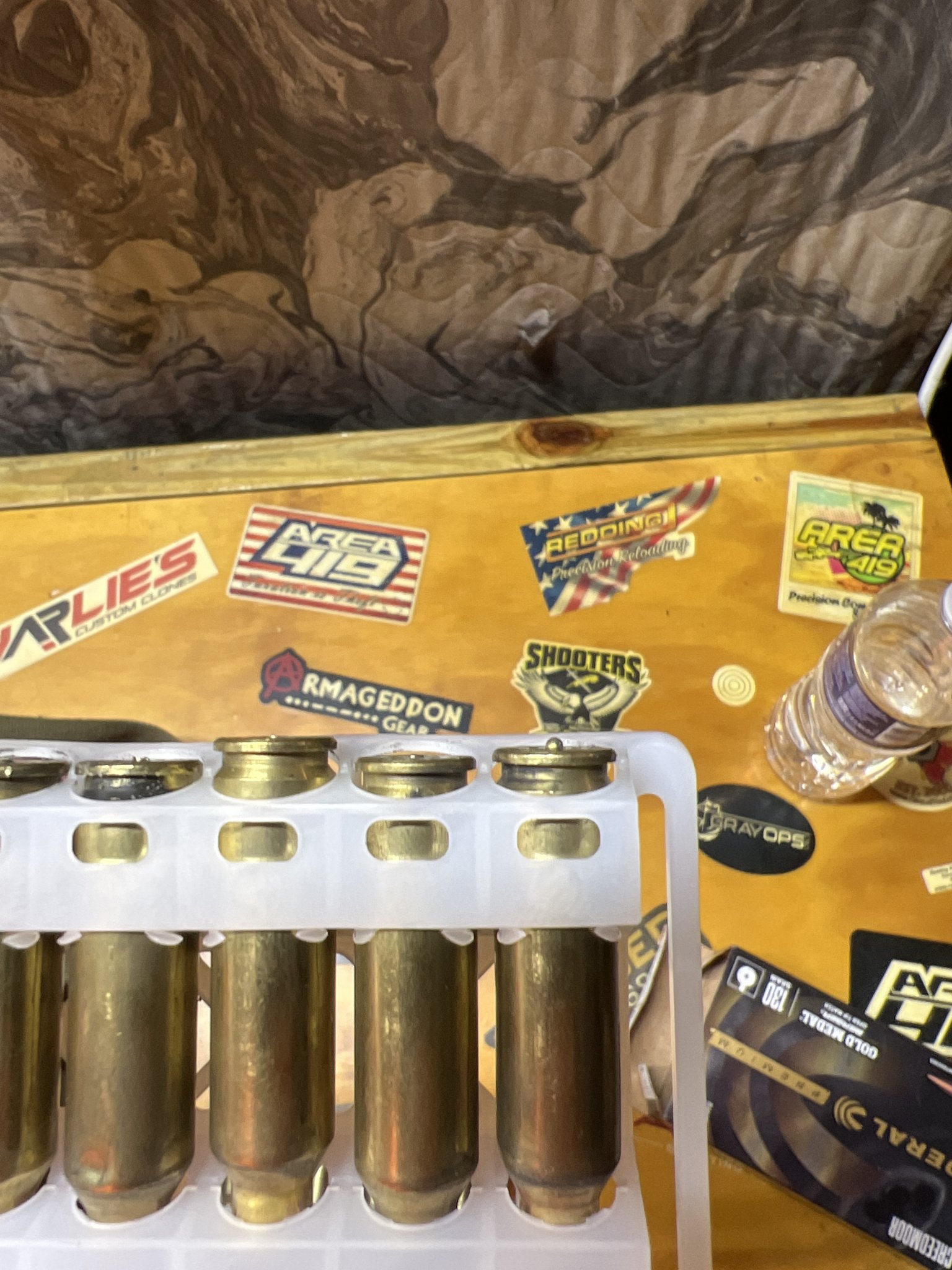

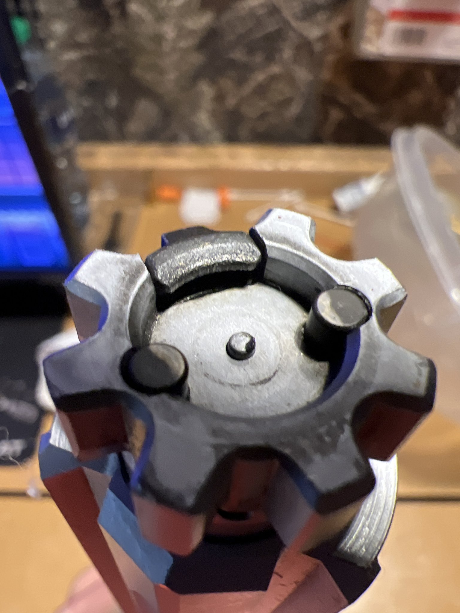

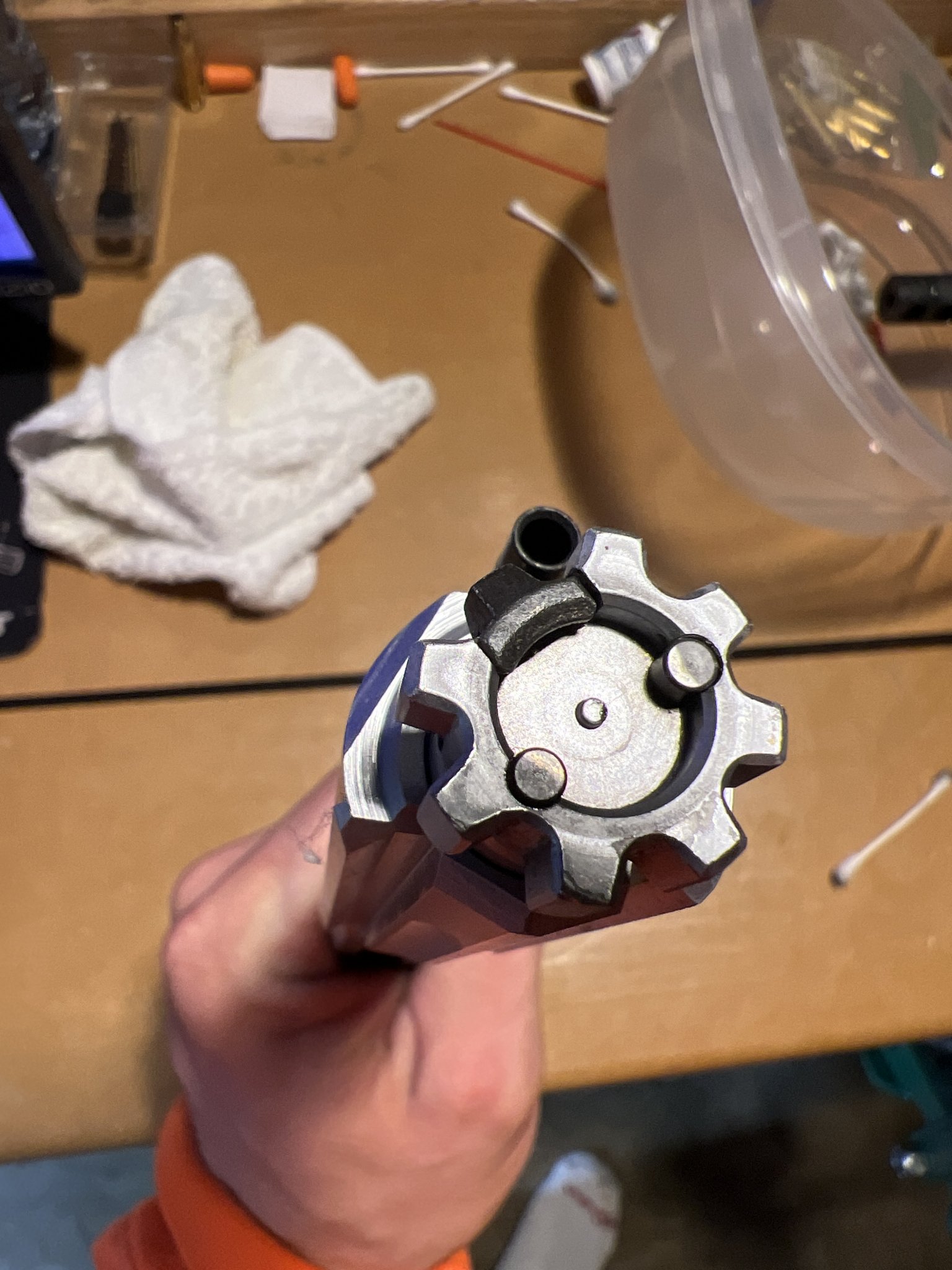

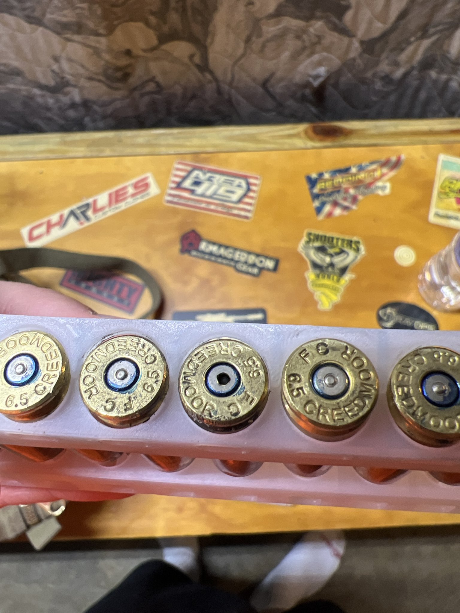

Your primers don’t look flat. The double ejector Lmt bolts don’t seem to show swipes very easily in my experience. Your firing pin tip looks eroded or deformed though, which can cause pierced primers. Was it always that way? Have you chrono’d that ammo?
Reactions: Sm1990
20 inch barrel 2750 with 130s.
Buy a new firing pin.

It’s got a firing pin spring.I did a lil work on the firing pin and shot some today and it looked better. I’m gonna get a new pin
Yeah for the price of a firing pin go new for some piece of mind.
