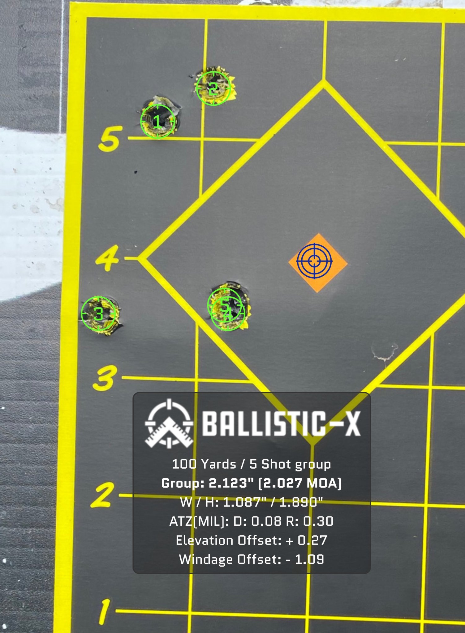

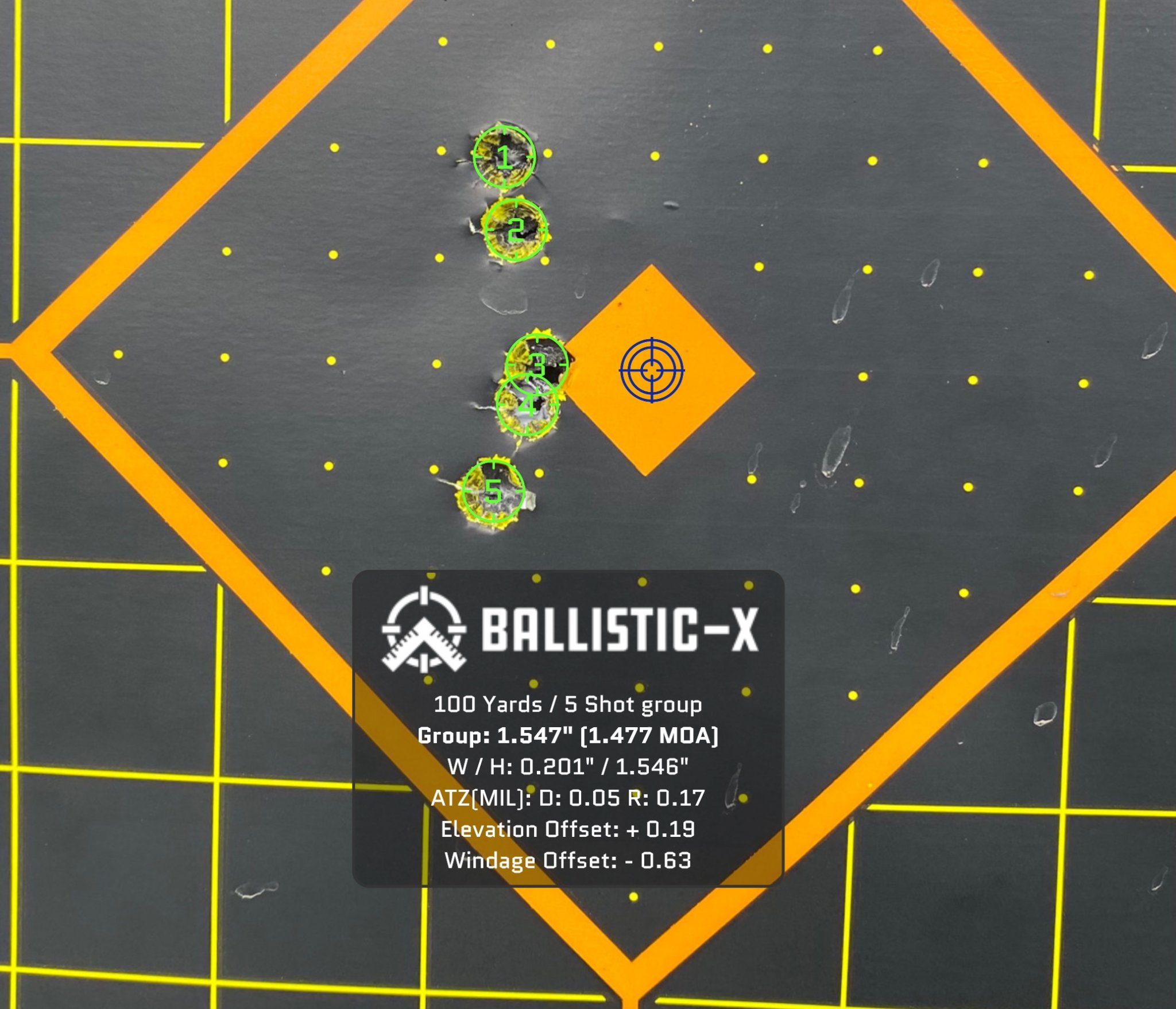

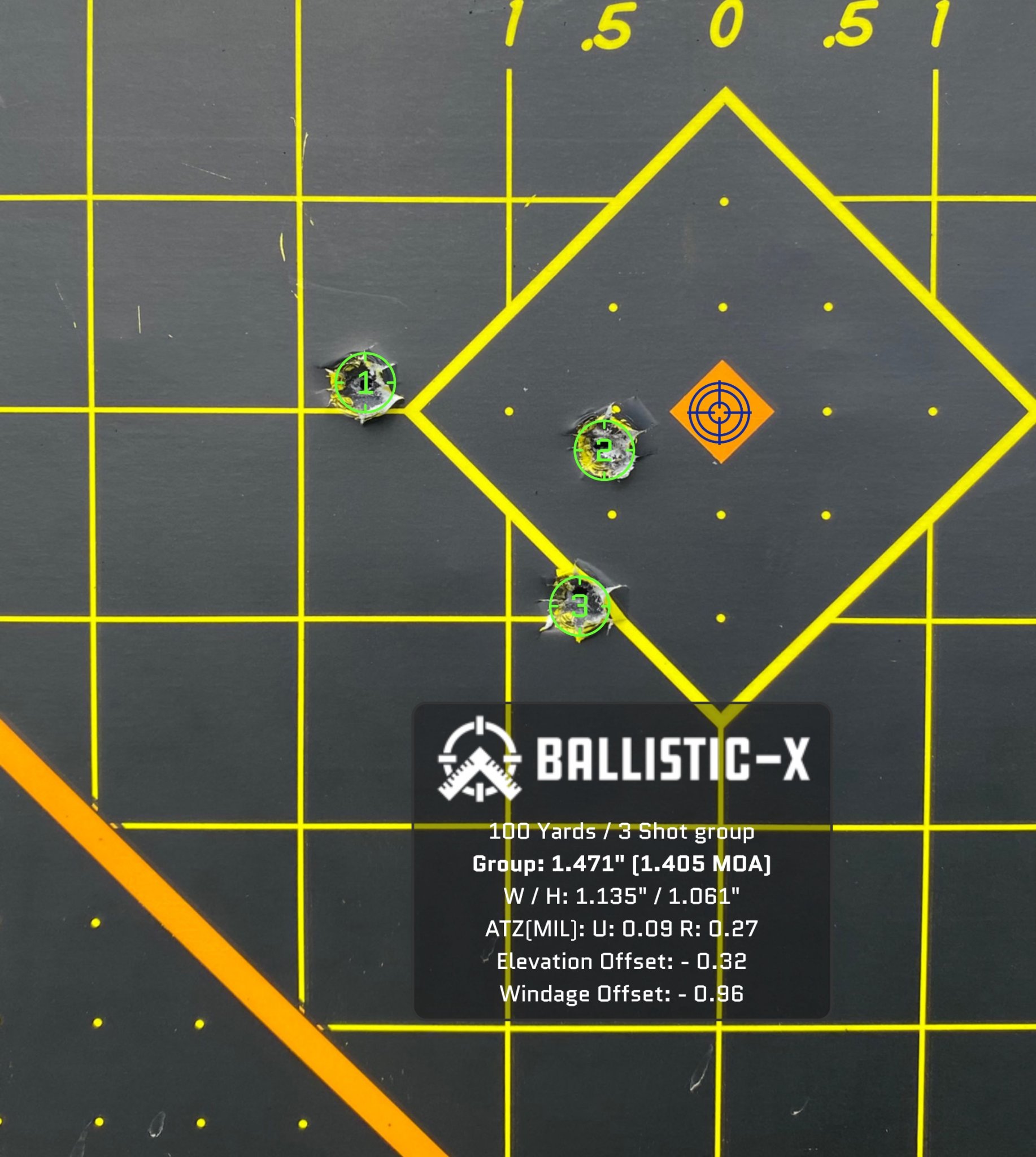

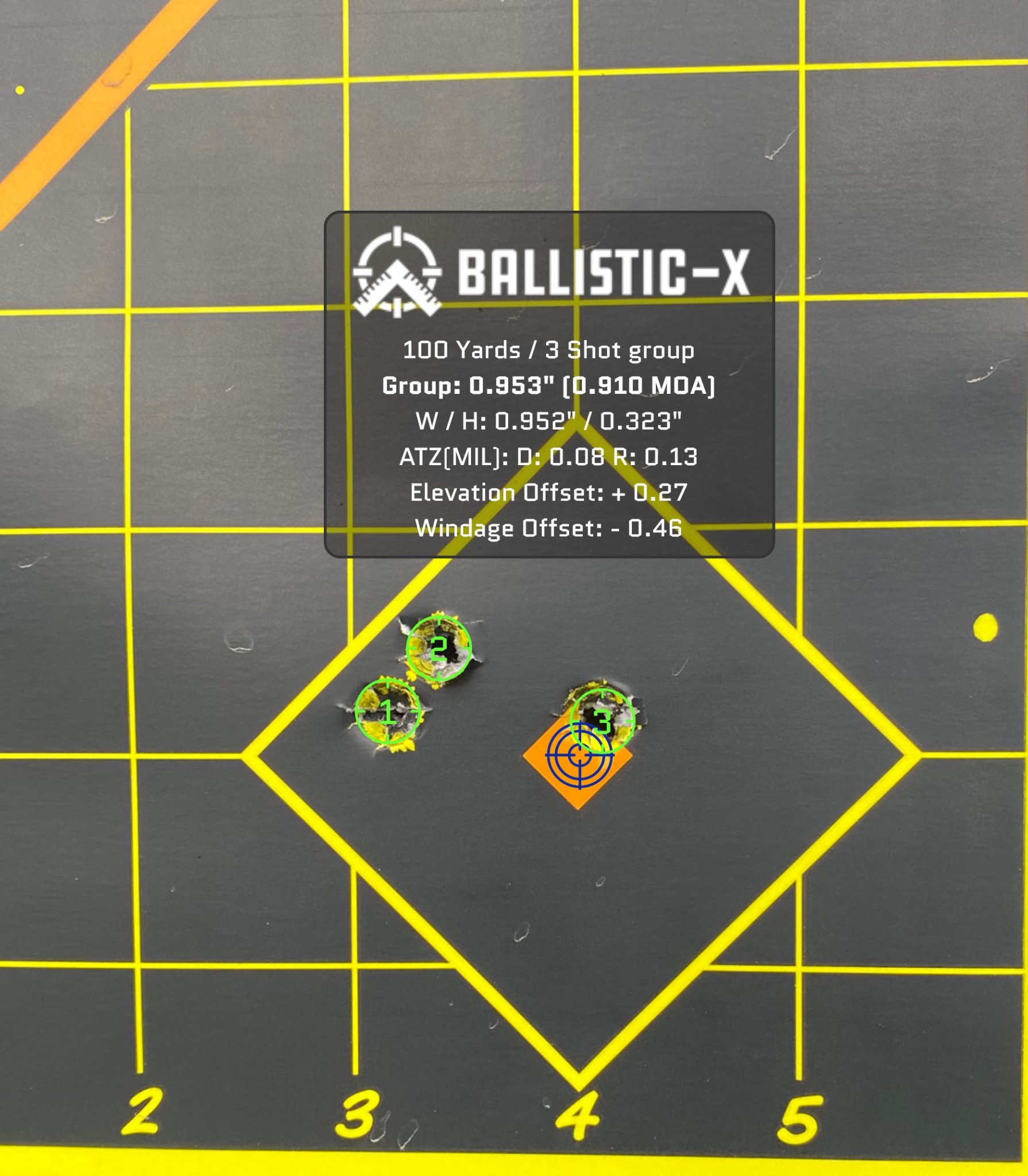

Got out yesterday and shot a few groups with the 13.5. Fired 16 rounds, and had no FTE after removing and installing the barrel per above instructions. Small sample size, but based on past I was getting 1 in 5 FTE. I did not clean or oil BCG at all.
Groups didn’t really change. Was 1-2 MOA with IMI 175 (first 3 pictures) and the last picture is 178 eldx reloads (vertical string). Based on the difference in the groups, seems my vertical stringing is ammo based. Each charge was weighed on m500 scale, and was using new Norma brass with Varget. Need to do a proper OCW test.

Good to hear your FTE problems are gone.
3rd groups can be difficult to judge accuracy. Recommend shooting a couple 5rd control groups with FGMM 168gr and if you can your 175gr IMI before moving on to your reloads so you know what “your” rifle system is capable of.
What’s the average chronograph velocity’s on your groups by bullet weight?
Your 5rd reloaded group could be velocity related however, if shot 1-5 are descending in sequence that could be breathing and/ relaxing your rear bag = breaking the shot on the exhale or not keeping a consistent 2/3 squeeze on the rear bag = your groups settling lower and lower between shot 1-5.
Also recommend using a consistent refined aiming point based on the optic/reticle you have.

I'll pick up a box of 168 and maybe 185 just to try. I think local Cabelas has them in stock. I don't have a chronograph so....😒
The 5 rd reload group wasn't shot in descending order as labelled. Sorry for not being more accurate on that labeling. I don't remember the order other than I think the top 1 was first, and maybe the bottom was 3rd. So basically no consistent pattern.
Scope is an NX8 2.5-20. I'll try using a dot target next time.

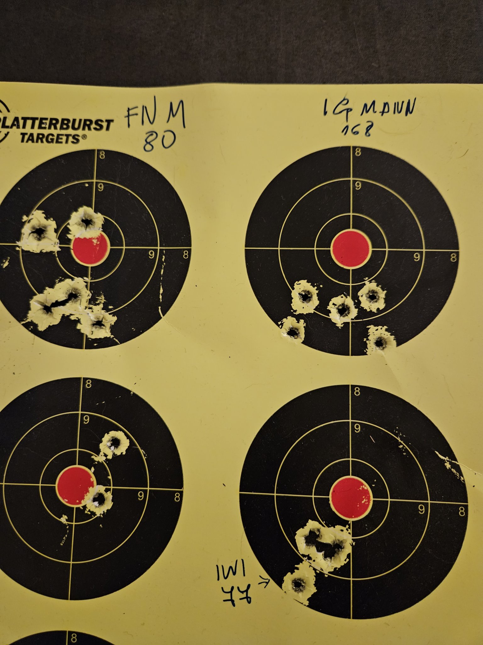

This is from my last range trip - Portuguese delinked M80 (FNM) surplus from 1980 was approx 1.7moa, IGMAN "sniper" 168 around 1.3moa, IWI M80 ~1.6moa. That was again with the same setup - bipod, bag, and a bad shooter with a moderate hangover on that particular day.
