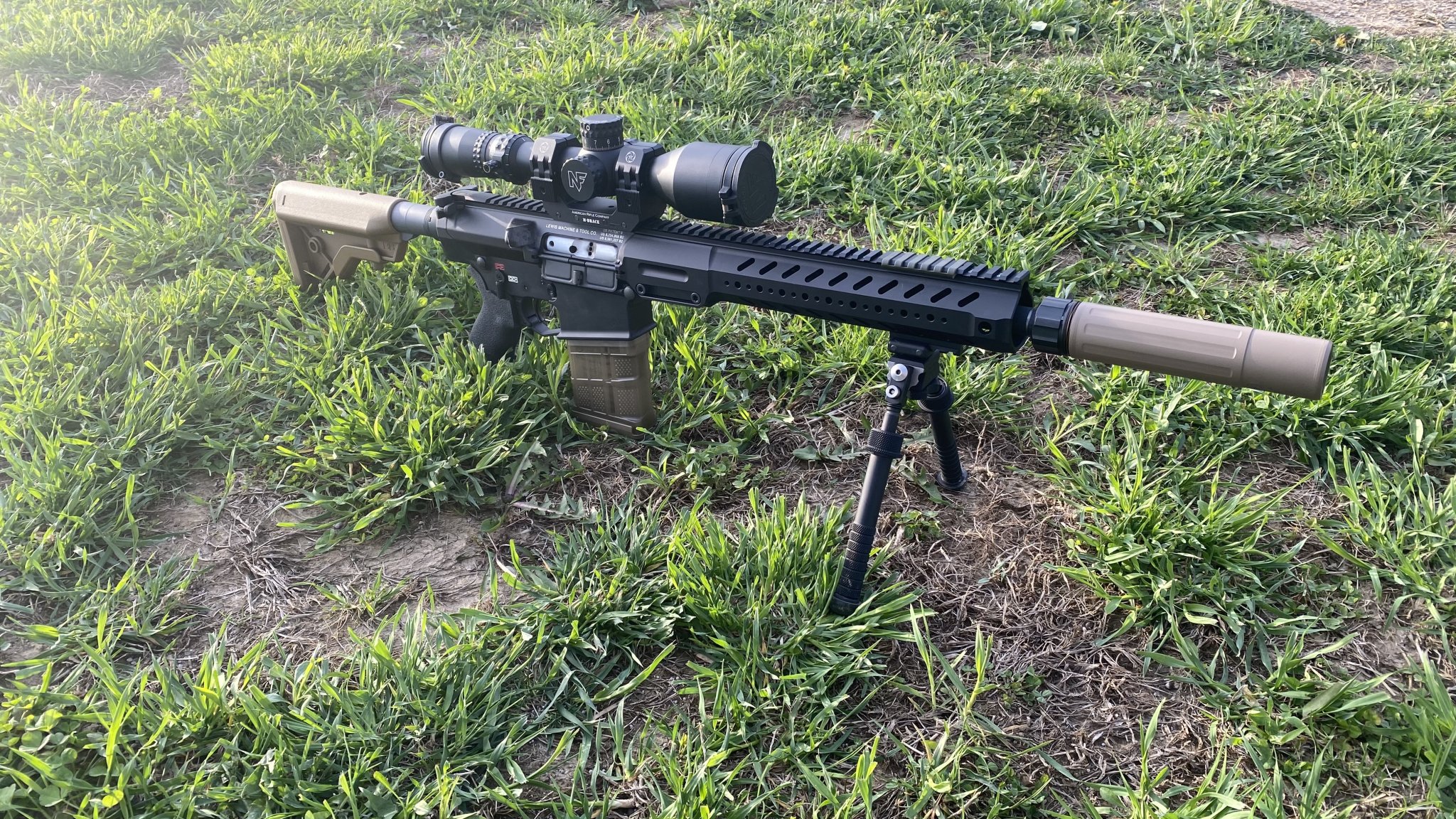

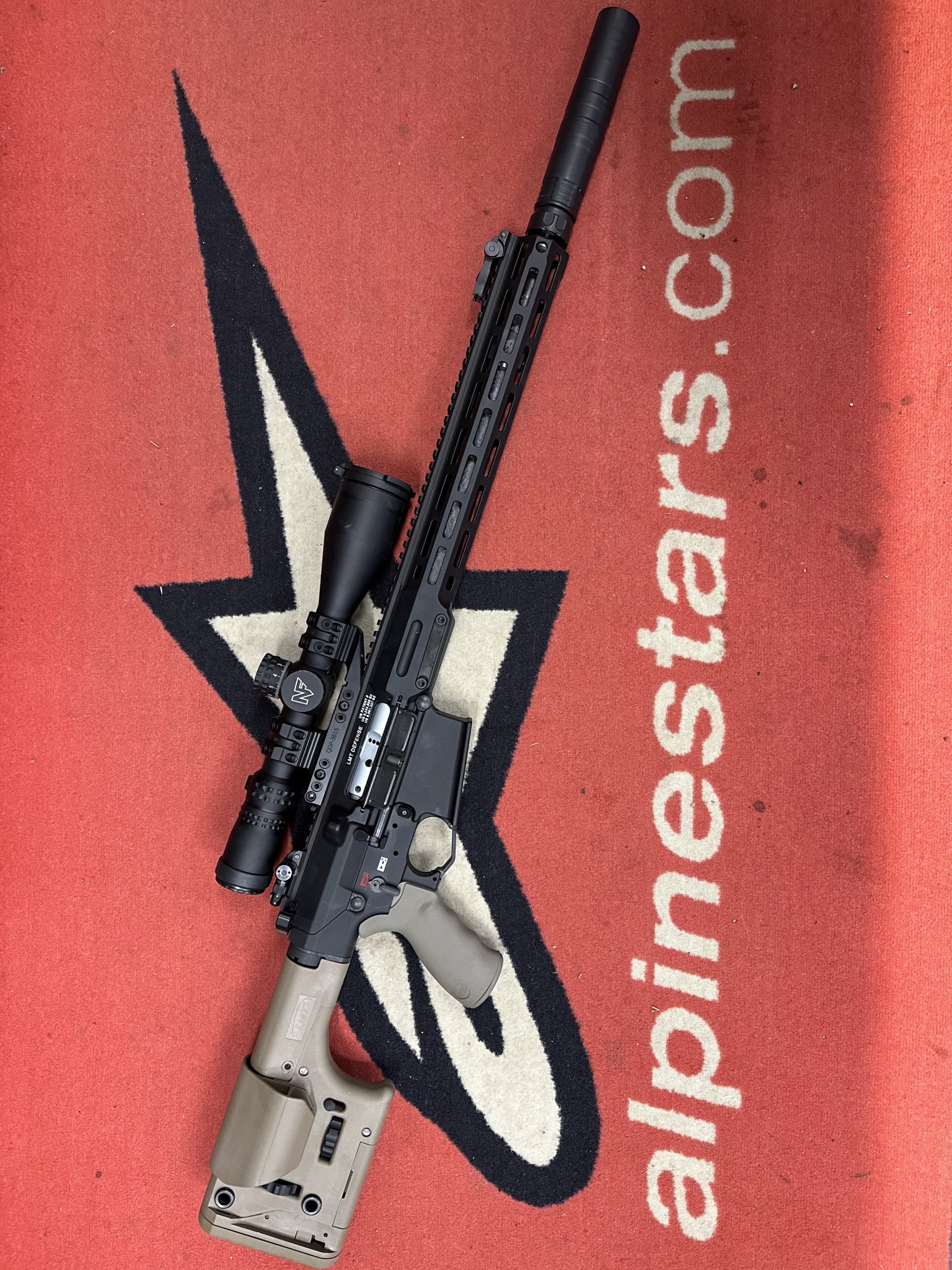

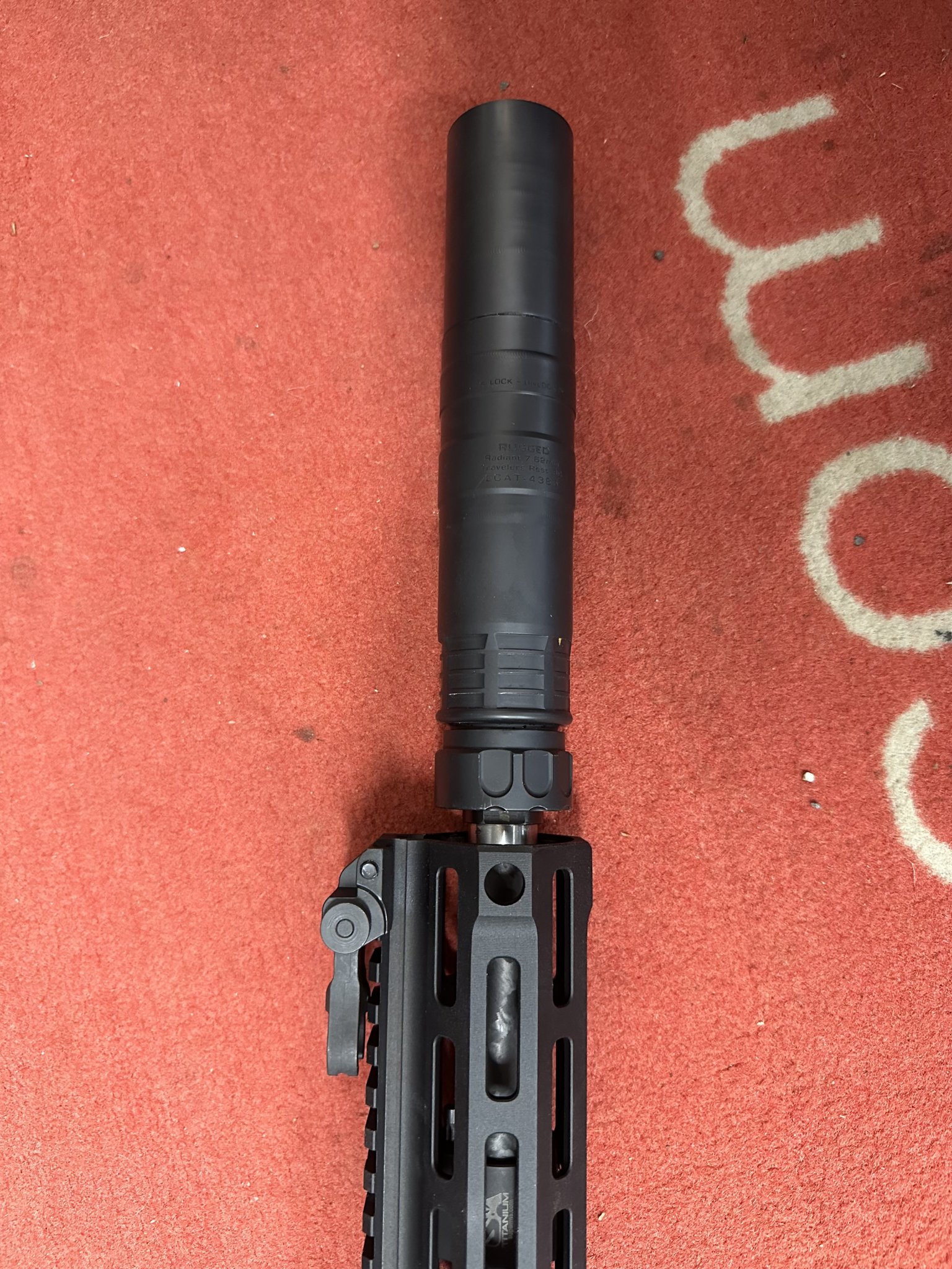

Looking at picking up my first can for my LMT MWS 308. These are the three I'm currently looking at. Any of you have experience with any of them on your LMT's?
Diligent Defense Enticer S
Dead Air Nomad 30
SilencerCo Omega 300
Yes, look at my previous posts and 200 yd groups with the SiCo Omega. It does well, but does increase back pressure. You will have to manage it somehow.
After about ~40+ rds the SilencerCo Omega 300 can on my LMT MWS 20"SS .308 makes the chamber look like a tar pit and started causing reliability issues. Over the last few days I have been reading through this entire thread about adj gas blocks, modified gas tubes ect... to see what others have done to address this.
The obvious answer seems to be a low back pressure can but the 273 day wait for my last can, (200 and counting for my 2nd) lends itself to the adj gas block option. Still reading but that seems to be the leading option so far.
All that aside accuracy with the can has been very good. When I do my job I am at about 1 moa with FGMM. The rifle is fairly new to me and am working on getting better with it.

I bought two Nomad 30's and I am very impressed and I have owned a lot of cans. Its not too big or heavy and its hush hush enough.

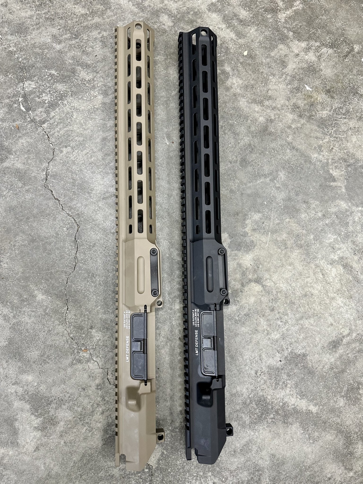

The one in the insta pic definitely isn't from the MRGG trial. @TangoSierra916 is correct in saying that the pictured 15.5" variant with no FA was for the Swiss. This pic shows one of the MRGG submitted uppers (shorter rail, additional milling around barrel extension area, FA):
I have the "Swiss contract version" as pictured in the insta post and am currently building out an SP10 to compare. Really curious to see what I enjoy shooting more. I wish the SP10 handguard had more Mlok slots like the MWS, but I enjoy the natively flat bottom and the main interest was in an overall reduced weight versus the MWS, along with additional barrel compatibility. D Wilson has noted previously that despite additional milling of the handguard, the ultimate cause of weight with the MWS is the proprietary barrel extension which is chunky as fuck.
I might be crucified for saying this in an LMT thread, but it's also nice that the machining and alignment on my Seekins parts look like they were done by a professional machinist, versus the slightly crooked barrel tube on my MWS and rough tooling marks around some edges. No, it doesn't affect function but given the price tag, the attention to detail is appreciated.
@TangoSierra916 I never mentioned MRGG. The MRGG program was killed and no contract awarded. My understanding is the MRGG trials was down to Larue and one other before it was halted.
My reference was to the USASOC procured SP10Ms that are currently in the hands of our warfighters. Seekins beat out KAC, LMT, Larue, and probably some others.
As far as LMT features while the quick change barrel is nice, I no longer view it as a benefit. The barrel extension isn’t readily available making it a PITA to get a custom barrel spun up. Misery custom and DWilson do conversions, but they need a sacrificial barrel for the extension. I think DWilson did a limited run of extensions. This feature for the most part prevents you from being able to go with any other blank mfgs like a Bartlien, Krieger, Proof, or Douglas.
Another feature is a single piece upper with two set screws and clamp for quick change barrels. Barrett has had this same design crack on the MK22’s.
I agree with @overmatch on the machining comment. The LMT MWS MLOK upper I had left a lot to be desired in terms of machining.

The quick change barrel system isn't so quick change for any Mlok uppers FYI. All mounted hardware in Mlok slots has to be removed before there's enough clearance for the barrel to be removed... In my case that includes a picatinny section for tripod, picatinny section for bipod, and picatinny section for laser. Non-issue for those shooting without any attachments, but worth mentioning before someone thinks the barrel is truly 2 bolts away from being swapped.
You need to sand/file down the mlok nuts and backers. I've got a 419 arca rail on the bottom of my MWS and I can switch barrels without having to remove anything.
Great to know. To clarify, besides sanding the (extremely long) screws, you're saying to thin out the actual backing plate as well? If someone came out with "Mlok-Slim" I imagine there would be significant demand.
Just trim the screws so they’re flush with t nut when installed. I’d be hesitant to take much if any off the nuts. What I think could fill a niche is a flat bar that could be inserted from inside the rail for mlock to thread into. If you use the whole mlock slot to clamp it could be quite a bit thinner. Wouldnt necessarily work if you split two slots though.
Confirmed, I had to file a little off the backing plate in addition to the screws.
It was a labor of love. I started by filing the screws flush and then tried to insert/remove the barrel. When that didn't work I simply continued to file down the backing plate and screw until I was able to pull the barrel without having to remove the arca plate. Once I was able to do that, I used some blue loctite on the mlok screw and backing plate, everything has been holding together really well, it's quite sturdy. I had to remove more from the backing plate close to the barrel extension and virtually nothing from the backing plate close to the barrel.
@Thorbeast confirmed as well - when I tried sanding just the screws, the Mlok backers were still too protruding to allow for barrel clearance. Interesting idea for a flat continuing bar.
